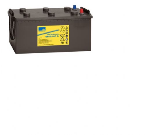

Hey all.
I was lucky to be given a dozen old Sonnenschein solar block 12V 100 AH deep cycle gell batteries. They've been sitting in storage for about three years and are all in various states of charge ranging form 12v to dead flat. I know nothing about gell batteries so I was wondering if someone could tell me whats involved in the way of care,maintenance and charging.

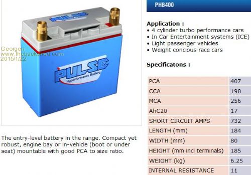

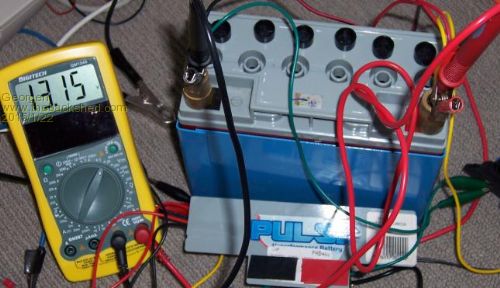

Joined: 13/09/2011
Posts: 462
Posted: 04:42pm 21 Jan 2015
Little picture from pamphlet
And after breaking in and gradually topping up with water
George

Doug
Joined: 11/05/2010
Posts: 41
Posted: 07:51pm 21 Jan 2015
Thanks for that gentlemen. Heres a pic of the batteries I have. Under the round caps is a screw in plug. And yes the gell doesnt look like gell anymore. It looks more like lumps of ice so ill try slowly adding water to try and re hydrate it. Ive actually had one driving a 12v water pump watering my veggie garden for about a week now. The pump draws about 7 amps and runs for about 20 min every night and the battery is topped up by a 10 watt solar cell each day. All appears to be going as expected. Ill get the rest out of storage shortly and start sorting them out. I have a 6 amp charger and also a diesel ute with an 80 amp alternator if I need a bit more oomph, ha ah. Thank you once again.
