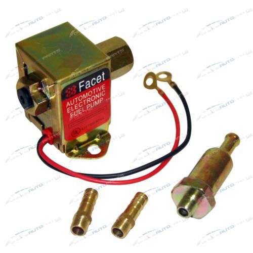

I am looking to drive a facet solid state fuel pump at zero pressure and maybe 5% of its maximum flow.

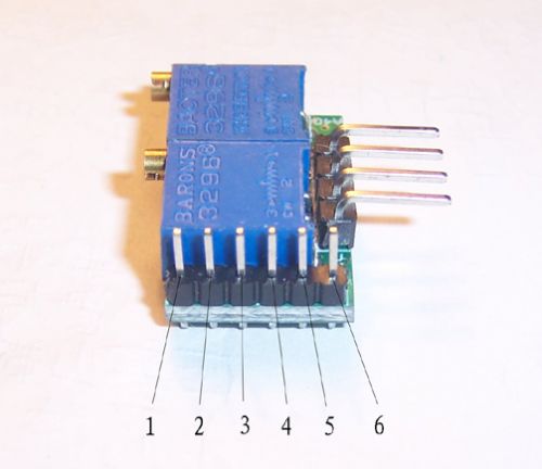

the solution I have come up with is a repeat cycle timer something like this one from bellevue
this will give me a time down to 0.2 seconds and up to 45 seconds for both T1 and T2.
I am using it to squirt pulses of fuel into a combustion chamber to run a furnace and perhaps a heater in the future.
Eventually I would like to adjust the off time (or both on and off time) with some output from a thermocouple or temperature controller. I am just wondering if that is possible?

That repeat cycle timer looks like it is adjustable only by the screw settings. If that's the case then it doesn't give you much capability of modifying the cycle based on external sensing.

Thanks BobD, yes the cycle timer is adjusted with two trimpots, I am only looking at using this for prototyping the control system and fully manual operation.

Don't know specifically about your Facet fuel pump but they are generally used to pump fuel with low viscosity, high pressure, and a constant flow rate. They bleed the surplus fuel not used by the injectors, back to the fuel tank via a constant pressure valve. Pumps of this type may not work too well at low pressures and higher viscosities (speculative thoughts).
A geared oil pump could do the job. I would use a bleed, back to the tank, downstream of the pump just to keep a bit of oil flowing through the pump and then use an injector solenoid, under microprocessor control, to feed the furnace.

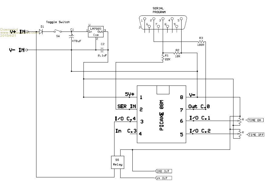

For example to how simple it is to create a short on time for the pump followed by a longer off time using a 8 pin picaxe chip.
This would use 2 x 10K pots configured as voltage dividers to adjust the times, one for "on time" of between 0-1024 milliseconds (up to 17 seconds) and another pot to adjust the "off time" in seconds from 0-1024 seconds.
With a solid state relay to do the switching for the pump on/off.
The basic code required would be something like this.
#picaxe 08m2
symbol time_on = w0
symbol Time_off = w1
symbol adc_on = C,1
symbol adc_off = C.2
symbol SS_Relay = C.4
Main:
readadc10 adc_on, time_on
readadc10 adc_off, time_off
high SS_Relay
pause time_on
low SS_Relay
wait time_off
goto main
This would run the pump for what time frame was set for time on and then wait the set time off period before repeating the time on function again.
All for about $10.00 in parts.
Edit... To add schematic
Pete.Edited by Downwind 2015-04-22
