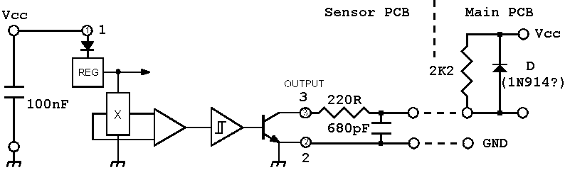

Anyone been successful in digging up a datasheet for any of the Hall Effect Sensor IC's used in the F&P stator?
So far have tried to locate a datasheet for two sensors used without any joy.
From what I can see, the circuit shown in the graphic would be close to correct, bit unsure of the Capacitors values but it's the best I can do with what's available.
