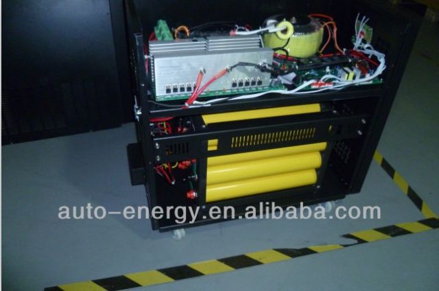

Hi Chronic, you really need to watch a big bank in action to appreciate what low resistance means, charging a 400Ah bank at 1C it will still be taking 400 amps at 99% full and 50-250 amps at 99.5% full if you let it and the cell variation is usually TIGHT more like 0.05% to 0.2%. The big dogs (1000Ah cells) are a factor of 10 better again.
I think I mentioned that on the LFP demo unit I set up a couple of years ago we have now balanced the bank a grand total of three times.
I checked the voltages last month while they were floating @ 3.3375 and there is a variation of 0.009 volts, the variation would be a lot higher @ 3.6 volts but we never get there as we charge to 3.4875 volts and cut to float after 15 seconds?? (i cant remember the exact time setting).
Whichever way I slice it, that is going to be less than 1-3 watt variation per cell on a 10 Kw bank after 9 months of cycling with no balancing. its not much
if I had built a 38 x 80Ah cell bank on a budget instead of 8 x 400Ah I would expect a lot more variation.
In my dream scenario I would let it run and datalog right at the end of the charge cycle, when the highest cell is say 0.03 volts above the pack average @ 3.4850 volts then I would perform a manual balance.

A bank made from 1000Ah cells wont get off the couch for less than 5C discharge
Just use some Panasonic 18650's
