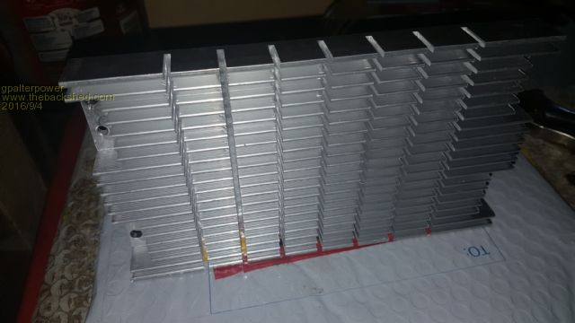

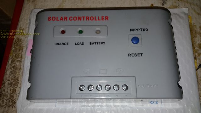

I partially live off grid. Started off small, with a 1kw solar array and a small battery bank. I was looking for a cheap solar controller and came across this on..... where else but Ebay.
It looked good with fairly sturdy construction and had what I thought a decent heat sink. The price was right too! Rated at 60 A was well above the possible 40A output from my panels. It worked well even though it was getting hot, but with a small fan behind drawing air thru the fins soon fixed that problem and was running cool as a cucumber. So impressed I was that with another 1kw of panels decided to go back to ebay and purchase another. After hooking it up I was happy that my batteries were being looked after.

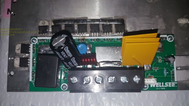

With yet another 1kw of solar it was time to go shopping again. Same place. The item arrived 3 days later from their Sydney depot and proceeded to wire it to my latest array. This is where it all went pear shaped. The moment I hooked it up and came on line I realised that it was not regulating. Even if I took away the B+ sense wire the controller just kept on going... like it was shorted out. On to ebay to try and sort thing out with the supplier. To cut a long story really short and after many many emails and promised replacements I gave up. By then it was too late to open a dispute in the resolution centre.

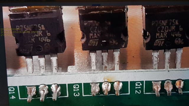

So I decided to pull it apart and check inside.. this is what I found

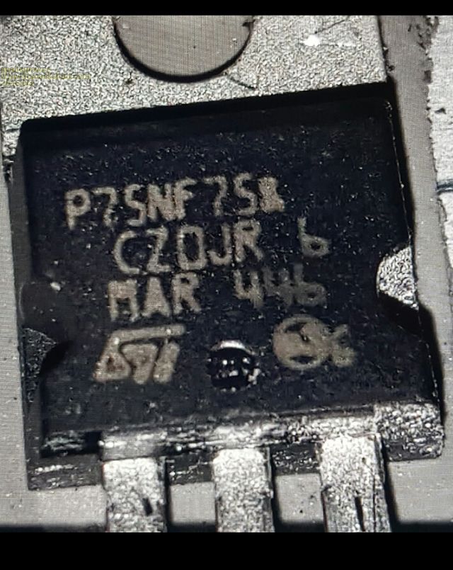

I noticed the connections on Q13 had been hot just a little. Hard to tell from the pic but had that slightly melted look on the connections. So I unsoldered it and with a multimeter checked the culprit. Sure enough it was shorted out. I'm hoping that if I can replace the FETs then there is a good chance that the thing might work. Can any one tell me if there is something that can replace the burnt out item?

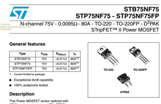

I use lots of irfb4110 which are 120a 100v .004-.006R
That one is is 75v 80a .009R
The solar controller I built uses 9x4110, and comfortable runs 110amps at 50v.. runs dead cold, but is inside an inspire box and uses the main heat sink so not surprised either.

So I guess that the irfb4110 are a direct substitute for the STP75NF75. I can get either from ebay for a similar price. So would it matter if some were different or are they happy to live side by side?

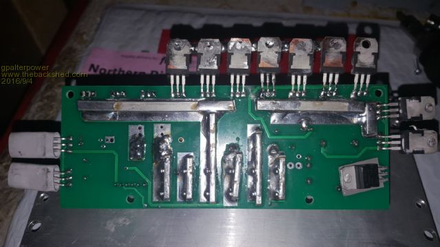

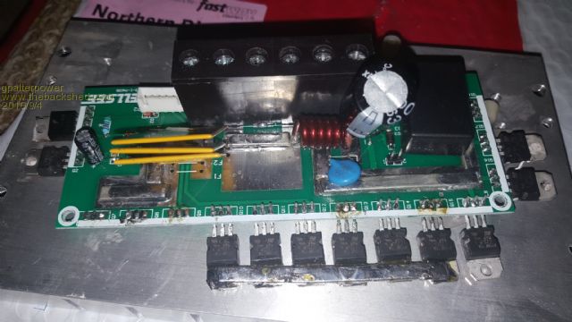

Here are a few pics of the internals of the controller for you to gander at. Marcus
The substantial heat sink
The flip side
Note there are 3 fets missing from the board. I removed them as I believe they were for the auxiliary load section of the controller and weren't being used so transferred them with the burnt ones to see if that would fix the problem...but it didn't. So maybe I have more issues or maybe I should just replace all of them and see what happens. Cant hurt and the parts are cheap.

Thanks Marcus.
Thats a tiny coil to store power in, unless the frequency is crazy high... but I have little ( no) experience with buck converters.
Have you measured the input amps and the output amps to see if you do any better than unity?

There are quite a few of those cheap charge controllers flogged off as MPPT but there really PWM.
Posted: 12:10am 04 Sep 2016
  Madness said   There are quite a few of those cheap charge controllers flogged off as MPPT but there really PWM.
I'll second that.
Especially when I spotted the name "wellsee" above.
I bought one of the "Wellsee" MPPT controllers for my boat. When testing it, current in always equaled current out, so mine did not MPPT despite it saying so on the case.
And yes, I did use a solar panel with >21V open circuit voltage (12V battery).

I must admit that when I saw MMPT stamped on the side I was a bit jubious whether it was true or not. Especially for $65. But I thought it was worth the punt anyway. In saying that the first 2 have been going great every day for the past year or so. If I can get this one resurrected then I'll be happy.
Checked the input A vs output A this morning. Exactly the same going in as out.

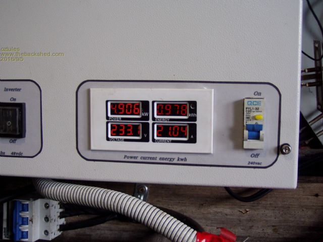

The oztules controller is stupid simple, (as you would expect), and is really only a fan controller type comparator on steroids..... so simple simple.... but sometimes simple works too.
Like this ozinverter I finished yesterday having it's burn in.
Sometimes it just works.....
That one has the clockman boards in it... seems to hold 32C @ 2.6kw for hours on end with 17C environment.... will be interested how it performs under all conditions.

Technically, yes it makes a difference if you mix fets. The capacitance may be different and a host of other things like oxide thickness, channel size and surface area etc..... so an EE will have a fit.
In practice at the low speeds we are probably using in that thing, I doubt it will make any real difference..... and the 4110 can take 300 amp surge ... so if it triggers nano seconds earlier, I doubt you will know .... particularly with it hanging on the end of solar panels without large cap banks to store energy... ie it will only see 60 amps at best if it does trigger first.
Big cap banks and batteries would stress things a lot more, .... I have never experienced a problem with a bit of mix and match if you keep them in the same ball park but I expect some folks have.

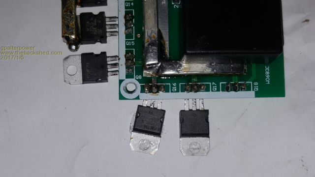

Well I noticed the other day that my power output was down from the usual. So upon investigation I realised that one controller had just shut down. No lights, no one home, no power! Its the one which controls 2 x 1kw arrays...One facing east and the other west.
I removed it from its mounting and took off the front cover. Everything looked ok at first glance but thur the magnifying glass showed a different story. The printed circuit board was o/c to Q15,16, & 17 one being really hot. Its no surprise as this 60A controller has been working hard being fed by the 2 arrays. In the winter and spring it wasnt an issue but now the summer sun strikes directly on to it and by midday its directly averhead. Must be pumping in 70a on good days!
So I replaced all the fets, reassembled it and hooked it back up. Lights came on. It worked. Yay!! I watched as the voltage climbed above 27.....27.1,...27.2... bla bla bla. By 28v I knew I had a problem. No regulation. Not wanting to spend any more time or parts repairing a broken controller that worth $60. And I dont want to purchase another as the regulation voltage was never stable, I was wondering if any one has a simple circuit diagram of a PWM controller, say up to 80A, 24v, that is robust that I can be built. Marcus

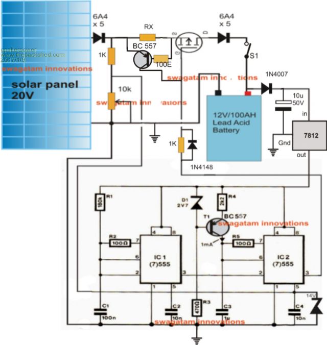

If you google charge control circuit there are a few circuits that Swagatam designed,
all you have to do is add some more mosfets to them so that the circuit can handle more amps.I'm going to be using his 48volt circuit but haven't had time to mod the circuit.
Hope this helps you.

I checked out Swagatams site. plenty of projects there including many solar controllers. Most are the MPPT 12v type with just a single FET.(would have prefered a PWM as I believe they are simpler) I picked this one out. How would I go about increasing the number of fets within the circuit for an 80 amp controller and what changes do I need to make for a 24v system? Or, can you suggest an alternative.

Just replace the mosfet thats there now with 3 sets of 3 in parallel, if you check the
mosfets data sheet it should show you how you parallel the fets,
One other thing the two top diodes are actually 5 each in parallel, just in case you didn't see that.
And I'm pretty sure thats all you have to change with this circuit.
