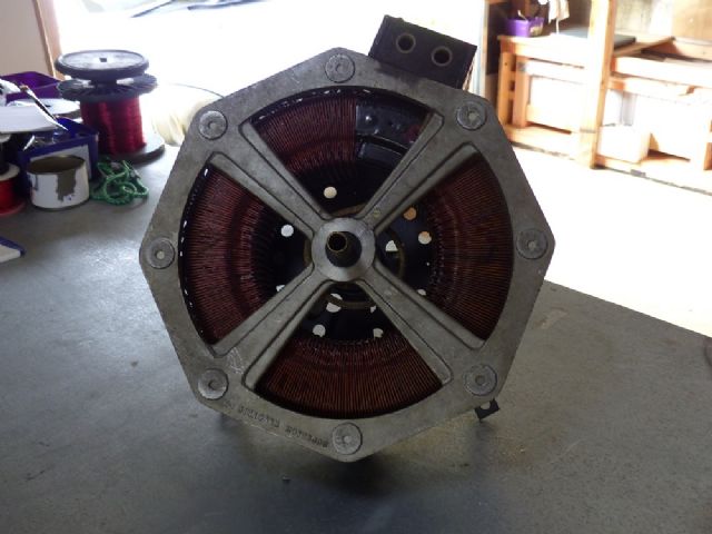

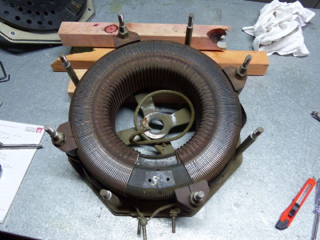

Have managed to locate an old variac to use as a potential inverter core, I pulled it apart to the point where valid measurements of core size and windings count, if its no good then it can be re-assembled and put to use as a variac again.

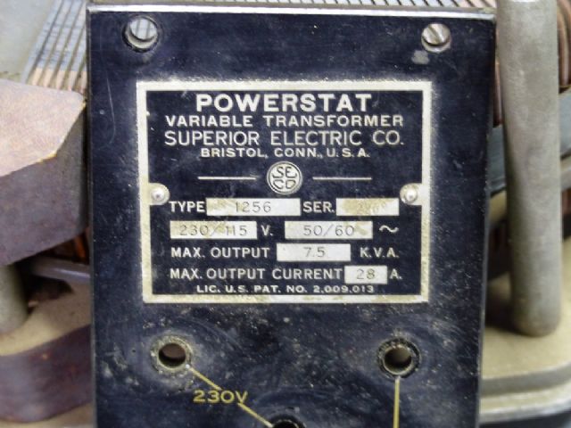

Variac transformer:
230 vac input 0 to 270vac output @ 28amps, 7500VA
Overall width 3000mm dia
lamination Ring = 60 * 60mm = 3600 mm^2
Centre Hole = 160mm dia including existing primary
Existing 230v winding = 230 turns 12g wire, 3.3mm^2 and exactly 1 turn/volt
I note this does not match the turns calc that Oztules has outlined where mm^2/2800 is used to get the volts\turn, if I use this the secondary works out 3600/2800 = 1.285, so for 230 volts = 230/1.285 = 179 turns rather than whats there now 230t. It seems the designers of this variac are being very conservative and using a low flux density thus the higher number turns, that 28 amp rating is continuous according to the spec.
Should I use the 179t in the calcs below or stay with whats existing, Its easy to unwind wire...

Back to that variac core, after powering it up with a 2KW jug in series with the existing primary the input current was very high, added some extra turns and graphed the results, very interesting... Looks like for 240 volts 320 turns are required for a current of 600ma, not sure what it should be, the thing weights about 24kg.
oztules
Joined: 26/07/2007
Posts: 1686
Posted: 11:15am 30 Sep 2016
Thats just all wrong.... idling current in original mode is over 500w.... the steel cannot be any where near that bad... I think it must have some shorted turns in there somewhere, the figures are very very poor... and it looks like it was designed and built for better results than that..... something is afoot..... just wrong.
You have 100 turn on there that are known to be sound, but even driving it with say 100v from elsewhere will still be bad, as the wiring in the original seems to be ... well suspect.
Perhaps check the winding for consistency ( very hard to do I suspect), or bite the bullet and strip and start again... I just find it impossible to believe that it should draw over half a kilowatt just to idle in it's original guise.

The turns are all exposed as per the original photo, just a single layer, no obvious shorts anywhere, as you say something seems very wrong, I wasnt going to use the original anyway as would prefer to wind parallel strands of fresh wire of bigger area, so will strip them off and quickly wind on a single strand of thin wire and repeat the test.
Posted: 11:11pm 30 Sep 2016
If it was mine then I would just wind on 10 turns of any odd piece of wire on top what's there.
Then power it up, ignoring the high idle current (as long it does not blow the fuse .
Then measure the AC voltage on that 10 turns and use that result to get your turns ratio.
Then strip the old wire (which most likely has wiper brush residue between the exposed parts of the winding) and wind on your calculated turns for your chosen mains voltage.

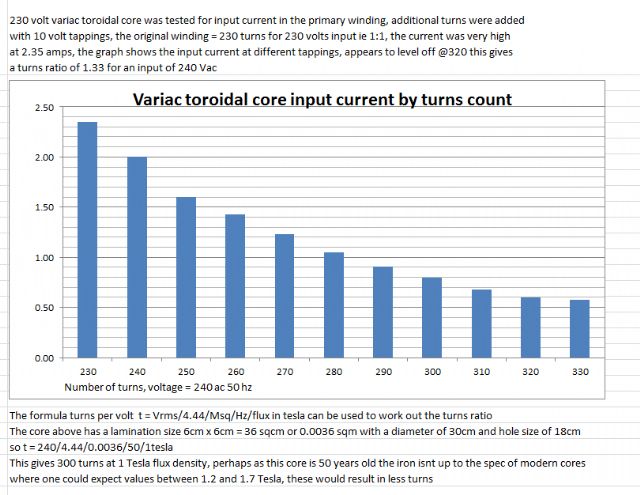

Posted: 11:56pm 30 Sep 2016

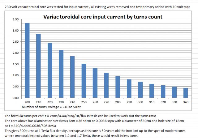

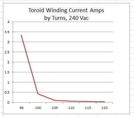

I have stripped off the old wire, was wound 1:1 ie 1 turn per volt, this maps to the one volt graduations on the dial, it did have a bit of gunk where the carbon brush tracked. Apply mains volts to it and a ten turn winding gives 10 volts as expected.
However after cleaning it all up, putting a temp layer of masking tape for insulation, then winding a tapped test winding to measure the currents at various ratios the graph is almost identical, so obviously the steel is either a lower quality or because of the large magnetic path and big 18cm centre hole the losses are higher.
Looks like if I use a 1.4 turns per volt the losses are lowest.

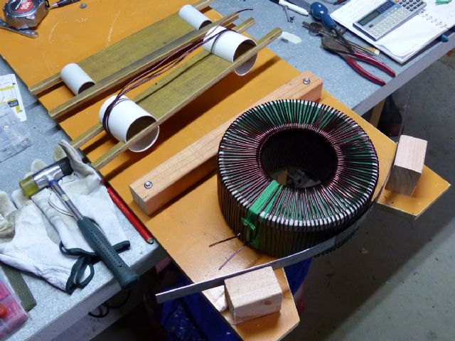

My build continues...
Have decided to not use the old core for now as its too lossey, approx 350 turns would be required on the 240ac side to be efficient and will require more wire than I currently have; so have purchased a new modern core from the manufacture in Christchurch, 240mm dia x 120mm hole x 100mm height, they annealed it after forming the core at 700 odd degrees and coated it in a high temp plastic.
Its magnetic properties are so much better than the old one, wound a quick 150 turn 0.5mm test winding and ran a turns\volt saturation test at various tappings to see what the magnetising currents are, see graph, only draws 30mm at 120 turns, 240 Vac, so 2 volts per turn seems about right.
Decided to use 3 in hand of 2.36mm wire for the 240vac winding, stuff is quite hard to wind on, used a shuttle with pieces of plastic pipe as formers to lessen any sharp bends, 3rd hand is required to hold the previous wire in place, used a springy stainless ruler as a bendy clip, works quite well; photo shows first layer.

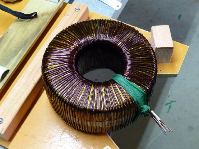

Here's the core after the 3 in hand of 2.36mm secondary and light epoxy\kapton on each layer; 13.12 mm2 total. Hole in the middle will be 90mm after a good cover of mylar; using that Kapton tape as its way cheaper than the no adhesive mylar obtained in NZ. Will be a struggle to wind the 50v primary, 10x3mm flat wire, see how it goes...
My hats off to others that manage double or triple cores, its hard work.
Mike
