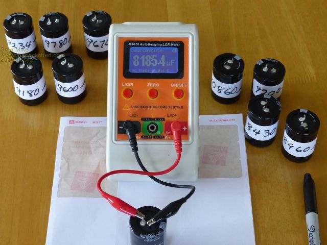

I read somehere on the forum that others were having issues with the OzInverter 10,000uf 100 volt capacitors being very leaky.
I purchased mine from This AliExpress Store ,of the 10 in the order, 6 of them have excessive current draw when the voltage goes above approx 70 volts. I have placed one is series with a 10k resistor and a 95 volt supply to limit the leakage current, will leave it in this state for a day or so to see if it reformats its internal oxide coatings. Fingers crossed.

Well after leaving overnight one cap connected to the 95v supply via 10k resistor, the voltage across it this morning was 75 volts, went up a volt or so thats all.
Retested them all again this morning, set current limit on the supply to 15ma and 95 volts, so they couldnt blow up.
Four reached full voltage over a minute with no leakage, the rest zipped up to 70 odd volts over a minute then sat there drawing 15ma current, the voltage wouldnt go any higher. If I had connected up without the current limit set no doubt they would have shorted out at the 70 volt mark due to excessive internal heating.
Discharged them all using a 5 ohm resistor then shorted for a minute and tested on a capacitor tester, see photo,
Results in uf:
8185
8430
8960
9180
9200
9234
9600
9670
9780
10860
So only one > 10,000uf and that was one that is leaky above 70 volts, four definitely are low.
Basically none of them are any good, measuring other old computer power supply caps they nearly all exceed their marked values.
The inverter runs up to 56 volts on my system, so guess they arent leaky at that voltage, but they are all lower value than spec, could use the top six possibly.... How critical is the total = 60,000uf, my guess is even 60k is a little low for high current surges. Other professional inverters I have worked on in the past would use > 100K uf here.
Grogster, if you want I can test yours for you if you dont have a tester, PM me.

The Caps are there to smooth out the ripple caused by switching at 100HZ (counting both sides of the sine wave). They are not intended to provide surge current, having sufficient size cable etc will take the load off the capacitors as far as I know.

We are getting a little bit precious about this folks.
Rated capacitance is very liberal for electrolytic caps.
Series E3 caps have a tolerance of +-20% ( stamped "M" )
Series E6 caps are +-20% ... marked "M" again,
and the expensive E12 series are rated +-10% coded as "K"
tolerance specs from IEC 60062
So all the measured caps are within tolerance... so would not bother with the dispute process for uf measurement.
Providing they don't explode at 65v and less, they are just fine for this project.
I use the $4 ones, and they stay cool at power levels below 4kw with my leads, they are also cooled by the fans when the heat sinks exceed 32C, so never get above that I suspect... short 10kw excursions will not cause any problem, as this will only last for seconds or less.
In short... I would not lose any sleep at all over it.

Point taken yes they are in 20% tolerance, they might explode at 75 volts, I will just use the best six.

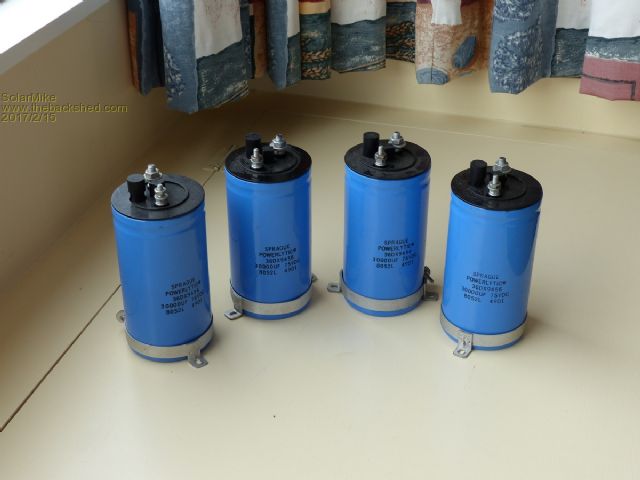

I am re-designing my inverter to use more modular H-Bridge sections with the mosfets bolted direct to 25mm x 25mm sq aluminium bars, a small cct board sandwiched between another bar that the sources bolt to. The small cct board will contain the TC4452 driver for each module.
Four modules are used to make one H-Bridge, the drain connected bars are bolted via a thin mylar film sheet to the flat heatsink base. Similar in principle to the Large Power IXFN360 Mosfet modules that others are looking at, I'm using IRFP4468 devices for very low RDS(on), 4 in parallel per module.
Modules will be linked via 50mm sq flex cable and crimped connectors bolted to each allow bar.
This allows me to use quality screw terminal caps for the supply, I really dont like those PCB mounted ones, the cheap chinese ones are rubbish really, their ESR is quite high, so have sourced some old UPS screw terminal 30,000uf 75volt from Casa Modular Systems, they will be ok for a trial and should keep the supply ripple down.
A plug for Casa here, they have a good range of second hand screw terminal caps all sorts of voltages and prices are good.
