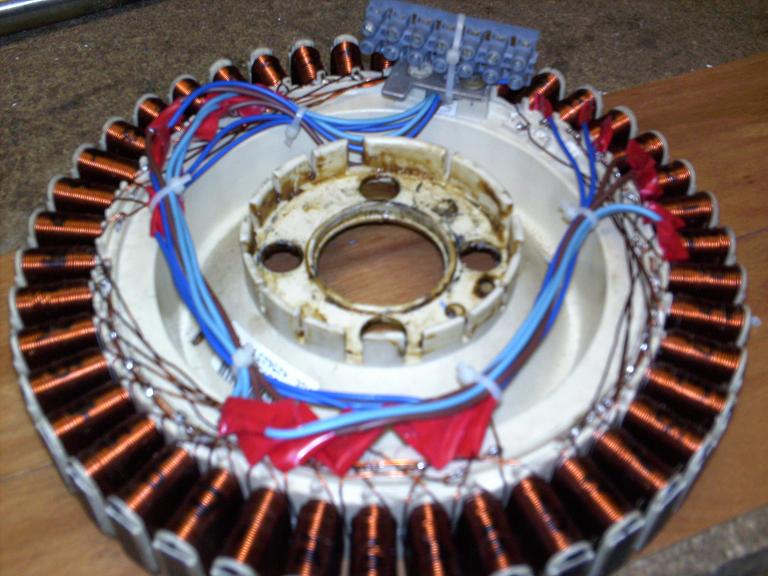

Hey everyone,great to read all the threads, and know there is so many people interested in building these mills. They are beautiful things. But as it is is my first round, I seem to have a problem with my mill. I have setup in my small block in the Burbs, a 7p2p 7 Phase mill, (the best all rounder), probably not high enough off of the ground. I don't get a lot of wind here,but I do get gusty burst, for a few days, even up to a week at a time. So maybe I should of gone for the 48Volt system. Please advise.
I have rectified the voltage on the mill, and drive the DC volts down to my Oatley K241 regulator, into a Dicky Smith, 20 Amps panel display, voltmeter, and then into the Battery. My problem is, when my mill hits 12.4 volts (or anything above the actual battery voltage), the ammeter only starts to flicker, and the mill then dies slowly. Maybe I don't have enough wind to push it past here, I dont know. The biggest I have seen on the Ammeter is about 3 amps, and only for a second.javascript:AddSmileyIcon('')
I am sure someone has had this experience before ?

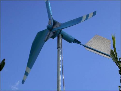

Posted: 04:25am 10 Feb 2008
The mill is the 7 Phase, 2 pole F&P as per the Backshed website. I have four "thin" blades on it. I went for four blades, for a quicker startup, but only had 6 inch PVC pipe. I now have a larger 12 inch pipe piece available, that I hope will produce a broader "root" part of the blade for better capture. It being a larger diameter pipe, will protrude less (horizontally), from the blade hub, so will produce less wind resistance when spinning. This will be a 3 blade model. I think this might help?

Posted: 05:00am 10 Feb 2008
Hi Robbo
Yeah your turbine is a little small, and those blades a too thin to make any more than a couple of amps. A bigger turbine made from 12inch pipe will be a big improvement. Also you need to get some height, thats a little close to the ground to work properly, not to mention it could take someone's eye out
Yes its normal to not see any charging current until your mill is making more voltage than the battery voltage. This is what we call the cut in voltage/RPM. Basically your windmill is free wheeling until it reaches this cut in RPM, and then it gets loaded.

I assume you have the 48pole rotor with the 7phase rewire.
What you describe is the way a typical windmill works when connected to a battery. Current can only flow when the generated voltage is greater than the battery voltage, unless you have a power maximizing cct that can extract power from the windmill at lower generated voltages like I have on my windmill.
From your photos?
How high above the ground is the mill head?
The blades could be becoming stalled at the RPM when the load comes on.
Do the blades become a blur if the load is disconnected temporarily during a wind gust?

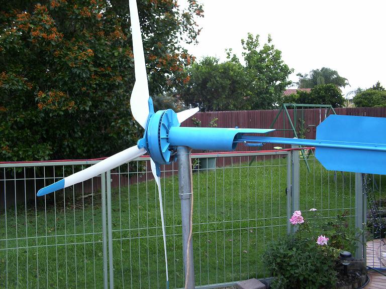

Posted: 07:18am 10 Feb 2008
Hi Glenn/ Gordon.
I forgot to mention, that the picture wasn't the site where I have positioned my mill. Its off the ground about 5-6 meters. That pic was just to test unit. Sorry about that.
I have open-circuited the wires, and the unit spins out to about 30 Volts, easy. Plenty of wind still ? This is in frequent burst, so I believe there is enough. I am thinking bigger blades again. Would wider blades and less of them produce a faster mill, and if so, will this produce more amps ? Or, do I not need a faster mill, but go right back to the core for a 24 or 48 V system ?

Posted: 07:21am 10 Feb 2008
Note, Furling system is pretty bad, dont try this method. Will change on the next mill.

Posts: 71
Posted: 03:08am 03 May 2008
Hey everyone, just to follow up. Have added wider blades from 12 Inch PVC, and all seems to be going well. Have seen more than 10 amps here on the new blades. (3 blade prop). Popped a 10 amp fuse one day, and that was a stupid move, all it did was open circuit, -but this gives a testimony to the strenght of my build -NO BLADE DESTRUCTION !.
Very happy with it, all I need now is more wind.
