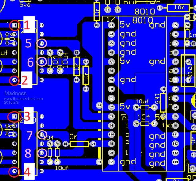

Good day All
I am building a ozinverter using clockmans powerboard and controlboard,
the problem is that when testing the control board there is no sinewave output at the low IR2110, but a square wave @ 50 Hz which is amplified version of the EG8010 output pin SPWOUT2.
There is no sinewave output at the high IR2110 but a square wave of 23.4 KHz also a amplified copy of the EG8010 output pin SPWOUT4
I am using EG8010 version HN1518HT1536 control chip.
I have tried 4 EG8010 chips all of the same version and all give the same result
Also have replaced the IR2110 chips also no change .

Hi John,
You will not see a sinewave as such until the control board is connected to the power board and the signals have combined together in the transformer.
The pins marked 5 & 6 will both have squarewave signals and 7 & 8 will have the fuzzy SPWM signal. 5,6,7 & 8 are the signals coming from the EG8010, so if you have these signals the EG8010 chip is working but it will be shutting down after 3 seconds as it is not detecting any voltage feedback. If you just have the power board powered up on its own you will get a square wave on the IR2110 on the pin marked 1 in the diagram below, 2 will have a very weak barely visible output, 3 will have a fuzzy wave that is the SPWM(sinewave pulse width modulation) pin 4 will also have a barely visible signal. If there is no out put at all from the IR2110 check that the 13V power supply is working.
Pins 2 and 4 are not showing any signal at this stage as they need voltage coming back on the 2 middle pins of the main 10 pin connector.
For initial testing of the power board it is by far best to not have the 6 10,000uf capacitors installed and to have around 30 ohms >20W resistance in series on the power supply. The reason for this is that the resistance will limit the energy available and prevent the MOSFETs from failing if there is a fault. The Capacitors must not be fitted also as they store enormous amounts of energy that will cause damage if something is wrong.
So once you confirmed the signals are correct as per the second paragraph connect the power board as described above. You will need to remove the earth pin on the power to your Oscilloscope for the next tests. With everything connected with no capacitors and the resistance in series voltage feedback etc all connected you can then connect the CRO across the AC output of the transformer (toroid). Have the CRO turned on and turn on DC power to the inverter, then turn on the switch on the control board. All going well you will get a sinewave output on the CRO, it may be slightly distorted at this stage and the EG8010 most likely will shut down due to low voltage (4 flashes) be aware that it will try again so don't touch the AC output until everything is shut down.
If this is successful remove the 30-ohm resistance and connect DC power via a low current breaker 10 or 20 amps, you will get away with using a 240V ac breaker. Now the inverter should power up and keep running with a nice clean sine wave, you will most likely need to adjust the voltage pot on the control board to around 220 to 230 volts. Now you can put the capacitors in the power board and assemble the inverter ready for use.
To upload an image use the 2nd button from the right below the word colour above the reply text box.
Let us know what you get at each stage.

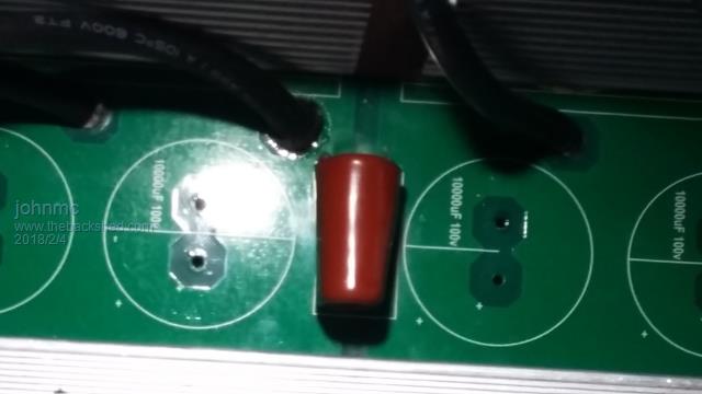

Good day all.
My Ozinverter up date,
Connected up the inverter , with no large capcitors on the power board, and 25 ohms restriction to the 48v suppy
inverter would start for about a second the stop and then repeat .
Removed the resistor and placed a 1 amp capacity lead in its place.
Inverter started and ran almost silent, output voltage could be adjusted between 210vac to 270va set the voltage to 230vac All smiles.
The fet heat sinks felt warm to touch. then I remember that the power board was set up with 5R6 ohms on the fet driver and for the EG8010 controller and Oztules had
that the fet driver should only be 4R7 ohms or the fets will overheat.
After about 10 minutes a wiff of smoke then fizzy sound then the metalized 4.7uF
capacitor on the mainpower board blew the end out.
Have ordered some 4r7 resistors and hope this allows the saga to continue
cheers john

I have seen everything else fail but never one of those red caps.
Good to see it fired up for you did you have your CRO connected to the AC out? The fact that it ran quite is a very good sign, if the wave form is wrong it will make horrible sounds.
It should be running fine with 5R6 gate resistors, could be you have a dodgy FET in there. Were all the heatsinks the same temperature? With no load and everything is right they will run with no heatsinks at all.

Also check the output of the ir2110's at the gates of the mosfets... i had a dodgy batch of ir2110s that had very similar output... 25 ohms is just shy of 100 watt, you should be pulling wayyyyy less than that at idle.
Ive had poly caps overheat but only if the undersized for the ripple through them.. so i think something wrong
Also those heatsinks should be cold at idle too..Edited by noneyabussiness 2018-02-06

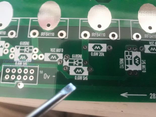

Regarding the power board, are you saying these resister values are incorrect?
I didn't see that comment from Oz.

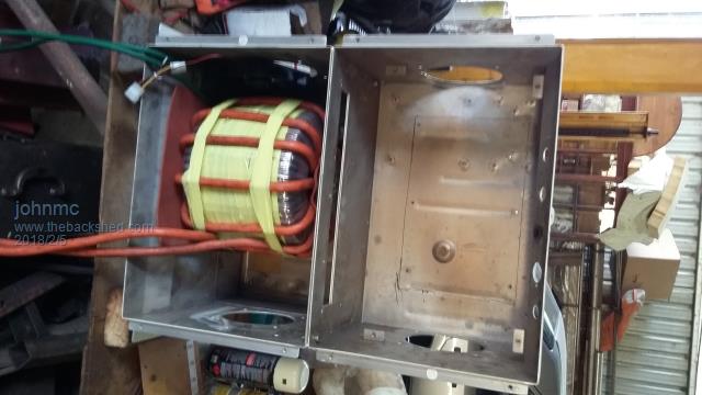

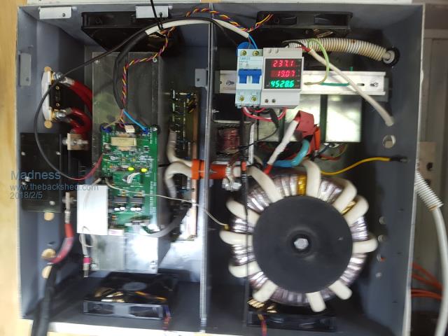

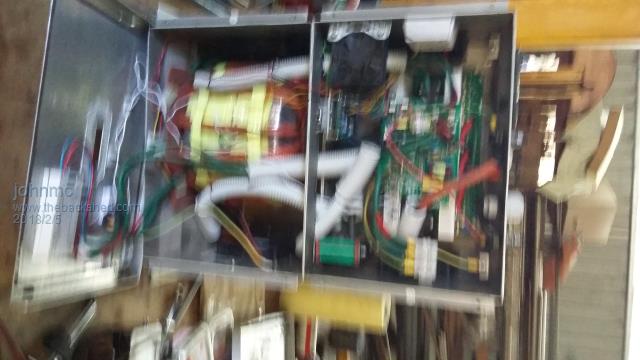

Hey John, if you could be stuffed could you do a pic or two of the layout you did with the aerosharp cases?
Cheers Mark
Cheers Caveman Mark
Off grid eastern Melb
Madness
Joined: 08/10/2011
Posts: 2498
Posted: 08:09am 05 Feb 2018
Here is mine, photo is a bit blurry though. I turned it 90 degrees to let the hot air rise.

Yes I am saying that the gate resistors are 4R7 1/2 watt
I am having trouble copying Oztules post Reply #289 on: May 28, 2016, 09:27:06 pm on the Anotherpower forum
Yes... you must replace the gate resistors with 4r7 ohms, and use a diode across then for faster turn off..... as in this:
Can not paste the image but it is from the EG8010 data sheet
Other than this, nothing else need change.
If you don't change these, it will get very hot very quickly.
..............oztules

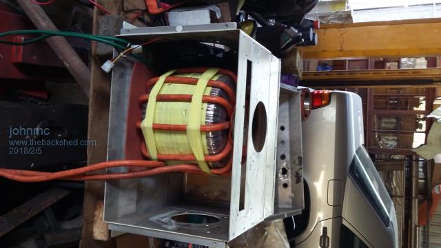

Here a 3 pictures of my inverter case
I needed to add extra depth to the bottom inspire case to fit the large transformer
For ease of working on,the next Inverter I will probably build a housing case, similar to the housing, such as made by thebackshed member Tinker
sorry for the image quality
cheers john

Joined: 09/12/2017
Posts: 1679
Posted: 09:03am 05 Feb 2018
Thanks John,
what is the reference to the diode?
Is it just the resistor that needs changing?
Cheers Mark

What does Clockman say about these resistors, I have been using 5r6 without an issue. I am sure your problem is elsewhere, are you not able to take photos of your CRO screen?
oztules
Joined: 26/07/2007
Posts: 1686
Posted: 10:44am 05 Feb 2018
5r6 if just fine. That is not the problem.. don't know for sure what is, but it is not that.
It may be too low a voltage on the gate, For 12v you will have to decrease the resistance on the 120r, and may be best to check gate voltage, as I am suspicious that you are in the 8v range, and they are not turning on properly
The diode is there to discharge the gate charge on turn off. It is as important to turn the fet off quickly, as it is to turn it on quickly, the diode helps in this, as it does not rely on the resistor to discharge the gate.
I have no idea how the 12v version runs, but if the fets are not turning on fully, then there is your problem.

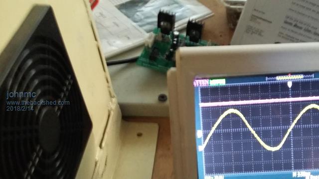

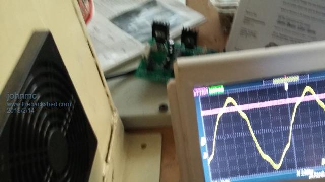

Good day all
I have rebuilt both the powerboard and the control board with no improvement to the
amount of standing power 50 volts and a draw of 2.5 amps the 120 resistor on the control board will get very hot ,does this suggest that the FET gates, there is 24 HY4008 FETs to drive, are they drawing to much current, the transformer makes virtually no noise but produces the following wave form
The interesting part is the shape of the wave form as it builds is a sine wave shape
also the first wave form looks as if a triangle shape had been added to the peak of the sign wave .
I also removed the inline 4 turn inductor /choke this only increased the standing current to 7 amps,this made no difference to the wave shape
There is no 4.7 poly cap (end blown out again) and no large capacitors on the powerboard
At the moment I am lost any suggestion will help.
Cheers john
johnmc
Madness
Joined: 08/10/2011
Posts: 2498
Posted: 10:13am 14 Feb 2018
What is different between the top and bottom sinewave?
The 120R resistor does run warm as it is dropping the voltage from 48 down to near 12V. What voltage is the 4.7 cap or is it a bad batch? I have not seen one fail.
First picture is what I would expect to see with a resistor in series, the second one looks normal.

With no caps and running through a resistor, you don't get a perfect wave form. The reason for running like this to check if you get close to it being correct, if something is wrong it looks a whole lot worse than that.
I think it is actually close to being right but I have not been given a much information to work with.

Posted: 11:08am 14 Feb 2018
Good day Madness and renewable,
The good sine wave is produced just as the transformer is building up voltage
The peaked sine wave is when the transformer is at voltage.
