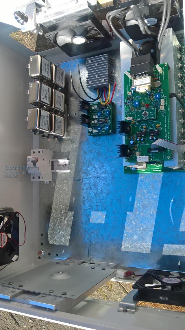

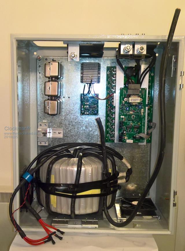

I am photographing and doing notes on this particular OzInverter build, and this will be in the new rewrite of the OzInverter Book.

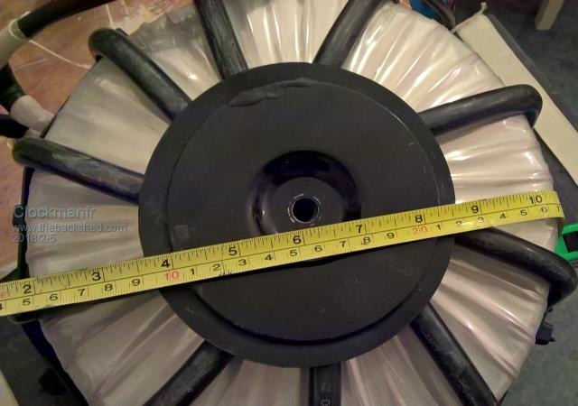

This is about as Big as I can safely go with the toroid at 51kg, which is just about manageable when your on your own, and as big as I can go without special considerations for the toroid damaging itself due to its own weight.
After due consideration over the past couple of years or so, the smaller 6kW OzInverter has plenty of operating/leg room and will actually run at 6kW, so doing the big OzInverter no longer makes sense for the extra work involved.
I will post pics as I go.......
The hardware all in and fixed and the OzInverter is ready for final wiring up.

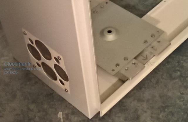

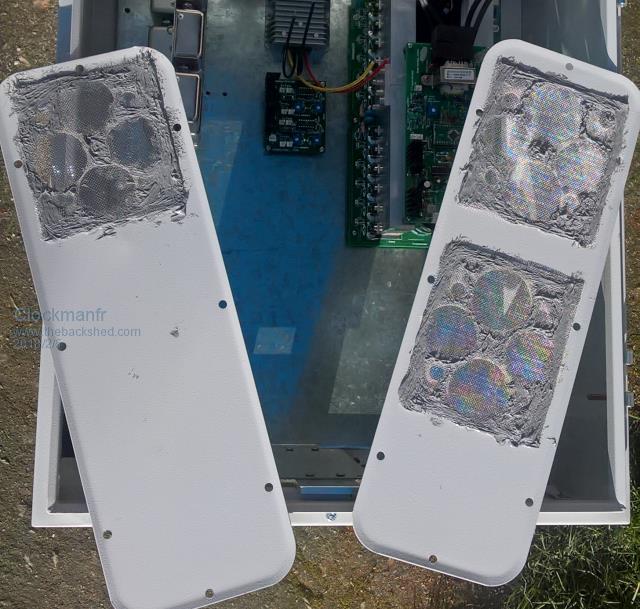

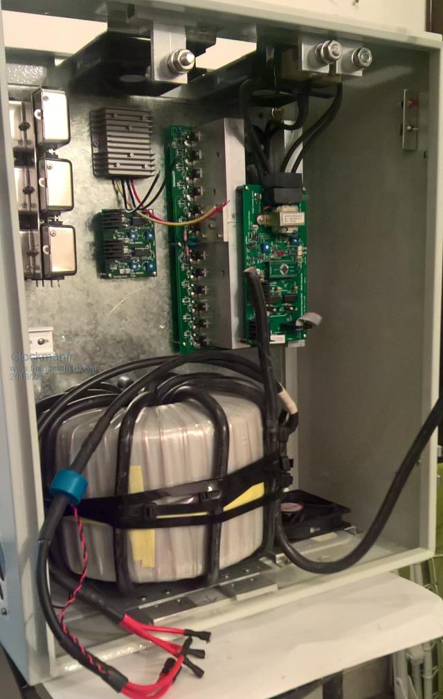

I use these steel enclosure cabinets, 60cm x 50cm wide and 30cm in depth.
They come with an internal back plate and two access panels top and bottom, I drill these out to match the fans, add silicone glue insect stainless steel mesh on the inside.
The two panels .....
The toroid base mounting plate and the toroid fan arrangement .......
Its a wide/large diameter and takes up 280mm of my 300mm depth. .......
The Pics have posted, I just was not getting the first Image box once you select 'upload image.
Now to do the 3 turns on my large ferrite E core and hard wire stuff in.
Top right inside the box, there is a small panel with a red button for re-set for the OzControl board, and a small toggle switch for switching in the 40ohm resistor on initial power up that dribbles into those 6off big capacitors. Wait a few minutes then I switch on the main battery breaker, then switch off that 40ohm resistor.
There is 9 of those 20amp 230vac EMI filters.
OzCooling board with its PSU above. It takes 48vdc and gets it down to 12vdc. I will also use that PSU 12vdc for the front door monitoring display/controls.

The 40a RCD for the 230vac out.
A few more holes to drill in the side for cable glands.

Jeez thats a monster of a transformer- wall hanging the whole lot would be a right pain!!!
Very nicely done tho

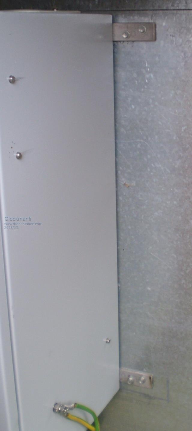

Yes 'Boppa', I allways advice that the unit is wall mounted with some sturdy metal under mounts.
These are for the 6kW....
Case/enclosure Top and bottom brackets......

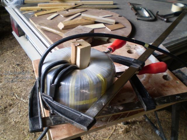

My secondary is 16mm/2, and brakes out to 3off 6mm/2 where they connect to the EMI filters that are good to 60amp at 230vac.
Mark , Note that Blue coloured sense coil on the 16mm/2 secondary.
The primary is 75mm/2, (I see that I can not get 75mm/2 any more all my suppliers have only 70mm/2).
Me beating the c..p out of the 75mm/2. with my winding table clamped to the back of a flat bed trailer so it does not move but gives me space to move that long cable about.! Yep 75mm/2 is the max for that.!
