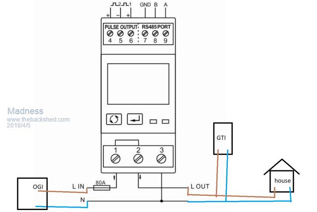

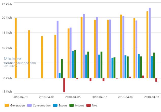

I have one of these Eastron SDM 220 Modbus meters. After a bit of fiddling around, I finally got it communicating via RS485 with my Zevercom device for my Grid Tie Inverters. However, the Zevercom is telling me that my power consumption is exactly the same as power produced by the GTIs. Has anybody else had experience with these, I can't fiddle around too much with it ATM as it is wired into the house power now and I have to shut down everything to work on it.

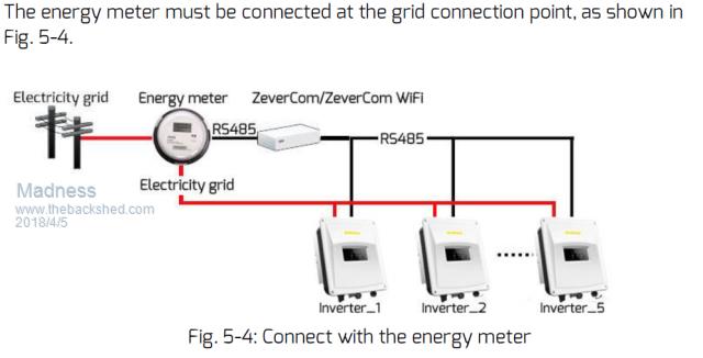

This is how I wired the meter, I am treating the off-grid inverter as if it were the grid. So exported power is what is going to the Battery via the off grid inverter.
This all that the GTI manufacturer shows

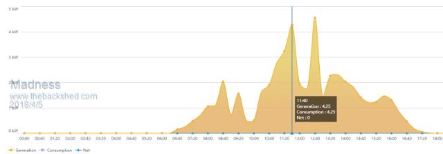

The meter is reporting zero net export which is not correct, it is supposed to give power produced by the GTI's, power consumed and net power exported. All get is generation and consumption being equal all day with nil export. My battery is not full ATM it got to 97% today due to cloudy weather.
I think I should try connecting the GTI to the same side of the meter as the Off-Grid Inverter.
Here is the graph, net is shown flatlining across the bottom, Generation and Consumption are the same value all day.
Posted: 10:22am 05 Apr 2018
There is a link shown on that meter sketch, if its there it should not matter which side your OGI is connected.
I'm not game to look up the manual
That link has a Hall Effect Sensor on it, it is not just a link.

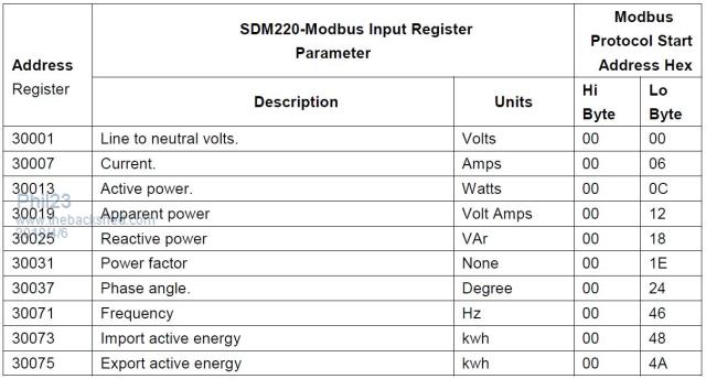

Phil23
Joined: 27/03/2016
Posts: 1667
Posted: 09:00pm 05 Apr 2018
  yahoo2 said  the values on these meters are a float value it is using 2 consecutive register addresses to calculate things
Been playing with a bit of code for this the last week or so.
There's a bit of it over in the Micromite forum.
So far have IEEE754 decoded & CRC dealt with.
Just need to build the request frames now & pull apart the response.
One thing I don't have clear in my head is the two addresses shown in the table.
I'm getting data from the one's on the right, like Active Power, 00 0C not sure of the relevance of 30013 & presume it's the register I get anyway.
Modbus is totally new to me....
Phil.
yahoo2
Joined: 05/04/2011
Posts: 1166
Posted: 12:53am 06 Apr 2018
Thanks phil that table helps.
what you are looking at in the left and right columns is the same thing, the address register on the left is decimal starting at 1 and the right column is a hex start address which starts at 0.
some machines want you to enter the hex value expressed as a decimal, to get address 0013 you would enter 12 because 12 is the 13th number starting at zero
the last four digits of active power 0013 and hex 00 0C (12) are the same address.
so the complete list of allocated addresses for a 3 phase meter active power would be
phase 1
0013 (00 0C)
0014 (00 0D)
phase 2
0015 (00 0E)
0016 (00 0F)
phase 3
0017 (00 10)
0018 (00 11)
if you look at the table the next address is 0019 for apparent power so this allocation of numbers repeats itself again.
when you poll the meter for data you have a couple of options, you can request a range and grab the lot as a big chunk and let the master sort out the bits it needs or you can poll individual addresses.
there is usually an option to use the first address OR select the pair together and calculate a float value.

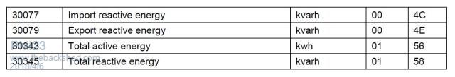

That table has not got total energy listed, there should be some allocated addresses between 0330 and 0350 from what I can remember.Edited by yahoo2 2018-04-07
Phil23
Joined: 27/03/2016
Posts: 1667
Posted: 06:00am 06 Apr 2018
  yahoo2 said  That table has not got total energy listed, there should be some allocated addresses between 0330 and 0350 from what I can remember.
Yeah, Sorry,
It continued on the next page...

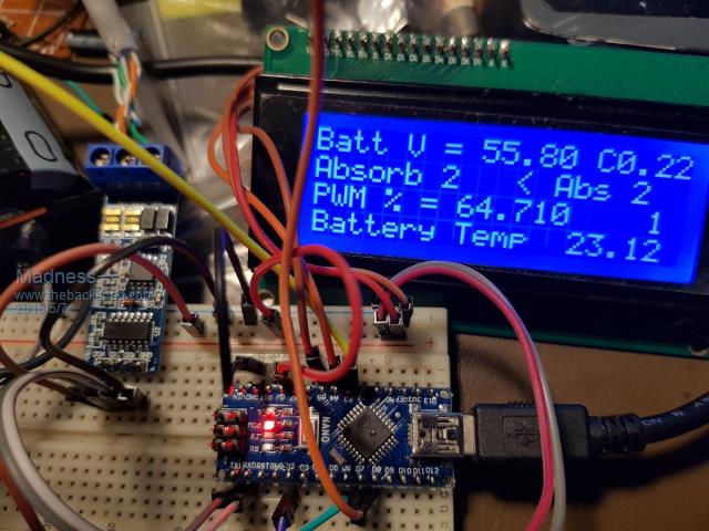

The video Yahoo referred to can be seen here it goes into quite a bit of detail about getting the data from the meter.
I think my problem is there is no data coming out of the meter or it is not able to communicate with the Zevercom device. I changed the wiring around and it has no effect on the charts. Also I emailed Zeverrsolar about what settings are required but no response as yet.
I have ordered some RS485 to TTL converters which are very cheap on Aliexpress so I can use an Arduino to talk to it. May end up using the Arduino to regulate the GTI's via RS485 instead of the PCB and MOSFETs in series with the panels.

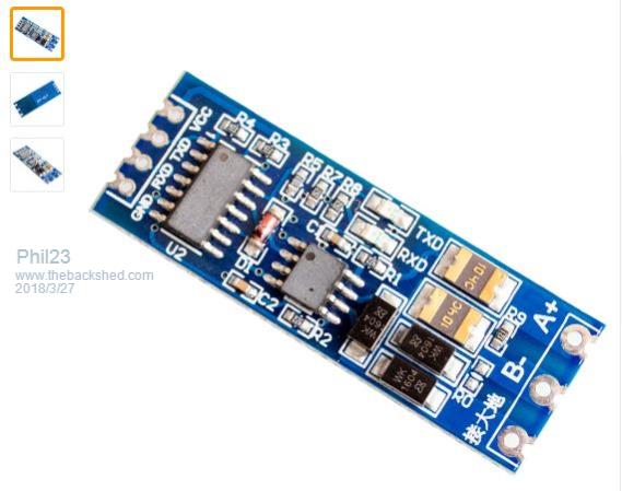

I got the same modules initially, but ordered these others as well.
They seem to work fine when connected to a USB-TTL CP2102 module.
Can talk to the meters with some Modbus software I found.
These,
https://www.aliexpress.com/item/TTL-turn-RS485-module-485-to-serial-UART-level-mutual-conversion-hardware-automatic-flow -control/32709226383.html?spm=a2g0s.9042311.0.0.0pGBWV
They might be easier to live with as they handle the flow control themselves.

Phil have you had to add the 120-ohm resistors to terminate the RS485?
Thanks for that link, I have ordered some of those modules also.

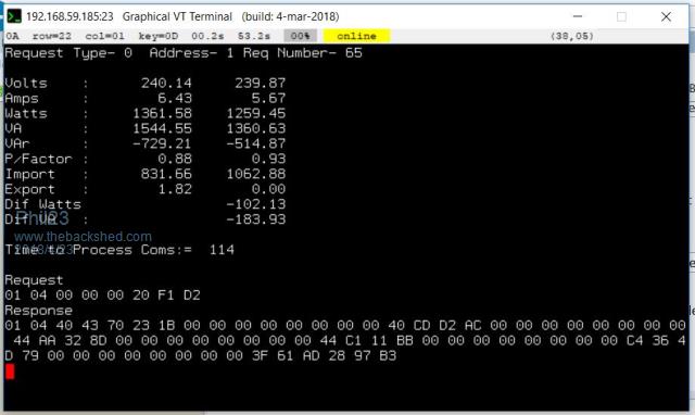

Posted: 09:27pm 11 Apr 2018

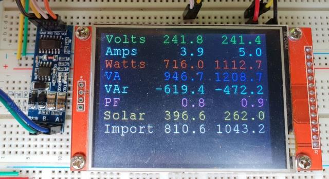

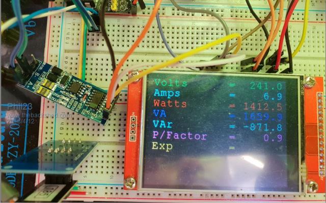

Pretty much got it sorted now.
Reading the first block of registers all in one hit.
[Code]
$ð
01:04:00:00:00:24:F0:11:
Volts : 241.17
Amps : 6.74
Watts : 1371.38
VA : 1625.47
VAr : -872.62
P/Factor : 0.84
01 04 48 43 71 01 9E 00 00 00 00 00 00 00 00 40 DC 65 47 00 00 00 00 00 00 00 00 44 B0 90 11 00 00 00 00 00 00 00 00 44 CF 7C BC 00 00 00 00 00 00 00 00 C4 59 F5 8C 00 00 00 00 00 00 00 00 3F 59 D7 EC 00 00 00 00 00 00 00 00 7D 46
Length= 154
>[/code]
Have it also displaying on a 2.8" LCD screen. Just needs some decent formatting now & overall a bit of polishing.
Still TOTALLY work in progress, but here's a bit of an idea of how it might fit on the display.
I can fit 10 lines by 18 Chrs with that font, so should be able to list output from 2 meters side by side.
Bottom left is an ESP8266 that connects to the console.
Nice thing about that is I can access it from any PC as well as mobile devices via a VT100 terminal.
Just need to tidy up all the code now & present the data better in the Console & LCD interfaces.
Phil.
