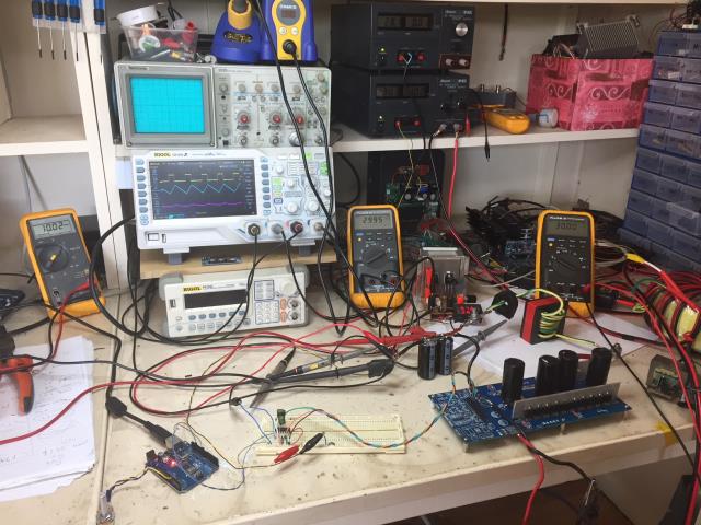

I present here my strong DC-DC converter.
It's based on a broken inverter board, only using one 1/2 of the bridge.
5 x HY1906 per leg of the bridge. Talk about low Rds(on).
Vds is only 65V and that is a problem since the array is wired in 2S so I get about 78V open circuit. No worries, this is just a proof of concept.
I have some 3300uF 90V caps from the broken Victron inverter, so I used a few of them, 4 on the input, 2 on the output.
I drive the mosfets from an IR21844 1/2 bridge driver, 400ns dead time.
The gate driver IC is driven by an Arduino with a 20kHz PWM, 0-100% via a potentiometer.
I have a home brew constant current load, based on a pair of mosfets I pulled out of a dead plasma TV, a PC cpu heatsink and a LM358 op amp. This load is good to 150W or more at 5A with large DC volts headroom.
Operating conditions are:
30.0 V, 1.02 A DC in
10.00 V, 3.00 A out.
The conversion efficiency is absolutely insane.
(10.00 x 3.00)/(30.0 x 1.02) = 98 %
It should come as no surprise that the mosfets remain stone cold.
This will do the trick. The first limit to explore is the saturation of the inductor
but for my needs I only need to deal with about 20A.
What a success.
Here is the setup.
You can see the DSO recording the PWM, inductor current and output DC ripple.
The ripple is only about 100mV. The inductor current trace shows nice straight lines which means no saturation.

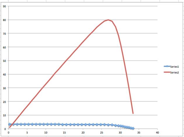

Since my aim is to get the best from the 12 panels on the house roof facing East, I thought I better do a bit of homework now. There is another 3kW array wired in 3S x 4P tilted and facing North, this gives me the majority of the energy to the system.
The panels are Topsola 250W TSM60-156P poly. I wire them 2 in series and have 6 of this in parallel. My battery is 48V lead acid.
The manufacturer's specs give I/V curves for various illumination power levels.
I want power/Voltage curves. I used https://automeris.io/WebPlotDigitizer/ to give me data points of the I/V curve, used Excel to give me power and plotted the power/Volts curve myself.
I/V
Today I was seeing current levels of 10 to 16A from this array with a battery voltage of 52 V. This means up to 2 A per 2 panel pair. So I use the 400W curve supplied since that is near enough.
P/V
From the raw data I see max power voltage (for this illumination) is 26.78V or when 2 panels in series then it's 53.56V at 79.8W. At 26V, the power is about 78.5W
The best I could ever achieve with mppt is to go from 78.5W to 79.8W per panel.
That is a 1.6% increase.
The only reason I put this extra array on the roof was to get something more from cloudy days, which we have in abundance here in Melbourne.
Power levels under cloudy skies are of the order of 400W/m2 illumination or 78W per panel.
So I conclude mppt is of no use for me with my 3kW array under Melbourne cloudy skies
when I wire the panels in 2S x 6P and feed it into a 48V battery at a high state of charge.
I finish this mppt investigation here. It was a nice idea but I don't need it.

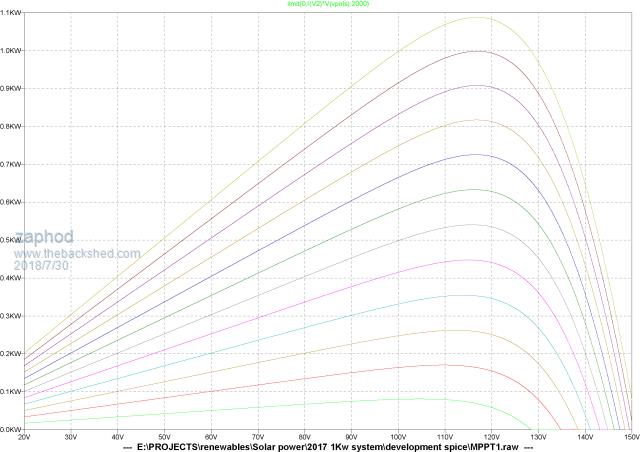

Hi Poida, I would not be so quick to dismiss MPPT particuarly in cloudy places like Melbourne for you and UK for me! Except in high summer & blue skies my array spends a lot of time well under 400W/m2 and today for example has spent most of it around 70-100 with a peak of 200. Combine this with temperature effects and your battery state and it is very easy to fall off that rather sharp right edge of the power curve and end up with nothing particuarly at the beginning and end of the day. As winter advances the proportion of time spent at marginal power increases.
Of course having built and programmed an MPPT controller I am a supporter and I agree there may be places like the Sahara where one would be wasted and also there are a lot of rubbish controllers that claim to be MPPT but are simply constant voltage etc etc.
After 2 years of PV experience I say go for it but dont ever buy a commercial one :)
Even on a very cloudy day like today I have done over 0.8Kwh/Kw installed and it's not dark yet! I have seen it follow the dusk down to 1W/Kw installed before it gives up :)
PS here is one of my panel simulations to give you an idea of what happens below 400W/m2 (this is four 60 cell panels in series at 25C in 100W/m2 increments)
Edited by zaphod 2018-07-31

Posted: 10:40pm 29 Jul 2018
That is pretty much what I have, four 24v panels in series per string.
With a 100v (30 Winston cells) lithium battery and NO mppt in my controller.
Using your curves which look to be about right.
In a clear blue sky the optimum solar panel voltage would be about 115v.
In dismal grey total cloud, the optimum panel voltage might be about 105v
I concur with Poida, that a fancy software mppt controller is of rather limited value if you have carefully matched your battery voltage requirement to your panels.
But you will never know for sure unless you do the test and crunch the numbers.
As I have 5Kw+ of panels, or about 40 prospective amps ? taking ten amps or less of that for the charger is rarely ever a problem. A super smart software mppt might only take 9 or 9.5 amps to charge the battery at 10 amps, but that slight improvement would go completely unnoticed as there is almost always a power surplus available for charging.
I worked all this out, not from simulations but actual measurement of the panels I planned to use. I used a Turnigy power meter and a continuously adjustable load of a big electrolytic and a pair of parallel 9 ohm radiator bars that discharged the electrolytic at an adjustable duty cycle. After seeing how constant the peak power voltage really is, even under extreme conditions, I decided to just overpower the system with a few extra panels and not bother about any slight loss from voltage mis matching.
Edited by Warpspeed 2018-07-31

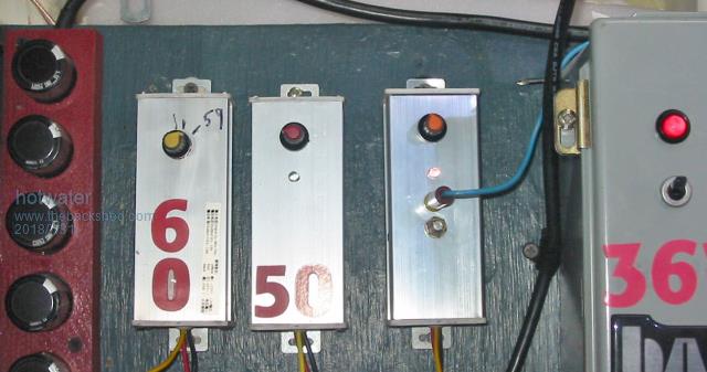

I'm getting lazy and everything is already probably being built. I have grid tie panels and use these $5 72V buck converters from China in parallel. They even come in a case with space for mods. It is easy to get them to operate autonomously at a power point voltage or drive them from an arduino. They even have their own opto isolator input. Saves hunting around for parts. They cqn easily operate MPPC which is constant voltage. I've run tests at the camp and in one season that power point doesn't change that much.
