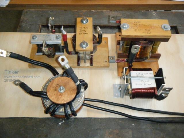

In the three 3KW Aerosharp inverters I took apart there were three big chokes. Two were smaller than the one large one.
While the coils on these are useless for the inverters being built here, the C- cores certainly are very useful as I found when testing some with inverter #4.
The core is made from some very thin, sharp flaky material and requires caution when handling.
I had written elsewhere how best to get these chokes apart to remove the existing coil but my last one refused to come apart by that method.
So I slow cooked it at around 100 degrees C in an old oven, it softened the varnish and it disassembled easily.
Anyway, I ended up making 5 different chokes for testing which one works best, and the result was surprising - to me.
On the picture above, on the left, back row, is the usual E65 ferrite choke that was recommended by the original inverter builders. It has 4 turns of 63mm sq. L=53.8uH
Left front row is a ferrite ring core with 2x3 turns of 40mm sq wire (2x20 in parallel).
L=56.3uH for each coil.
Center, back row, is a choke made from 2 sets of the smaller Aerosharp choke, the C cores arranged to form an E core. It has 9 turns of 45mm sq and a 2mm air gap. L=43.5uH.
Right, back row, is a choke made from 2 sets of the larger Aerosharp choke, similarly arranged as above. It has 18 turns of 40mm sq and a 2mm air gap. L=174uH.
Front row, right, is my latest choke, made from a single large Aerosharp choke. This one has 11 turns of 60mm sq, a 1mm air gap and L=74uH.
First I tested each for the no load, idle power, of the complete inverter, running from the battery.
Best was the big dual large Aerosharp C core which used just 10.9W but had small wiggles along the sides of the sine wave.
With a 2KW load the sine wave was very good.
Next came the single large C core version, 12.3W idle and best sine wave.
With a 2KW load there was no observable change in the sine wave,
Then the choke made from 2 sets of the smaller C cores, 14.22W idle and a clean sine wave.
Under 2KW load the sine wave had a small kink at zero crossing.
Second last test was the E65 ferrite core, 12.6W and clean sine at idle.
At 2KW the sine wave had a kink at the downslope zero crossing and fuzz on the top & bottom peaks.
Last test was the ferrite ring with each winding going to one side of the primary.
This had the worst idle at 15.8W and wiggles at the zero crossing of the sine wave.
Under a 2KW load there was a distinct kink at the zero crossing and a fuzzy wave at both peaks.
So it seems (to me) that using that ferrite E65 core is not the best choice since a rewound single large Aerosharp C core gives better results and much more room for the wire (20 x 70 mm).
This is what I will be fitting tomorrow into my large dual stack inverter, replacing the ferrite E core and dual small C core chokes that were in there. It appears that a single choke was better than the combination I had in there. We shall see how that performs under some bigger load.
I had used a 1mm air gap which gives 170A (peak) saturation current. This can easily be changed by using a different air gap.
If anybody is keen to replicate that choke making I can post some tips how I made mine.

I remember Poida showed some results to show the ferrite gets rid of some high frequency crap.
I used a double stacked (4 pcs) E70 ferrite in series with a double big aerosharp c core.
Do some series testing Klaus...... I'm actually surprised you didn't.

I am, with the equipment I have here. Not everybody has a fancy digital oscilloscope that does screen shots.
Have you tried your inverter 'without' that ferrite choke? Just the ex Aeroshearp rewound?

Aaron, that choke is now hidden inside my big inverter. But from memory, the air gap spacer measured 20x40 (or45)mm. This is, of course, the cross section.
I think the reason why this material seems to work better than ferrite is the fine flaky core rather than sheet laminations.
The only way to find out what works is to experiment - join the club .

Posted: 09:58am 05 Aug 2018
Thanks Tony for the excellent theory lesson. I'm more of a practical person and much happier to experiment physically rather than with a pencil on paper.
So to continue my experiment I fitted the single large ex Aerosharp choke (silicon steel as you say) with 11 turns of 60mmsq wire into my big dual core toroid inverter. I set the gap at 0.8mm.
I prefer bigger wire cross sections for the high currents even if the wire length is only from 2.5 - 3m. I wind these coils using three wires of 1.8mm dia. enameled wire, wound simultaneously and can fit 11 turns in the 70mm space available. There are 8 parallel layers of that, adding up to the total of 60mm sq.
This makes max available space usage and could not be done with round insulated cable of the same specs. Besides, I have a stack of that wire left over from the original Aerosharp toroid just begging for a use .
This choke measured 74uH and saturated at 120 Amp RMS. A bit low but still good for almost 6.5KW.

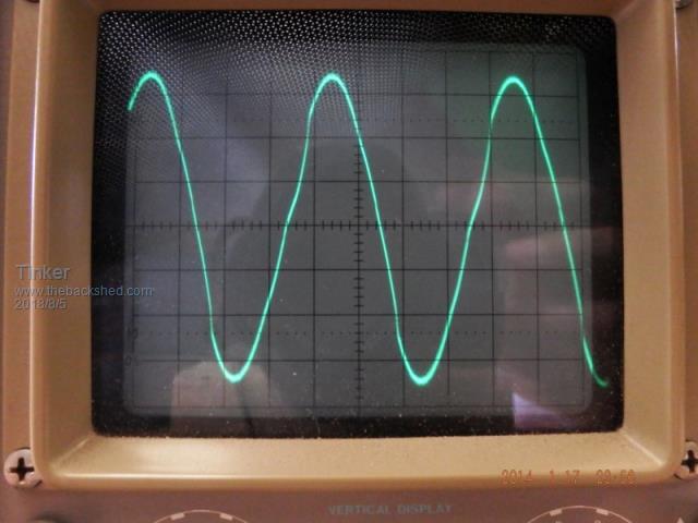

This is the trace at idle. Idle being 35W of which 3W go to the displays of the V/A/W/KWh and the fan temperature controller.
Note there is a small wiggle in the up slope but no zero crossing kink. If there were a ferrite choke as well it would have that zero crossing kink.

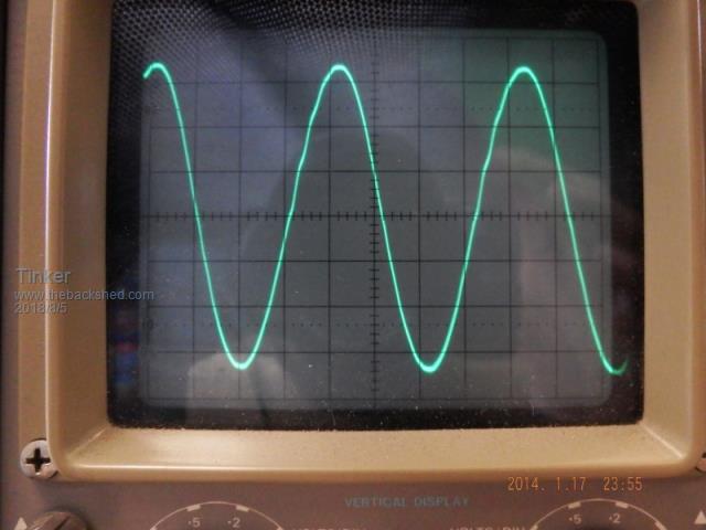

And this is the trace with a 5.3KW load (100 Amps from my battery).
Note there again is no zero crossing kink.
I had experimented with my dual large aero C core choke which has 18 turns of 40mm sq wire and a 2.5mm gap. It measured 174uH which is good but the trace from it was not so good looking.
So I'm going to wind another coil for the dual large C with just 11 turns, 60 mm sq wire. Doing some testing with my 125 turn test coil for this core I can get the saturation RMS Amps up past 150 with a 1.5mm gap. If the inductance gets above 100uH with that it will get fitted in my dual toroid core inverter. The single C core choke can then fit into my spare single toroid core inverter.
I got that choke coil winding sussed out by now too but making the rigid coil former takes more time than winding the 8 layers. Perhaps I should start selling these coils, the labor contend would have to be free though .
No ferrite chokes any more for me.
I suppose we had them because the pioneers of these inverter conversion found ferrite chokes good for reducing the very high idle current of the PJ inverters.
And everybody seems to have followed that idea since...

Many people saw the wiggles produced by fitting a larger choke, and just assumed that fitting a bigger choke was causing the problem, and was a backward step. Not so !
The wiggles and kink are introduced by the transformer itself and can only be fixed properly by changing things at the transformer. The kink can probably be fixed with an electrostatic screen, but that is difficult to do properly with a toroid and is not as effective as with a normal shell type E and I transformer.
The wiggles can be fixed (or greatly reduced) by very careful resonant tuning of the transformer winding that has the largest number of turns. For a battery off grid inverter that will always be the secondary winding. Commercial grid tie inverters often place this tuning capacitor across a higher voltage primary winding, because it requires a smaller capacitor when connected to the highest inductance winding.

About that "kink", my large double core inverter does have a good electrostatic screen. That might explain why its not present on this inverter but 'is' visible on my smaller test inverter which has no such screen. I just was not aware what could have caused it.

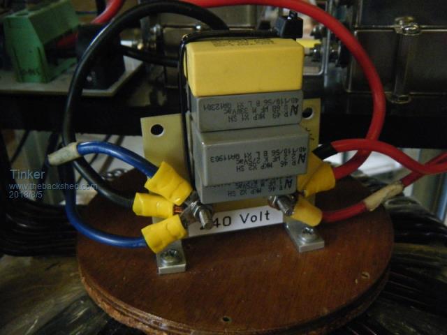

About the "wiggles", my large double core was very carefully tuned to 75 Hz resonance. This was much more obvious to see here than on the smaller test core.
I fitted 4.6uF, had to improvise with what caps I had on hand.
From what little of the "wiggles" is left now under load, I can live with that.

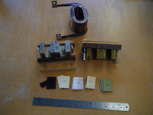

Perhaps a little addition about terms like "saturation" and "air gap" might be helpful for some.
From the above link we see what the choke in our inverters is supposed to do. Current flowing through the choke turns creates a magnetic field, the strength of which depends on the number of Amps flowing and on the number of turns the wire makes around the core.
Increasing either or both increases the magnetic field. But there is a limit on just how tightly those magnetic lines (flux) can be packed into a given cross section of core material.
If trying to create more flux by increasing the Amps beyond a certain point the core "saturates", it can no longer accommodate that extra flux.
The result being the choke no longer does its job to smooth excessive current demand spikes if the saturation A/t's are exceeded, putting strain onto the mosfets which have to handle this.
What to do? One way is to increase the core cross section area but this is not often practical.
But there is a neat other trick to get around that. It so happens that the magnetic flux travels about 10,000 times easier through the core material than through air.
So just a very small (relatively) air gap greatly increases the saturation point, allowing for the choke to do its job for a higher current.
We measure saturation in Ampere turns (A/t), meaning a one turn coil saturates at so many (100s, 1000s) of Amps. A ten turn coil saturates at 10 times less current, and so on.
Now "air gap" can mean that literally but that means shortening the center leg of an E core - not always convenient and not adjustable.
But we can fill the gap with material that can take clamping pressure. Of course that means 3 spacer shims for an E core.
The requirement for this gap material are:
It must be non magnetic (obviously )
It must be non conductive (to stop eddy currents heating it up)
It must be flat, rigid and able to withstand the temperatures inside an inverter (~60 deg. C) without deforming.
In the picture below I show how I arranged the two C core halves, bedded in epoxy, to make a rigid E core so the lot can be clamped together easily.
In the foreground are the various gap spacers I selected for different gap sizes.
From left to right, 0.9mm bakelite, 1.2mm plastic, 1.5mm plastic, 1.9mm model aircraft ply, 2.4mm (3 layers of formica superglued together.
Many other materials might be suitable, I used what I had in my shed.
In the background is that 18 turn coil I mentioned earlier in this thread. I'm going to make another one as this one has the connecting lugs arranged so it won't fit into my inverter.
So here are my test results for the pictured choke which might give a good ball park figure to those who do not have a suitable test coil nor the required saturation test equipment.
Dual large C core choke (cores ex Aerosharp)
Core X area 33x45 = 1485mm sq. Area available for the coil 20 x 70 mm
Saturation occurred with
no air gap: 625A/t
0.9mm gap: 1562.5A/t
1.2mm gap: 1875A/t
1.5mm gap: 2625A/t
1.9mm gap: 3125A/t
2.5mm gap:3750A/t
Keep in mind that I had read these values off the graduations on my oscilloscope screen, alas it has no fancy digital value display.
Also, it applies *only* to that particular core material, other cores, even if the same cross section, are likely quite different.
These currents are the peak values. For the equivalent RMS power calculation divide the A/t by 1.414.
Example: 1.5mm gap, 2625A/t, 18 turn coil = 2625/18 = 145.83A peak = 103.3A RMS.
103.3A RMS at 55V battery voltage means at 5672W RMS power draw from the battery the choke begins to saturate.
As there are losses involved I would limit that inverter for a steady 240V 5.5KW power draw.
If things like fridges, motors etc are plugged in the steady draw should be quite a bit less since the start up current of motors can be 10 times higher (briefly) than the running current.
Next post is the same test with two C cores of the smaller Aerosharp choke. As there are two of these in each Aerosharp it might be useful for the single toroid inverter builders.
I plan to have one of each arrangement with max # of turns & optimal copper cross section. Testing of these later.
Edited by Tinker 2018-08-08

As a matter of interest, Mark's choke used two sets of those larger Aerosharp cores with about a 1.0 to 1.1mm gap. Difficult to measure exactly as it was all glued together into a solid lump. Anyhow, that would fall about mid way between your 0.9m and 1.2mm measurements.
Assuming that can reach about 1,670 ampere turns, with 12 turns that works out to around 139 amps saturation for Marks choke. Those twelve turns produced 125uH.
It used 25mm^2 single insulated marine/automotive fine stranded cable of just under 10mm OD. In theory 14 turns should have just fitted into the 20mm x 70mm slot, but in practice 12 turns was the absolute limit. It required I think about 3m of cable.
We only had one go at this, and by sheer luck it all worked out very well indeed having pretty well an optimum balance between saturation and inductance with the gap the core already had.
A very few extra turns with a slightly larger gap may have been better, but that would have required using something other than the straight off the spool round plastic insulated cable which we already had, and was very easy to try.
One winding technique you guys may like to think about would be to cut up some sheet copper into a long strip, maybe 1mm thick and 50mm wide. Wrap that plus a sheet of mylar insulation 70mm wide around the core. The slot is 20mm high, so at least 15 to 18 turns should be possible of 50mm^2 copper. If the copper is first annealed with a blow torch it should become very soft and very easy to work with, especially if each turn is gently hammered flat with a soft hammer where it has to pass through the slot in the core.Edited by Warpspeed 2018-08-09
