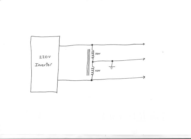

Posted: 11:13pm 01 Apr 2019
Not sure exactly how the US power system is actually used, but I am assuming that all major loads are 220v, and only minor loads such as some lighting actually use the third neutral wire ?
If that is the case, then just build a 220v Warpverter and split that with a smaller centre tapped inductor to provide the centre neutral connection.
The inductor could be made from a standard 110v to 110v isolation transformer.
It would only need to have a power rating sufficient for your minor 110v loads.
Most of the load current would not flow through the splitter inductor, only the residual of any load unbalance.
Edited by Warpspeed 2019-04-03
LadyN
Joined: 26/01/2019
Posts: 408
Posted: 04:42am 02 Apr 2019
  Warpspeed said   Not sure exactly how the US power system is actually used, but I am assuming that all major loads are 220v, and only minor loads such as some lighting actually use the third neutral wire ?
Tony,
it uses something called a Split phase. You know more about that than I ever will and I have not looked into it.
What it feels to me is that we can view our power supply as a 220V center tapped transformer and we are all working off one of the taps.
Heavy loads like water heaters, furnace etc use the full windings (=220V) while all the electronics (TV, Computer, fans, lights) use the 117VAC
Now this is where I get confused - they all say it's 117VAC but why is then the full winding 220V?
Sometimes they also say it's 208V.
It confuses me so much that I have kept it aside for later as I am need to work on the warpverter brain for now.
I just wrote this all down in case it can remotely give you an idea
Posted: 10:31am 02 Apr 2019
  LadyN said
Tony,
Power (what comes down the wires from the power station) is *not* generated in a transformer but in a 3 phase alternator.
Those three phases (at some higher voltage) get then fed into a 3 phase transformer which drop them to the level at your power socket.
As the transformer is three phases, the voltage between each phase is x sq root of 3 the voltage between neutral and one phase. Neutral being the common center of the 3 windings(one for each phase) in the transformer.
If you are really curious about this google 3 phase generation and read it better than I can explain it.Edited by Tinker 2019-04-03
