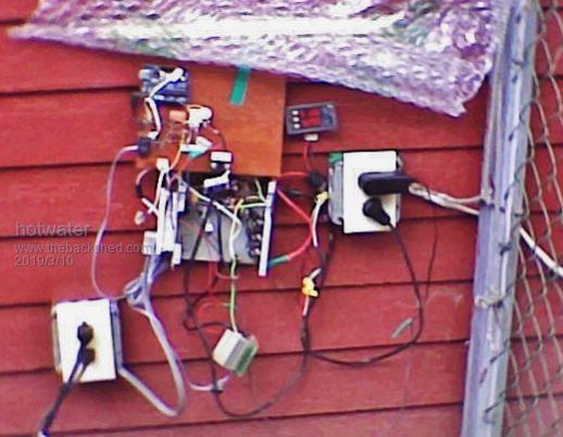

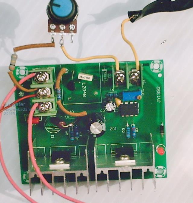

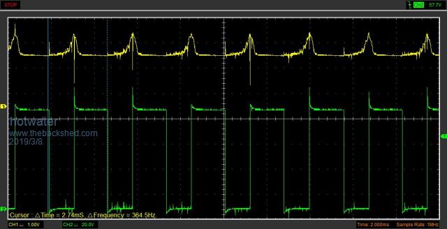

For several years I've been heating water at my camp by this method. Two years ago I
totally disconnected the propane heater from the system as the PV was working so well. I was heating a 9 and 20 gallon tanks in series till almost the end of last season when it started leaking. I replaced the 0 gallon with a 1400W 120V ECOsmart point of use tank as the primary. This is very responsive and takes only 900WH to raise the temp 60F. Tempered water takes even less time. I also run my dishwasher heating element off this which switches in automatically. As a bonus I can still plug it into my generator when I've packed up the solar panels for the season. There is no reason not to have ready hot water around a camp when these cheap 6 gallon tanks are available.It's free hot water from power everyone of you waste and this is almost 100% efficient.It is amazing to see it diverting as little as 5w into the tank.
I'm using a modified 300W inverter board with 60V grid tie panels at my camp to heat water. Power comes from excess solar not used to charge my battery. This operates
in parallel with a MPPT charge controller. The modified inverter board that gives a really clean look to the build. Only a half dozen parts need to be added. Made from a $6 ebay 300W inverter board (not the limit of the system). These used to come with 75N75 FET, but recent boards come with IRF3205 which are limited to 55V. I've replaced them with 110N15 which is a 150V FET. Be sure the board pictures an 8 pin chip as there are some new variations. A capacitor bank provides storage of energy when the FET are in the off state. Do not use with PWM controllers unless an isolation diode is used between panels and capacitor bank.
This control keeps the panels at a fixed power point voltage. I haven't seen much need to track as the wattage is consistent over several volts. Seasonal adjustments to the voltage seem acceptable. One neat feature is that existing mechanical thermostat switches work well in this circuit. A 270 ohm 5W or higher resistor is placed across the switch contacts. This does two things. The capacitors are kept charges at the set voltage reducing current surge when the contacts close again. The differential voltage across the contacts can be kept under 30V. When the contacts open, the driver immediately shuts off once the voltage on the capacitors drops less than a volt. This leaves the differential across the contacts as the open circuit voltage minus the set voltage.

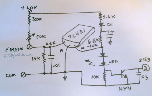

The TL431 controls the operating voltage. The voltage divider into the reference pin should be designed for 2.5 volts. This is when it conducts heaviest. The cathode can pull down to a little below 2V. The diode, LED, transistor combination create an offset of .6V + 1.7V + .6V = 2.9 volts. When the cathode of the 431 goes above that (indicating low voltage) the transistor shorts out the oscillator capacitor C3 bringing both FET gates to zero and no conduction thru the heater element.
The yellow scope trace is the cathode of the TL431. The bump up is the sensing of a lower voltage sending the board into shutdown. The low portions of the green trace indicate when the FET is conducting and the upper the capacitor bank voltage. Each FET has a maximum50% duty cycle. The output of each is connected in parallel. This is operating in a test where a very noisy boost module is used. The spikes are not real and just inductive pickup of the leads.

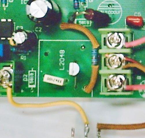

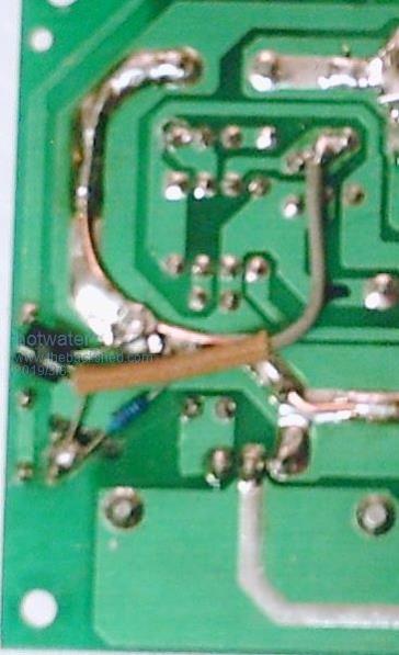

Posted: 03:36pm 07 Mar 2019

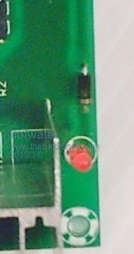

First modification to the board is to remove the black relay. This serves no purpose other than to protect the board from reverse voltage. That is a real possibility normally since the board terminals are not marked. This provides a space to mount the new components.
Next to the relay space is diode D2. That is removed along with the resistor (10K) above the LED. The diode from D2 is now placed in that resistor location with the band towards the LED. The diode and LED act as a zener ( .65 + 1.7V). The LED also provides some visual indication of inhibit. Although, the board is in some degree of inhibit almost all the time.
On the back side of the board, solder some extra solid wire from the FET source pins to the common connector. The outside lead of the LED needs to be isolated. Cut the trace to common and bridge the 10K resistor from the LED pin to the common foil.
A small signal NPN transistor is bridged across this resistor on the backside of the board. Emitter to common and the base to the LED. The collector connects to pin three of the IR2153 chip which is also the timing capacitor. When the LED is on, this transistor shorts out the capacitor stopping the oscillator. For many transistors, the flat side faces the board. Check your pinout.
This design uses the internal 15V zener of the IR2153 for regulated power. The center terminal of the three lug board connector is supplied with 60+ volts. That power goes to capacitor C1 which must be removed. The diode lead D1 closest to C1 must also be lifted. A 5600 ohm 1W resistor goes from the positive capacitor hole to the lifted lead of D1. Two 3K 1/2W resistors in series can also be used. In operation it uses about 6ma. For higher voltages figure about 10ma in calculating the power resistor. From the center terminal, foil also goes to the front of the board. This must also be cut.
I mounted the TL431 in three holes of the removed relay. Cut traces as appropriate and mount. I drilled a hole near positive C4 and run a 6.8K to 10K resistor from positive to the TL431.15K resistor can be mounted on bottom. A .01uF capacitor from the reference pin to common provides filtering of the signal. The reference pin requires 2.5V in the voltage divider calculation. Pot in series is preferred because any pot failure will turn off controller.Use at least 270K as dropping resistor. The reference input begins to conduct like a zener a little over 2.5 volts and input current should not be allowed to go over a few ma.

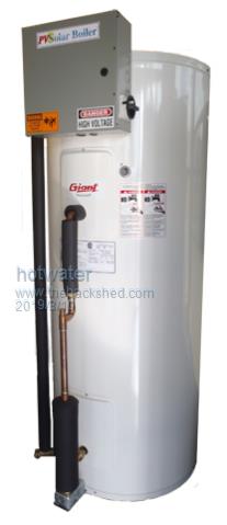

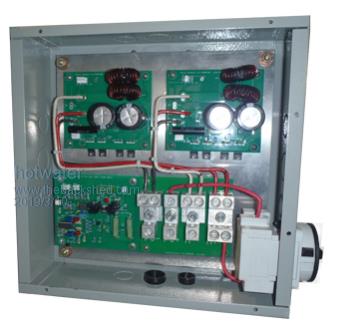

This is an interesting thing I thought about trying to add an extra heater to a tank.
It connects to the lower drain and gravity feeds hot water to the top.
The company I think is Thermo Dynamics of Canada. This is their solar box. At first glance I thought it was a H bridge using two boards. Since all the wire colors connect, in principle it is the same as mine, just double for their higher current version.

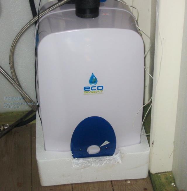

Posted: 06:03pm 09 Mar 2019
This is the water heater I use now with a 1400W 120V element fed by another 10 gallon tank.
Years ago this was the first water heater control using old PC power supply caps. Bubble wrap provided a protective cover and this stayed on the wall for two seasons.

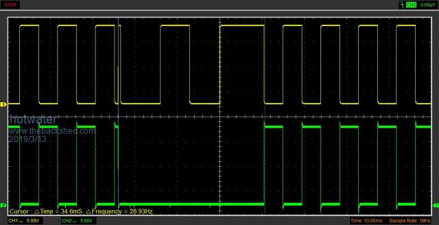

Posted: 01:17pm 13 Mar 2019
This is an example of the regulation. Each output drives two FET in parallel. Notice the skipping of pulses in one channel to lighten load.
Construction is quite simple even without the inverter board and involves very few components. A schematic will follow soon.

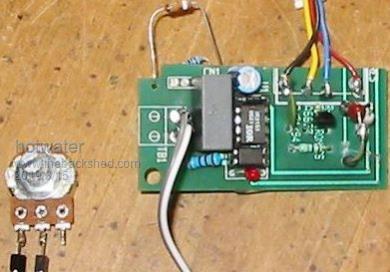

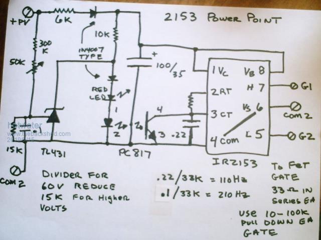

This is the circuit that is fairly easy to build from about a dozen discrete parts. I built one just from an unused circuit board. Anyone better at cad than design is welcome to sell this. Good luck though.

Is the schematic correct around the opto-isolator?

  davef said   Is the schematic correct around the opto-isolator?
Dave, Are you confused about the transistor potentially shorting the oscillator cap? If so, that's the neat hack that shuts the inverter down if the PV Panels go into under voltage (UVLO)
davef
Joined: 14/05/2006
Posts: 499
Posted: 08:11am 16 Mar 2019
  Quote  Dave, Are you confused about the transistor potentially shorting the oscillator cap? If so, that's the neat hack that shuts the inverter down if the PV Panels go into under voltage (UVLO)
No. Is the opto being used as an isolator? If so, I don't see that it is isolating anything. If it is being used as a neat hack then I bow-out.

Parts is parts and pieces is pieces. This is an alternate design that incorporates the 1V LED side for increased "zener" voltage. It also has nice packing density on a board, fits in a 14 pin socket with the 2153, and eliminates a resistor. They are only 8 cents and potentially allows the driver to be placed long distances from the control. My first water heater was 50 feet from the microprocessor controlling it with no ground loops or interference. Prior design had a transistor and resistor for those in a parts desert.
The 2153 automatically shuts down cleanly at about 9V. Internal zener is about 15.5V and oscillator recovers nicely without glitches. The diode with the 6K resistor is optional and is included for those with a penchant to connect things backwards.

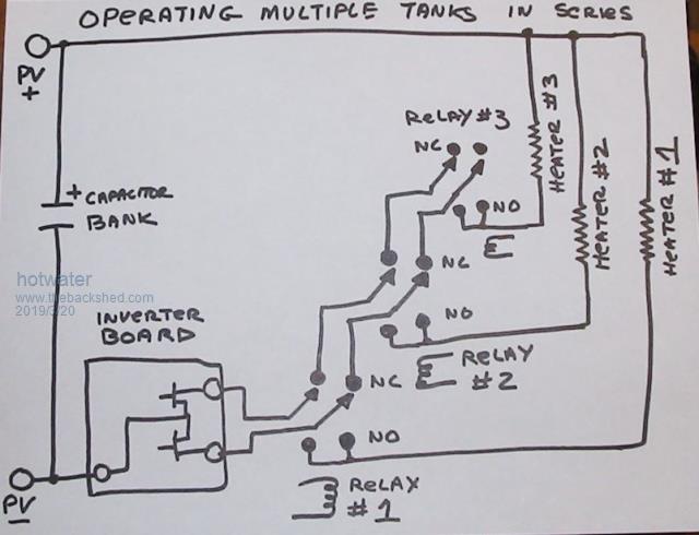

This post discusses a way to switch to multiple heater elements using
common relays with just an AC contact rating. The inverter board has
two FET outputs that alternate. The two FET output does not reduce the
effective on resistance. It does cut the heating of each FET in half.
At full power both FET will alternate on and when paralleled will
essentially be DC. A DPDT relay can switch the two outputs without a
problem of sustained arcing because each output is at 50%. Once passed
thru the relay the outputs can then be connected to a single heater
element. The following is how two or three tanks could connected together.
This would also work for upper and lower heating elements of a tank. Relays
are a simple technology easy to understand. This may be preferred by many.
If I had multiple heating elements, I would likely go to sets of FET
for each heater instead of the relay A microprocessor is preferred
with multiple elements.
I have a dishwasher which is connected in this way using a single relay
at camp. When the dishwasher demands heat, the wires that went to the
heating element go to a 120V AC relay. This provides a set of dry contacts
to the water heater control system to operate the water heater/dishwasher
relay. Dishwasher has priority and relay switches to the dishwasher heating
element.
I use two relays for this because I have to include an off delay. In dry
mode the dishwasher element power must be normally reduced because water
is not cooling it. It is turned on and off in minute intervals to reduce
power when drying to not burn out the element. At lower panel voltages
it must stay on all the time for effective drying. A capacitor on the
gate of the FET forms a RC time constant to keep the FET and relay on
for three minutes. Each heating cycle resets that time and the element
is on continuously.

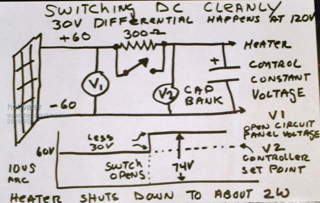

hotwater
Joined: 29/08/2017
Posts: 120
Posted: 06:13pm 20 Mar 2019

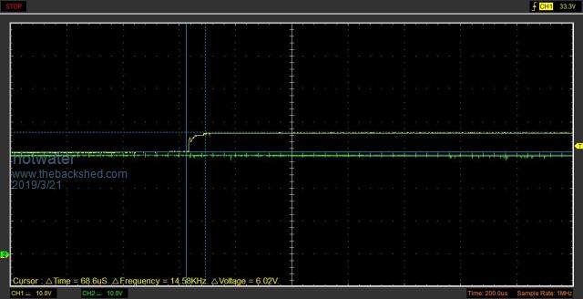

Arcing is an issue when switching over 30V DC. This circuit, in
combination with a controller that keeps the capacitor bank at
a constant voltage, allows using standard water heater thermostat
contacts to switch DC. It only requires that the difference between
the open circuit voltage of the solar array and the MPPT voltage
be less than 30V DC. This can only be done with a heater controller
that keeps the capacitor bank at a constant voltage. The 300 ohm
resistor keeps the capacitor bank charged with a small amount of
current and the controller almost completely shuts down. Heater
draws about 2W in this state.
DO NOT TRY THIS WITH ANY OTHER CIRCUIT THAN THE CONTROLLER SHOWN
Scope image shows a rise in voltage for 60V to 72V when the switch
opens up, a differential of only 12V across the switch. Yellow
trace is the panel voltage. Green is the capacitor bank. Notice
that the green line does not sag at all. Scope voltage needs to
be multiplied by 2 due to voltage divider necessary to prevent
scope overload. This is well under the 30V DC rating of any switch or
relay. The transition takes about 60uS, the majority within 10uS.
No wild spikes are shown and the voltage on the capacitor bank
never drops below 60V DC.

So, is all this added electronics worth it? People will calculate what they think is the ideal resistance for a heater element. Ideal resistance is far from ideal in direct connect. Ideal power happens less than 2 hours a day. Few days have ideal sun unless you live in cloudless AZ. Panels are current sources and below the power point voltage the current is totally dependent on sun intensity. The voltage across the element is the current times the resistance. Voltage is key because power is a function of the square of the voltage. If the voltage drops to half, the power is only 1/4 of what it was. Here is some math using simplified numbers, two grid tie panels for 600W 60V and 10A. Ideal resistance is 6 ohms at 60V for 600W in the absolute best conditions.
At 75% power 7.5A then 6 ohms X 7.5A is 45V and 337W
At 75% power 7.5A for power point 8 ohms X 7.5A is 60V and 450W
At 50% power 5.0A then 6 ohms X 5.0 A is 30V and 150W
At 50% power 5.0A for power point 12 ohms X 5.0A is 60V and 300W
At 25% power 2.5A then 6 ohms X 2.5A is 15V and 37W
At 25% power 2.5A for power point 12 ohms X 2.5A is 60V and 150W
It is a shock to see the effect a fixed resistance has on a solar panel. Do the math for the entire days total power. Solar calculators are available. The eye is log and the solar panel is linear. A small wisp of a cloud can drop the power quite a bit and you won't notice it. Electronics is the only way to harness all the power. A higher resistance in direct connect may overall work better in your conditions if other electronics is not used.
