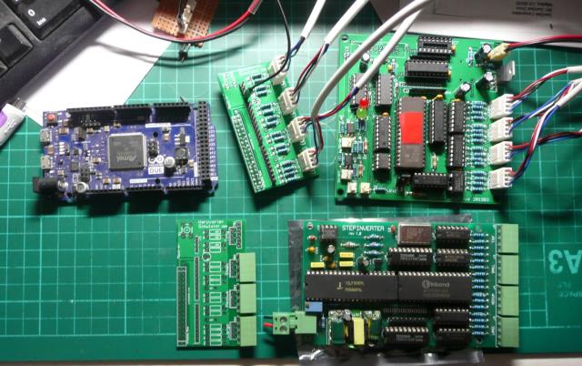

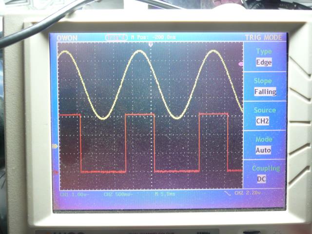

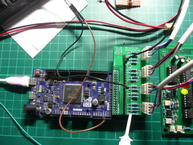

The Warpverter Simulator pcb plugs into the rear connector of the Arduino Due.
The output of DAC0 can be displayed on your Scope.
Press the button and it will grab two frames (50Hz) and output the data from the SerialUSB. (60 Hz is no problem)
The data is in 10 micro-Second intervals.
Details of the project can be found at Warpverter Simulator Github
The PCB takes 4 pin molex connectors (suits me) and 3.81mm Pluggable terminal blocks to suit Tony's boards. Tony's Inverter board is in the bottom half of the photo - mine in the top half.
This is an example of the output data sent by the DUE.
2019-04-15_172702_Warpverter_Simulator_Serial_output.zip
I need 2 pcbs and I'm sending Tony 2. The other 6 are up for grabs.

Posted: 11:50pm 16 Apr 2019
This is an absolute must have for anyone planning to software-ise a Warpverter.
The raw gate drive waveforms by themselves are not really recognisable as a sinewave without having four real bridge inverters, driving four real transformers to combine all the voltage steps at their correct amplitudes and in their correct polarities into a final built up sine wave.
This handy little gadget uses a lookup table to convert the 81 possible mosfet gate drive combinations into an analog output that simulates what a real hardware Warpverter is going to do.
Its very convenient to test and debug programming ideas without needing all the mosfets, heat sinks, electrolytics, and large transformers to monitor the output waveshape and amplitude.
Watch the amplitude seamlessly increase and decrease over a 2:1 voltage range with very low harmonic distortion. And by just plugging in one or more inverter outputs individually in various combinations, you can see how the output waveform progresses from a crude high power rectangular wave, through to a stepped sine wave with ever finer steps and lower distortion.

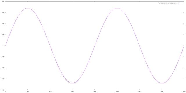

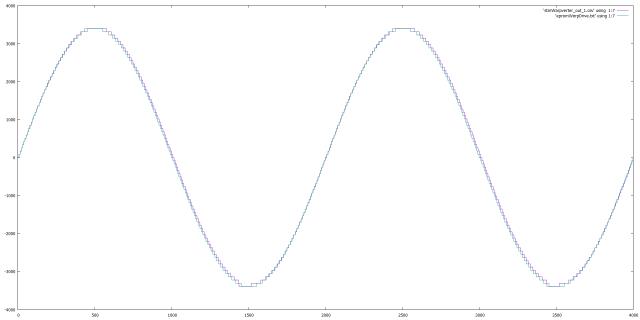

I'm running up the stm32_Warpverter at the moment and feeding it into the simulator. I could notice a little asymmetry at the bottom of the cycle. Feeding the frame data into GNUplot showed it up very well.
Then I loaded the data from both the eprom based inverter and the stm32_Warpverter onto the one chart.
I spent many hours with a logic analyser when I wrote the software to generate the Eprom I use. This is much better
I tried to use OpenOffice Calc charting but I just could not get it right. I don't want to install MS office.
I will use calc to look for DC bias and calculate Distortion, it'd be nice to use the chart as well.
I'll run Tony's Inverter board into the simulator and we'll get another comparison.

Posted: 03:15am 17 Apr 2019
To measure my distortion I used an ancient HP333A distortion analyser.
That is an analog instrument that subtracts the fundamental with a very deep tunable notch filter, and anything remaining is just the harmonic distortion (+noise).
The 333A has an output on the back which is the residual distortion, and you can clearly see on an oscilloscope how much every single step deviates from what should be a perfect sine wave.
Its the ideal tool for locating and fixing the largest lookup table errors.
I generated my mathematical sine wave as just one ninety degree quadrant, then fitted four of those together to create a full 360 degree sine wave. It was not easy to match up the zero crossings and the peaks, but at least any errors end up being symmetrical.
Total harmonic distortion figures I was measuring were about 0.85% with the full 81 steps at minimum dc input voltage, and about 1.8% with half the number of steps at maximum dc input voltage.
On a spectrum analyser each of the harmonics were all below -40db falling away below that at higher harmonics.

mackoffgrid
Joined: 13/03/2017
Posts: 460
Posted: 04:21am 17 Apr 2019
You're right. These little discrepancies are probably negligible compared to both, the area under the curve (its what counts), and what we do after it leaves the processor and into the world of real life electronics and transformers.
Be that as it may, I changed my algorithm so it should be faster and more correct. The evidence.
2019-04-17_142018_stm32_WarpverterV2.zip
I'm happy with that.
Andrew
Posted: 04:36am 17 Apr 2019
Sheer perfection Andrew, well done !
This is a perfect demonstration of the usefulness of Andrew's simulator for anyone wishing to write their own from scratch Warpverter driver software.
If care is taken with getting the transformer turns ratios as close as possible, it is just amazing how four simple square wave inverters can create such a perfect sine wave.
