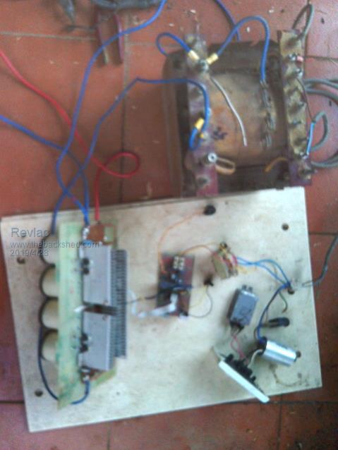

Just thought I would show this, as a bit of experience in learning how these work. Back about Mid 2016.

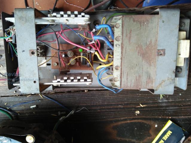

This was my first little inverter attempt/build, and my first practical go at electronics.
It comprised of an old Telecom 48v power supply striped out to just a transformer, then built the circuit using the little SG3524N ic and a couple of fets from an old CRT.
Runs from a 12v battery and will put out (square wave) 240vac and 50Hz either of them adjustable. (can't blow it up easily)
Has been very useful for running small stuff and testing transformers, in fact.
I used it just the other day testing the transformer for the big inverter.
I don't have a Variac so this worked out nicely.

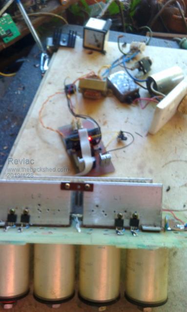

EGS002 inverter build
This is just a ratsnest so I can see how everything works using an EI tranny.
The First time I fired this thing up, a big red spark flew out of the bridge... disconnected the battery power, and had a good look and could not find any damage, checked the caps and still some charge in them, so no short.
OK, powered it up again and the damn thing just works, set the voltage to 235v all good.
I have run various loads, water pump, small air con, large angle grinder, large fan and a freezer without a choke, the current draw (efficiency) was terrible.
But I must say when running with a choke the results where looking pretty good for average loads.
Had switched it on and off many times, trying different things, Had a friend was going to come over, and thought I would try it again before he arrived so he could see it working, this time I flicked the switch on and BANG, I was peppered with bits of fets.
It was at this stage it was suggested to me by a friend from the Forum that I should invest in a CRO/oscilloscope, and so I did, best bit of advice for fault finding after blowing up the fets and drivers.
It was a good experience to prove to myself it works, and at initial cost of getting it running was about $20 worth of parts, the rest of it was just junk, the power board was just a piece of fibreglass and some copper strap, the control board was a home etch pcb.
It was some time ago when I tested this, and haven't done anymore with it after blowing up a few fets and the 002 board.

Those heatsinks look like they came from an old EGA monitor ? I think I have also seen them in some older PC power supplies?Edited by wiseguy 2019-05-01

Mike. That's exactly where those heat sinks come from, I have striped down a few of those monitors and computer PSU for parts, rather than let them go for E-Waste.
