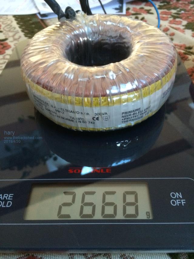

I found a small toroid 230V/12.6V 300VA transformer that weight 2.6kg with copper wiring (if that information is of any use).
As I'm planning to make a small DC24V/AC230V inverter, I think the secondary and primary are very close to what is needed for my need.
What do youthink and what power inverter can I expect from this transformer ?

I had a little under 20 them just about the same size as yours
I gave a few of them to friends
And a few of the other ones I unwrapped and made a bigger toroid
I've been told by some of the greats on here that wire size has the largest part in how many watts you can get out of a transformer
With that being said most Transformers ratings in watts are a little under the VA
if I had to guess and by the way there's a lot better people on here to guess
I'm guessing 250 watts
I've had people on here tell me all about my Transformer with just a picture no info
And it would be very very close
If you can get your hands on a few more of these you can unwind them
and make you a big Transformer with a big hole in the center for big wire

Hi BenandAmber.
Unfortunately? I've only 1.
But for my first project attempting to make an inverter (little chinese EGS002/powerboard just ordered), I think it is the right candidate.
What about the winding ? I think 12.6V/230V is ok for a DC24V/AC230V inverter. Maybe I don't even need to touch anything at the winding part.
If the inverter is a success, it would be perfect for my little 120W fridge !
I need to find some bigger ones, but have no source and no idea where to get them from at the moment.

Just thinking out in public (should be a law against it), I think
the 24V DC supply will mean 24 x 0.707 = 17V AC RMS maximum will come out of the inverter board.
This transformer has a 12.6V winding and the 12.6V is read by me as 12.6 V AC RMS.
This transformer will work perfectly fine, with the EGS002 controlled inverter board.
At 230V AC output, I expect the PWM modulation duty percent to be about
12.9/17 or 75% from the 24V DC supply. I aim for 80% at normal operating conditions.
300VA is not big, but good enough to test things and learn.
The transformer is ideal.

Poida is quite correct I have been using a 230V - 12.6V (actually 2 x 6,3V) toroid for my recent 250W inverter playing and it works fine. I found a 1U 250VAC capacitor was the best choice for the secondary.
With no load I get around 0.2 - 0.3A idling current. Ideally a toroid secondary of 7.5V for me or 15V for you would probably have been better but only marginally.

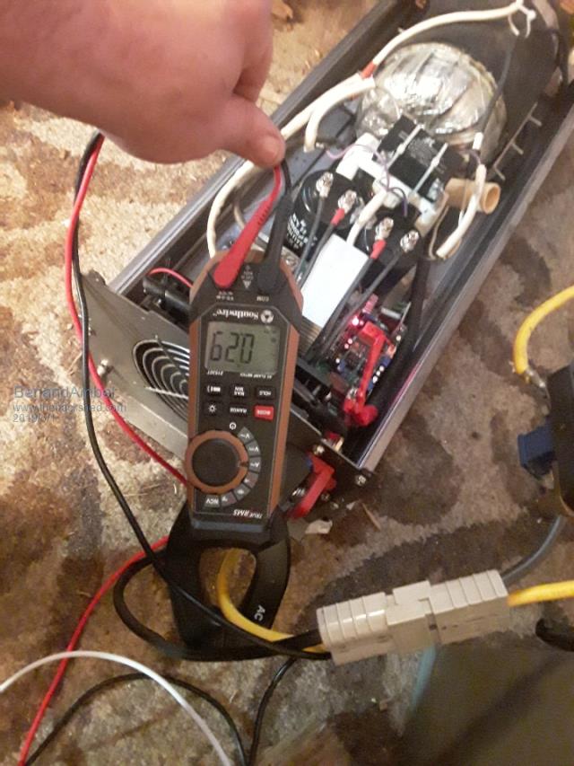

I'm curious to what kind of inverter board he ordered

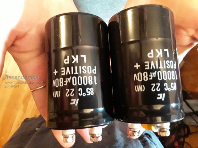

I've been using the heck out of this little four mosfet inverter I have
thanks poida
I ran a small air conditioner about 2 hour couple days ago that's along with a chop saw occasionally circlesaw occasionally Sawzall occasionally
I put two big caps in mine
How long it'll last before it goes pop I don't know but I am surely impressed with it so far
He's already been schooled by the experts
But they are very careful what they say with good reason of course
I think it's got a good chance of starting that fridge take in mind who's saying it though
