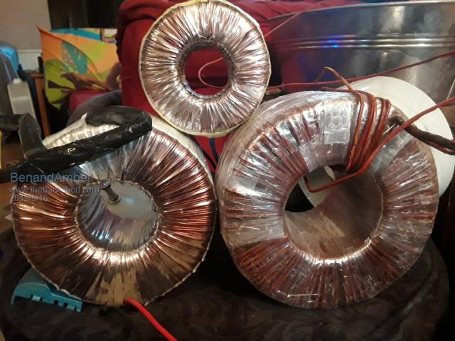

Here's a pic of the one I built out of little ones I've only got one layer of the winding on it so far 44 turns
It's the one on the right
The little Transformer on top is a lot like the ones I built it out of
The one on the left is out of a 8000 watt power jack so who knows what the wattage is on it
If you guys need big toroidal ferrite for chokes
Take a look at my big choke post the guy wants $31 a piece but I gave him the 41 for 2

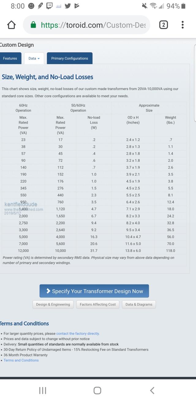

  kentfielddude said   I currently talking with toroid.com. what size core do you think will be best?
WONDERFUL!
Please keep us posted with the cost, tax, s&h, insurance.
The table looks pretty exhaustive I think.
Personally I would look for the last two to power a family home. Our energy needs are 400kWh/month with 5kWh peaks
The figures they give are nominal for a typical commercial design run at fairly high design flux density, which is fair enough.
For an inverter, we would use a much lower design flux density by using a higher turns count. That forces us to use slightly thinner gauge wire, which reduces the maximum continuous power rating.
But we win hugely by having a far lower idling power than they specify on that chart.
The largest size would be ideal for 5Kw to 7Kw continuous 24 hour rating, and multiples of that for short surges.

  Warpspeed said  The largest size would be ideal for 5Kw to 7Kw continuous 24 hour rating, and multiples of that for short surges.
Thank you Tony!
1. By the largest size, did you mean the 118lb 10kWh rated core?
2. In the warpverter, how does the idling power distribute across each inverter stage? If it helps simplify things, you don't have to generalize and you can quote numbers just for your own build(s)
