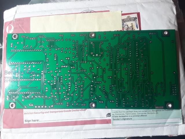

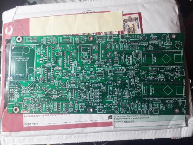

Got my Nano control boards in today
thank you much poida the great
They look absolutely perfect in every way
As you can see every last bit of the board was used
It looks like all the component values are on the board
That should make it a lot easier for someone like me to put it together
I'm so excited and overwhelmed at the same time
I've never done anything like this before
I do have a few questions
Is there a list of all the components somewhere that I can copy to make sure that I don't forget anything
And I've heard that there are a few different versions of the Nano is there a certain one I need to buy
And will I need to buy something to program the Nanos
I sure hope I'm not in over my head
I got a lot of determination and I want this really bad
Happy happy joy joy so excited
tinyt
Joined: 12/11/2017
Posts: 564
Posted: 02:35am 30 May 2019
The zip file posted here has a Bill of Materials.
Make sure you read all the notes in the schematic. I think those who have running units are using the IR21844 driver chips. They might also help you pick the version of the nano module.
BenandAmber
Joined: 16/02/2019
Posts: 961
Posted: 03:08am 30 May 2019
Thanks tiny T I really appreciate it
renewableMark
Joined: 09/12/2017
Posts: 1679
Posted: 06:40am 30 May 2019
Ben you load the sketches/programme onto the nano via a USB cable from your computer.
The arduino software is a free download here
The sketches are in the nano thread.
BTW you don't need all the bits on the board if you don't plan to sync with another source etc.Edited by renewableMark 2019-05-31
Cheers Caveman Mark
Off grid eastern Melb
BenandAmber
Joined: 16/02/2019
Posts: 961
Posted: 07:15am 30 May 2019
Thanks renewable mark
I will never be syncing it to another source so how do I know the bits that don't need
I didn't see a charging function but I won't ever be using that if it does have one either
I want to order parts as soon as possible pretty excited about this
Edited by BenandAmber 2019-05-31
poida
Joined: 02/02/2017
Posts: 1510
Posted: 09:12am 30 May 2019
B & A, a couple of things.
Sockets for both nanos, and both IR21844 driver ICs.
Buy good quality 7805 and 7812 regulators. RenewableMark has had problems with the regulators on his board. I would use the USA suppliers such as Fry's or Digikey or whatever for these parts.
No need for the RS-232 support, nor mains sync. We can help with which parts need to be present for the board to work.
putting the firmware into the nanos is not too hard. Sometimes there is a trick, just ask me here.
Just about all you see on the board are resistors, capacitors and about 8 transistors.
And the board was of a type that Mark and I agreed on how easy it was to solder.
A fine tip on the soldering iron, some 0.5 or 0.7mm flux core 64/40 and you will be fine.Edited by poida 2019-05-31

Does this board take a small transformer for the voltage feedback

You'll need an isolated transformer from your secondary output which will plug into the 2 pin socket VFB.
Don't forget to fit and solder all the small parts first like resistors and diodes.
It's a pretty tight layout so that makes it easier for access when assembling/soldering.Edited by renewableMark 2019-06-01

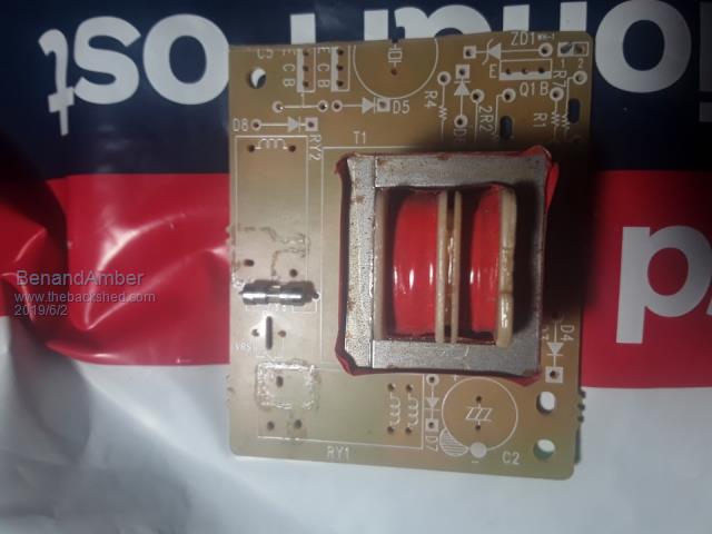

This is part of a air conditioner control board the little Transformer puts out 12 volts
I was thinking about using it four voltage feedback I put a little 1 amp fuse in there just in case

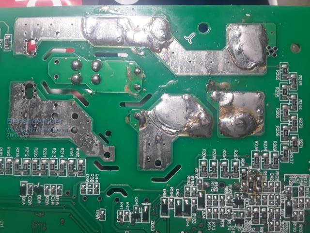

This is the control board out of the Power Jack 8000 watt inverter
I'm building this control board for
It looks to me like one side of the AC output goes through that little Transformer
If I'm not wrong about this then this is just nuts
The only reason I was looking at it again was to maybe Rob the little heatsink off of it
There's nothing wrong with this control board besides it being 230-volt and it being a power jack poor designEdited by BenandAmber 2019-06-03
