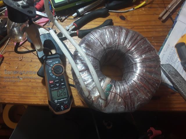

This Transformer is the one that I made out of several small ones
I unwound all the small ones and rewound this bigger one on a sewer pipe as a form for the center

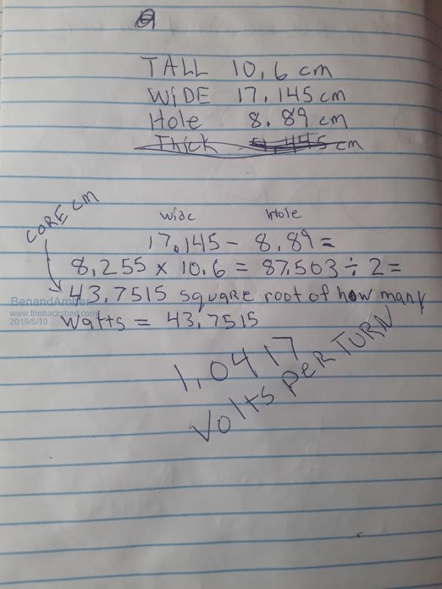

Here is the chicken scratch on it
I fired it up with a light bulb no low side primary on it yet
The clamp meter said 0.37 amps
Me and another friend on here thought this was really high
So I found a scrap piece of wire and wrapped nine more turns on it just to see what would happen
Here are the results
Okay this looks a little better
The problem is I thought I already overwound it
I'm pretty sure the first layer was 86 second layer was 70 or somewhere real close to that
Every time I've used this formula for calculating how many turns I add about another 10 turns and works out great
Normally I would have put about 130 turns on this Transformer with this calculation
I didn't want to unwind and spread the wire out evenly
so I just kept winding until I filled up the second layer
I need to get some of that good wisdom that comes from this form so I can wrap my head around this
Thank you guys in advance for your help
I'm so indecisive anymore that you guys just don't know how big of a help you truly are
God bless all of you

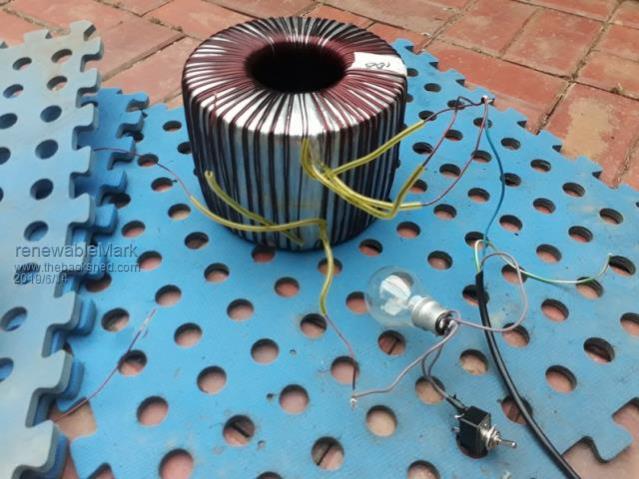

Ben, when I have wound toroids, I wound the secondary (240v output) with 2mm2 wire.
To get the amp rating up 4 secondary winding's got used.
And the output of each one got paralleled.
Fortunately all 128 windings fitted on one layer, so it ended up with 4 neat layers of 4 secondary windings all exactly the same number of turns.
Each secondary had exactly the same number of turns, (128 secondaries to suit 240v)
That toroid ended up with 14 turns for the primary(48vdc) winding.
That is the idea of doing the light bulb test for soft start and making sure the voltages across the loose ends are the same before you solder them together.
This is the instructions from Oz I went by to wind my toroids.

Hi Ben,
Try plugging the numbers into a flux calculator like this one:
https://www.daycounter.com/Calculators/Max-Flux-Density-Calculator.phtml
Your numbers work out to 12,100 Gauss or 1.21 Teslas in metric.
If I was doing this, I would design for 1.0 Tesla which would require 188 Turns.
voltage 220v
Frequency .00006 Mhz (60Hz)
Turns 188
Area 43.75 cm sq
Flux density 10,040 Gauss
That will give a substantial drop to the idling power and any inrush surge.

I wound 10 more turns to the 9 turns I wound previously and got it down to .21
so for 10 turns I got .04 more reduction
Seems like diminishing returns to me

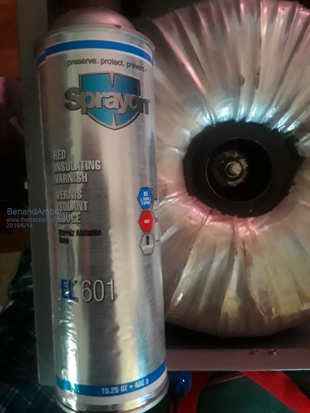

I epoxy it and then wound two layers of Transformer tape
then wound my second layer epoxy it and then wound 2 layers of Transformer tape

Lets see. Hole diameter 88.9mm, circumference about 279mm.
In theory about 139 turns of 2mm wide wire should fit onto the first layer, and six less (133 turns) on a second layer, and 127 turns on a third layer.
You will never get that, but lets assume three layers with about 110 turns on each layer should be a very easy fit.
So we plug the numbers into the flux calculator.
Volts 120
Frequency 0.00006Mhz
Turns 110
Area 43.75cm
Flux 9,360 Gauss (0.93 Teslas)
2mm x 2mm rectangular copper = 4mm sq about 16 amps per layer.
Three layers 48 amps at 120v = 5.76 Kw.
Three layers of 2mm wire might take up about 9mm, or reduce the hole size by 18mm leaving probably about a 70mm hole for the primary, which should be plenty.

Me and a good friend on here has been talking back and forth
We have decided to run with this homemade Transformer and see how it goes
most likely it will have really high idle current
It likely has a shorted turn
I was very careful make sure this did not happen
I re enameled The Wire
And I also epoxied it
When building this it seems like it should have used a lot more silicon Steel
For the size of the toroid that it made
It also took a lot more turns than I was expecting ( probably shorted)
The wire was in horrible shape that's why I re-enamel it
If I do find out that it has a shorted turn
I will probably rewind it with new wire
There will be a teardown if idle current is unacceptable

Are you shorting out the light bulb after the soft start?
You should have a switch fitted across the bulb terminals.
Have it open to do the soft start, then close/short the switch to eliminate that from the circuit.
BE CAREFUL DOING THIS, VERY EASY TO ZAP YOURSELF.Edited by renewableMark 2019-06-15
