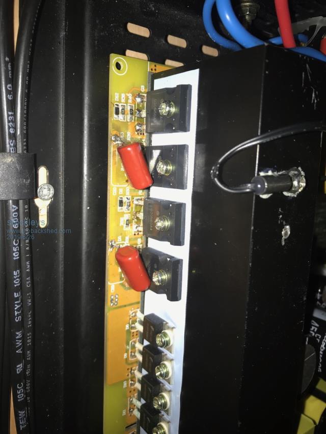

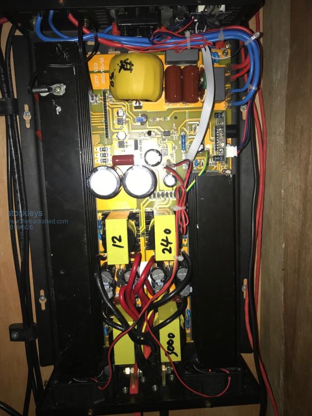

hi all
i have a 3000w hf inverter that i am trying to repair.
i bought it as possible faulty.
it was, replaced 2 igbts and 1 mosfet and all was good for 3 weeks solid. powered everything i threw at it.
the trouble started when i switched it off to mount it on the wall.
switched it back on... no output. 2 shorted igbts.
replaced these, pop. all 4 this time.
got a replacement spwm board from the manufacturer and replacement resistors and diodes. switched on, no output, then bang, a gate driver exploded on the spwm board.
so i thought i would try an egs002. popped it in, switch it on, no output but the transformers would buzz for 3 seconds, then stop then try again.
no shorted igbts and resistors and diodes tested good. so i bought a usb scope. the egs003 had 1 bad pwm output and 1 band spwm output. so i bought yet another, popped it on the scope, before putting it in the inverter, all seamed good. out it in and ..... nothing. 2 more shorted igbts. WHY? i had a good reading on the scope.
the igbts are the same as supplied from factory. the pinout on the egs002 is the same as the factory one. where am i going wrong? everything replaced with new but it still keeps going bang (never a load connected i will add).
oh and the dc-dc side has always had a good steady 390v dc supplied to the igbts.
any thoughts?
thanks in advance

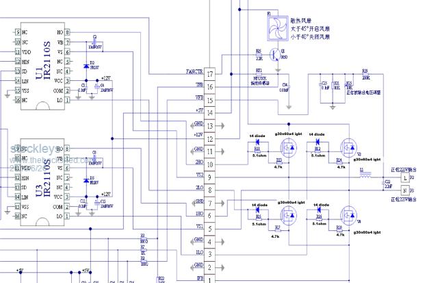

I wish there is a model number. Better still there are pictures and some sort of reversed schematics to help me understand.Edited by tinyt 2019-06-27
stockleys
Joined: 21/06/2019
Posts: 54
Posted: 06:59pm 25 Jun 2019
The manufacturer won’t release the schematic. But the dc-ac side is exactly the same as supplied in the egs002 manual bar a few slight differences in resistors values
It’s a reliable 3000w. 12v 50hz 230v

I don’t know why they keep blowing. Like I said, everything between the egs002 and the output has been replaced like for like. Apart from I used IGBT’s that have an extra 15a capacity. Bringing them to 75a. Rather than the factory 60a. These 75a IGBT’s worked great for 3 weeks until I switched it off for 20 mins to mount it on the wall.
The dc-dc side works flawless. Steady 390v dc at the rectifier
The egs002 is getting 12.36v. And 5.07v consistently.
There is no load connected to the output
What could possibly be causing the shoot through? When every component has been replace with like for like.
I am contemplating the LF route but I won’t be in a financiall position to do this for months now.
Would this transformer do the job? https://www.ebay.co.uk/itm/Toroidal-power-transformer-3KVA-240v-0-7-5v-x-4-400A-or-0-15v-200-amps-PSU/123672682927?hash= item1ccb7761af:g:69cAAOSwpHtce51Q
I would prefer to get my current inverter working though. As it’s a clean, tidy unit taking up little space in what is already a cramp 1 bed bungalow with 2 adults and a new born

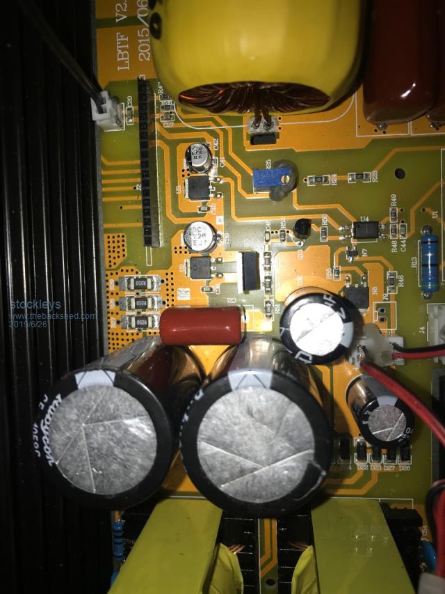

the schematic i upoaded was taken from the egs002 manual but i modified the diodes and resistors to match my inverter. the only thing not shown on it are the 2 capacitors by the igbt,s.
please ignore the poor soldering, i need a new tip for my soldering iron due to replacing soo many igbt's

  stockleys said   the schematic i upoaded was taken from the egs002 manual but i modified the diodes and resistors to match my inverter. the only thing not shown on it are the 2 capacitors by the igbt,s.
If the schematic is from fig 2-1 of the egs002 manual, there is a 0.1 ohms resistor (r24). Maybe it is also damaged.
Also, I think there is a mod on the egs002 board that removes the LM393. Maybe it also applies to this inverter.
