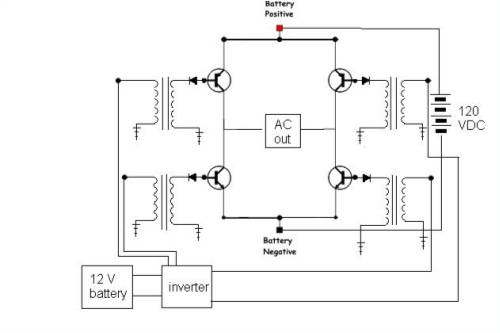

Thanks for your reply. I am not a very good artist, especially when using paint.
This is the circuit I envision. Am I on the right track? Any changes I need to make?
philb
oztules
Joined: 26/07/2007
Posts: 1686
Posted: 01:00am 20 Jul 2008
Good start, but no. The transformers need to be synched, the diodes can go, the trannies are wrong, but the concept is good.

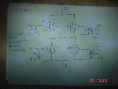

Yes Robb is correct, and that I had previously envisioned this arrangement. However, a multi-kilowatt inverter is expensive.
The el cheapo inverter is only to supply a steady referenced 60hz with an appropriate waveform. This saves us designing that whole part. We now only have to switch our supplied hv dc. The elcheapo will also provide a low impedance driver.
For my first go I would use something like this Philb:
It should be that simple to get it going. Note that 2 of the driver transformers are inverted from the other two.
This means a positive going waveform will turn on two of the fets, while reverse biasing the other two. When the wave front changes, the opposite happens. It's apparently that simple. I can't recall if Fanman used fets or igbt's.
But 200A 1200v IBGT's should get you on track I suspect.
Perhaps see if you can get hold of Fanman.
If you have just square wave 115vdc may do, if you have modified sine, perhaps closer to 160v dc. You can find this out by measuring the hvdc in the converter itself and trying that voltage.
I must admit, it does look simple
..........oztules

Not sure I'd just drive them with transformers. You realy want to switch them clean and sharp or else your going to be disipating loads of power and let the smoke out .
You'd at least need something like Schmitt triggers to square it all up.
Now if you want pure sine wave it all gets a lot more complicated........Edited by Robb 2008-07-21

Robb ,
We are switching at only 60hz. The turn on time versus the on time is quite stark. They spend very little time turning on as a percent of the cycle.
At this frequency we are clean and sharp.
For pure sine, I think d class would be the best, but not needed for this.

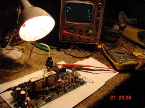

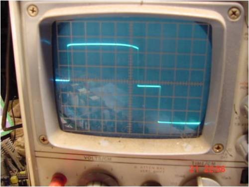

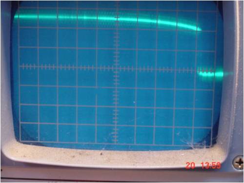

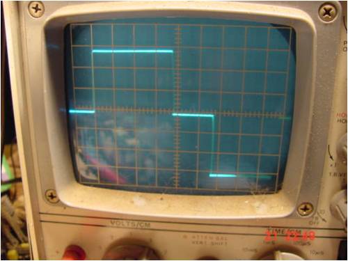

You got me thinking so I went out to the shed and mocked up an old inverter I had, a small transformer and my mouldy old CRO.
It surprised even me. My scope performs really really badly at low frequency, and is difficult to photo as it blinks at low freq. However, I was able to stretch the half wave so we could see how fast the rise time was compared to plateau.
It is much quicker than even I thought
The trailing edge of the wave falls off, but still over 12v, then drops like a rock as well.
Looks like a zener or two might be all thats needed to clip the waveform , peel off the superimposed switching noise, have a very fast wave front, and protect the gate from too much drive. This is 10v/division. Plenty left to clip.
This was from this (pictured) converter through a little 14v? transformer. I expected some hysterisis to show up, but it is not obvious.
I don't think we need the schmitt triggers, just a clipper.
Thanks for making me look at it.
.........oztulesEdited by oztules 2008-07-21

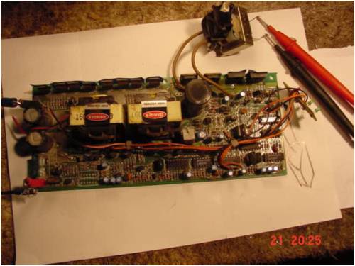

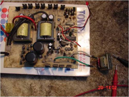

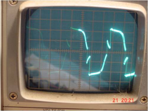

I had found this at the tip some time ago, and for no apparent reason decided to fix it today
The fault was in the high side driver transistor and a few other components and 2 of the H bridge fets... so what I hear you say....

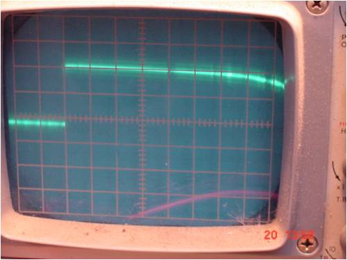

well on getting it going, I decided to try the scope on the output with the transformer like yesterday...oops.
look at this:
So it would appear that in this case you are right. A schmitt to shape the wave may be in order in this case.
It is an older American one, analogue not micro, soft start etc etc. about 1000w. This picture is of it running the light, as it needed a load to run. It had auto sensing as well.
So not all inverters are created equal. Note the scope in the last picture, it was in the dark part of the blink. These old cro's are not so good at low freq.
..........oztules

Damn,
The transformer was at fault. I measured the output on the scope at the 240v primary side with a 90k voltage divider across the 240v. 50v/division and it looked like this:
Then replaced the transformer with another and scoped the secondary 10v/division... and it looked like this :
So we don't need the schmitts yet from the looks of it. There is some small drop off but not enough to give any problem at all. Don't understand how it is so different. The tiny transformer skewed the result awfully. The slightly larger one worked beautifully. I've run pwm dc controllers with worse waveforms than that.
Perhaps next time I will test it a bit more thoroughly
