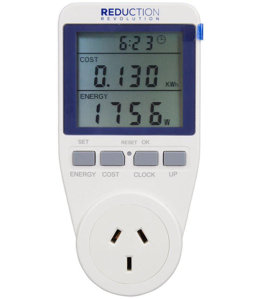

Posted: 06:47am 23 Oct 2019
  Quote   That makes sense. My main aim is to reduce my power bill (as much as possible) without going crazy  ...  so I'm quite happy to use the grid as back-up.
Probably the very first step is to do a complete power audit. Know how much power each appliance uses each 24 hours.
There are going to be some real eye popping revelations.
Something like this perhaps, available from e-bay and retail stores:

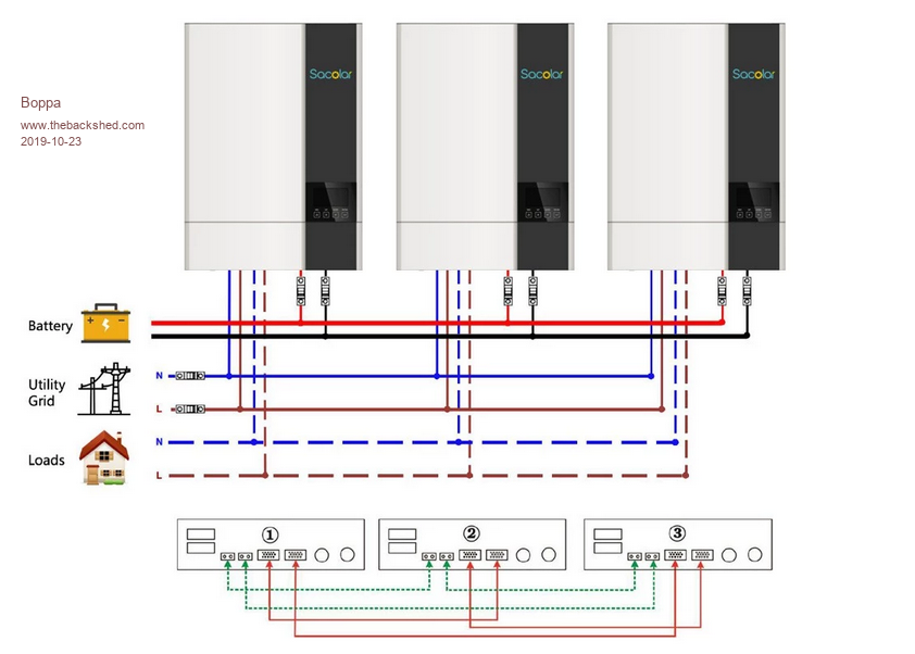

Boppa
Joined: 08/11/2016
Posts: 816
Posted: 11:39am 23 Oct 2019
Don't even need to reconfigure the panels these days, there are quite a few offgrid inverters going the HV  panel voltage route
This is one example of these kind of inverters (can run as gridtie, gridtie with battery backup, or straight battery power)
MPPT ranges 120V~450V,  Voc 500V
Input / Output Voltage DC 48V / AC 220V~240V
Plus you can parallel them as well to get more capacity
Not recommending this particular brand or anything, just that they are certainly out there...

As you go through the interesting process of measuring the actual power usage of every appliance, you will discover that its not the really big short term loads that are costing you.  Its the small things that run continuously for 24 hours that really add up.
