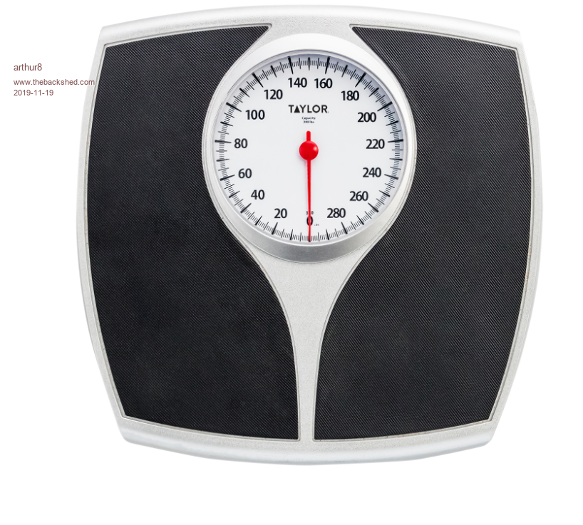

How much gas is left in a cylinder is easy.
Sit the cylinder on some bathroom scales. The cylinder will have stamped on it the weight empty, and the weight when full.
If you want some kind of warning when the gas gets low, a mechanical scale could be pretty easily adapted to do that.

Check gas available, by weighing the cylinder .
Both very good ideas. I will try with this servo motor (already had it): https://www.ebay.com/itm/MG90S-Metal-Gear-High-Speed-Micro-Servo-Motor-for-RC-Car-Helicopter-Plane/183889883172?ssPageName=STRK%3AMEBIDX%3AIT&_trksid=p2057872.m2749.l2649
The mechanical scale idea is very good, i will try to find any cheap one.

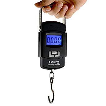

That e-bay strain gauge sensor will only output a few millivolts, its going to require a strain gauge amplifier to amplify up that signal up to something usable with an Arduino.
Another way to do it would be to hang the cylinder from a digital spring scale.

Posted: 06:24am 19 Nov 2019
  Warpspeed said  That e-bay strain gauge sensor will only output a few millivolts, its going to require a strain gauge amplifier to amplify up that signal up to something usable with an Arduino.
That's bad. Still don't know a cheap & reliable way to import the Kg value on Arduino.
Maybe this?
I can put a small sensor on the gauge so i can have alarms when the GLP is low.
