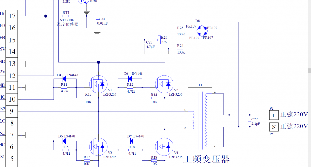

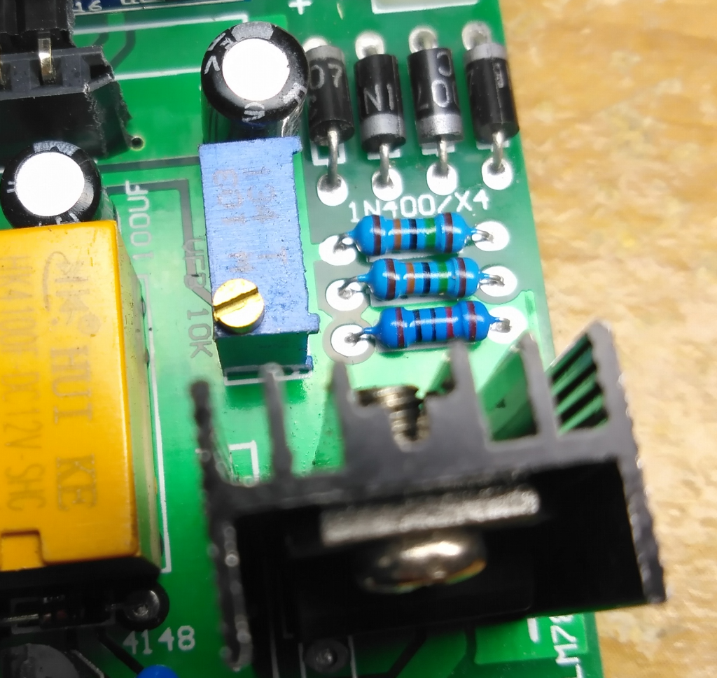

What I'm concerned about is the feedback loop.  I live in an area that uses 120v power not 220-240v.  Since I plan to wind my own toroid transformer for the output I'm trying to decide how to handle this.  After doing some more searching on here and a few other places it seems that the board's circuit is one of the reference circuits on the EG8010 reference sheet.  If so, and if I'm reading the schematic correcty, the feedback circuit uses a resistor voltage divider to bring the voltage down to the range the EGS002 expects to see.  Could someone with more knowledge of schematic reading and this board confirm this?  If it is indeed just a voltage divider, I see two possible paths to proceed:
a) swap the resistor values to appropriate ones so the control board sees the right voltage range.  If so, resistor value suggestions requested.  Alternatively,
b) wind a another coil on the toroid to provide the voltage the board expects to see.  The toroid I plan to buy has a spec sheet with it that includes volts per turn so wiring another coil to the correct voltage would not be an issue.

You are correct with it is a simple voltage divider, i would assume all things equal,  simply double the already fitted resistor values aka, the feedback transformer will output 12v at 240v so it will only be 6v at 110v etc.
You could also wind a 12v feedback winding on your current transformer and feed that into the feedback bridge rectifier ...

Hey noneyabussiness thank you for the quick response!
I am a bit confused though.  There is no feedback transformer on the board, nor is there one in the reference circuit that (I think) they are using.  After the bridge there are 3 resistors but no transformer:
I looked at the colour codes and with my tired eyes they dont match what I have.  I'll have to break out the multimeter when I get home from work tomorrow to confirm.

So I re-read the thread I linked above and on page 3 BenandAmber discuss the resistor values they changed but I can't follow it.  I'd appreciate it if someone can clarify which resistors they changed.  At first I thought they changed the trimpot to 40k but that may not be the case.

Based on BenandAmber's thread and your picture, the top resistor is 150K, the middle resistor is 150K, and the bottom resistor is 10k. The trimpot looks like 10Kohms in rheostat configuration (the wiper is connected to one of its outer terminals). This 10K rheostat is connected in parallel to the 10K resistor. So, these components are not connected exactly like those in the EGS002 data sheet shown earlier. The connection is:
Bridge + -> 150K +->   10K     +-> 150K -> - Bridge
   EGS002 (15) <-+-> 10K pot <-+-> System Ground
Assuming that the trimpot wiper is set for maximum rheostat resistance of 10K, the total resistance across the bridge is 150K + 5K + 150K or 305000 ohms (5K came from the two 10Ks in parallel). For a 220V configuration, the current through the resistors is roughly 220/305000 = 0.000721A. Assuming that the two 150K resistors are very close to each other in value, the voltage across the pot set at 10K and the 10K resistor will be. 0.000721 x 5000 = 3.6V(roughly). This will roughly be the voltage at EGS002 pin 15 (or EG8010 VFB). Note that I am using Excel to do the calculations.
The voltage feedback limit of the EG8010 that is used on the EGS002 is 2.75V thru 3.15V. So, the 3.6V maximum that the trimpot can be set is just slightly higher to the 3.15 limit (EG8010 VFB max limit).
For 120V configuration:
If the 10K resistor is changed to 39K per BenandAmber's thread, VFB max from the trimpot will be 3.10V.
If the 10K resistor is changed to 47K, VFB max from the trimpot will be 3.21V.
If the 10K resistor is changed to 100K, VFB max from the trimpot will be 3.53V.
I think you can change the 10K to any value from 47K thru 100K. And if you set the trimpot so that VFB is within the limits, you are good to go.

My goodness tinyt!  Thank you so much for such a concise, clear explanation.  I was looking at the circuit board and I agree with your assessment of the resistor values, but it didn't make sense what they were doing.  That makes it very clear and helps out a ton.
I just got in from work so I am going to eat some food and then play with the board using my meter just for the fun of it and get more familiar with it.
