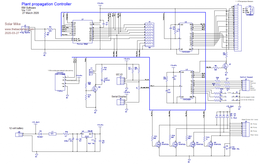

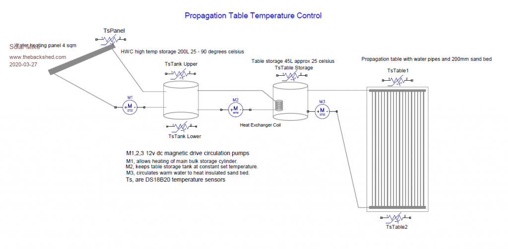

We want to build a tunnel house with a heated propagation table for striking plant cuttings, as the site is totally off grid and I don't want to consume battery storage energy for heating, figured hot water storage would be a good option and easily build by DIY. So the 200L copper open vented low pressure hot water cylinder taking up space in my garage may be put to good use. I built solar hot water panels for our house approx 10 years ago and have enough stuff left over to make a suitable panel approx 4 sqm, this should be enough to heat up a 200L cylinder quite quickly, when the sun is shining. The HWC still has its element, another option is to get about 4Kw of PV panels and dump that energy into the element, may be easier than building a water heating panel.
Here is a rough block drawing:
The main HWC tank will be heated as high as possible around 90c, water from this tank will heat a small insulated tank via a copper coil heat exchanger to approx 10 degrees hotter that the propagation table requires; 12 vdc magnetic drive pump M3 circulates the warm water through rubber tubing in a thick sand bed sitting within a thick polystyrene layer. Plant pots sit on this and are warmed by the heated sand, drip pot irrigation is tightly controlled so watering doesn't loose too much heat.
This is not going to work well in the dead of winter, but any sun at all will be of help to raise the root temperatures in cooler periods (mornings, night) either side of the winter months.
Here is the schematic, uses a Picaxe 20M2, monitoring is by either by serial or I2c LCD display, with a connection to our supervisory 1-wire network. DS18b20 temperature sensors and the small keypad are multiplexed by transmission gates, speed isn't required here.
Mike

I can barely see let alone understand your schematic Mike but it's certainly over my head.

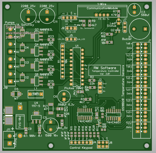

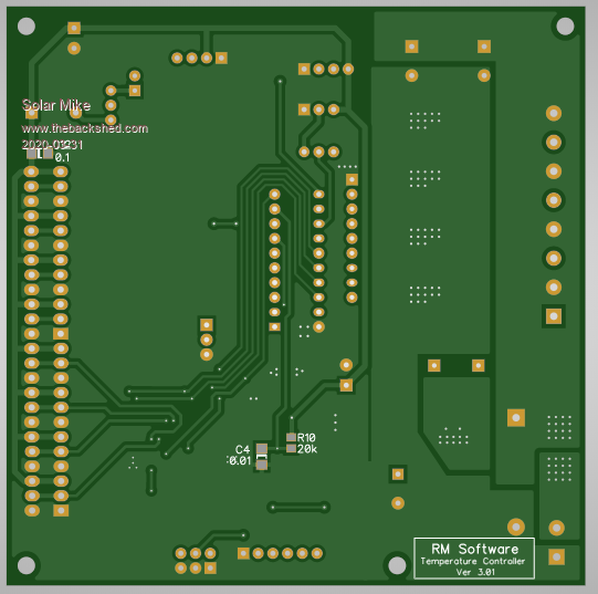

Here is the pcb layout, 100x100mm size.
Specs: 8 x 18DSB20 inputs, 4 x mosfet 4 amp outputs, 1 x I2c or Serial LCD output, 1 x beeper.
Can be used for any generic temperature control applications, however I will be using it to control 3 x 12 vdc magnetic drive pumps, 1 x water solenoid valve and 6 x temperature control sensors.
Will send off the gerbers, last lot took 1 month to get back by airmail post.
Mike

Anyway, nice circuit.
Cheers Aaron
