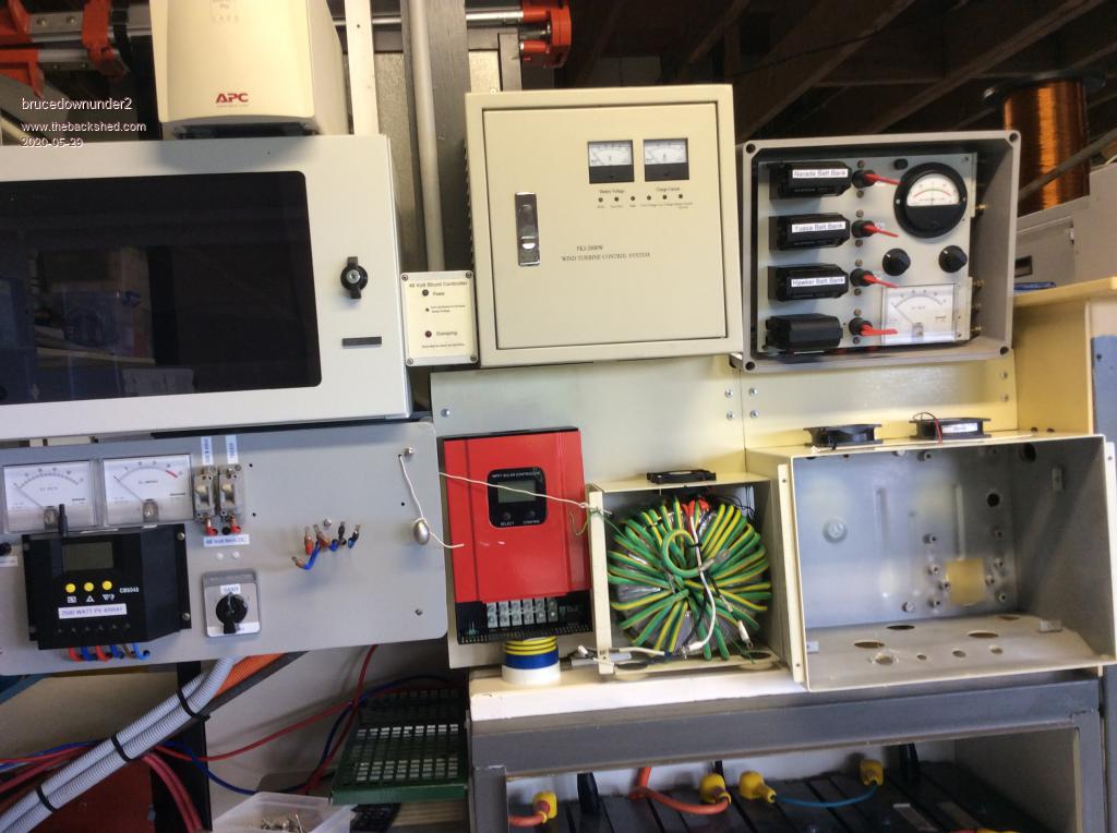

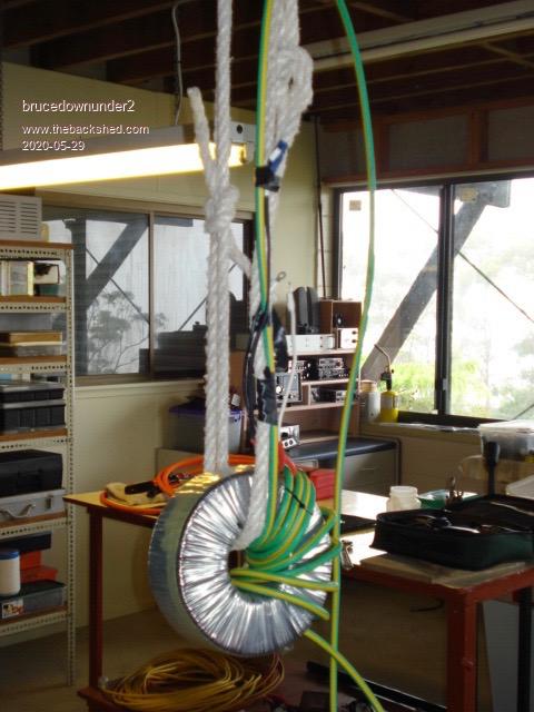

Here's a pic of my rewound Torodial, with 25mm Aussie earth wire. It's the hard drawn copper 7strand stuff that is very stiff on the fingers to wind to the tight corners.  I think I managed 31 turns on the Inspire core, would not try it again . I'd go multi strand ,like welding cable or many strands of enallemed transformer wire.
 Mine is 48 volt, I think I ended up with around 20 something watts idle.

Posted: 02:36am 29 May 2020
Yes you need a good setup for winding toroids.

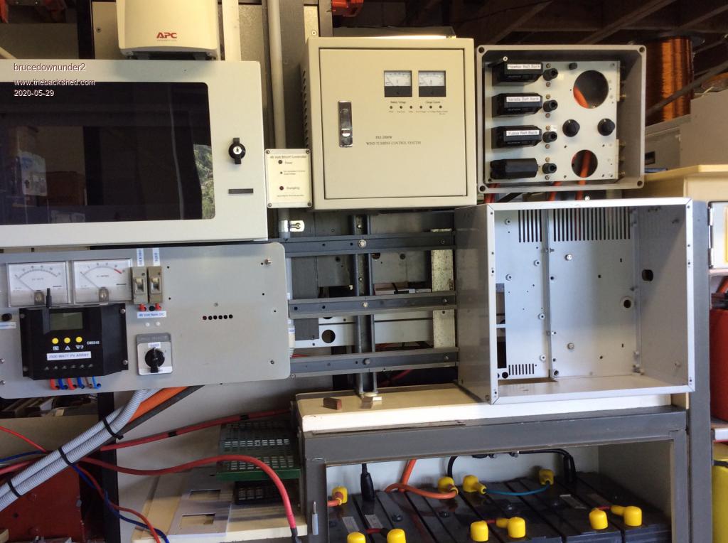

Stocky. and Tony,plus others,,
 I gutted an inspire case ,, but decided it was going to be too tight a fit for the Inspire Toroidal
 wound tranny ,pictured above.  I had to gut a Erisson 20Amp charger case ,lucky I had.
 I was going to position the Torodial alongside the Inspire case, but decided to keep all the works within the one case.  Probably a good decision ,because of the switches, fuses,Choke,Caps and AC ,DC wiring will really bulk up the insides..  I'll fit meters, switches,Etc on a top front panel designed fro this stuff.
 Getting there, long slog ,but I love doing this stuff. Bottom pic is the latest(Ericsson case)
