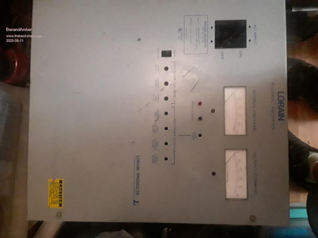

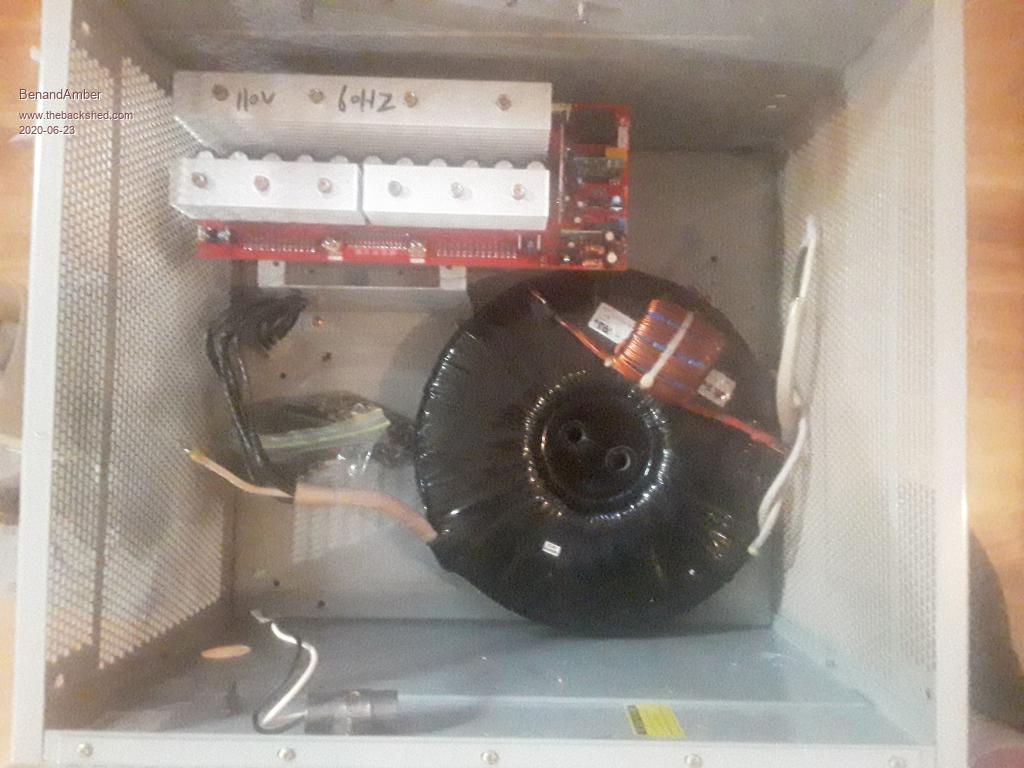

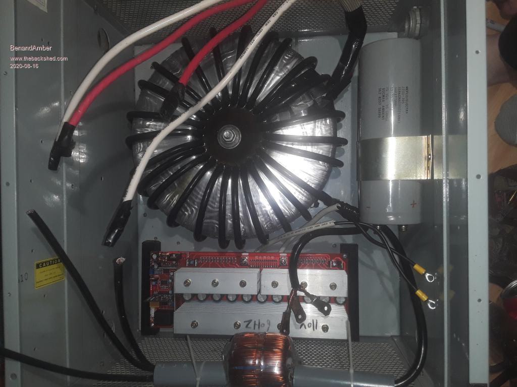

This used box is 19inch tall 17inch wide
and 13deep
Nice size for inverter monkey see monkey do
I am not ashamed got idea from builds on here
It is heavy box been looking for box like this for months
The bottom and top are grated for air flow

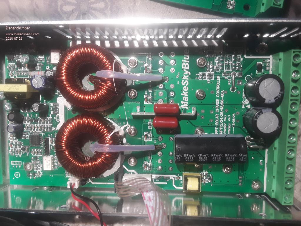

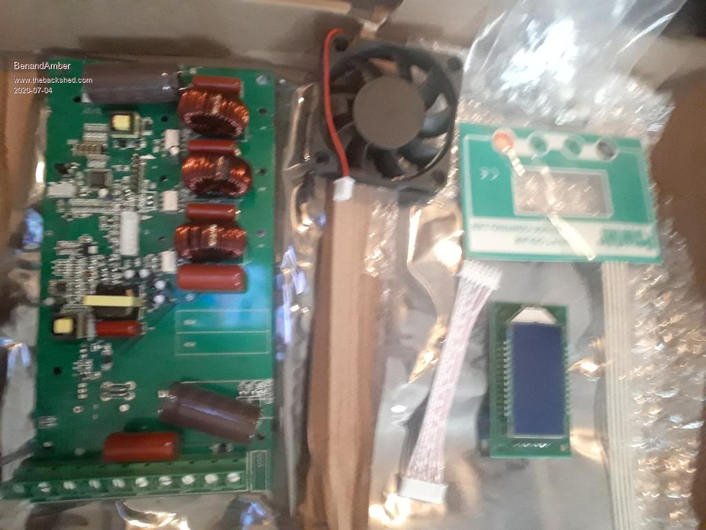

Amber ordered little lcd screen with current  voltage and battery power wattage
It measures power in and out with the little toroid not a shunt
I ordered 2 mrpower(same as make sky blue)  60 mppt charge controllers 58 bucks each free shipping off alliexpress
Alsome deal I think!!!
I read some sellers do not include buttons and screen!!!!!!!!!!!
PAY ATTENTION AND READ DISCRIPTION
MAKE SURE THE ONE YOU ORDER HAS SCREEN
From what I have read only software is different
Every one seems to be happy with them
The reviews I have read are very simuliar to make sky blue
3 stage No battery equalizing is the only complaint I have read
They come with guts buttons and screen everthing needed except heatsink and box
Was thinking about mounting them in side the box
It all depends on what you guys say

I have all the hardware that came out of the gray box I will be using for my inverter
So if there's any of the parts anybody needs let me know

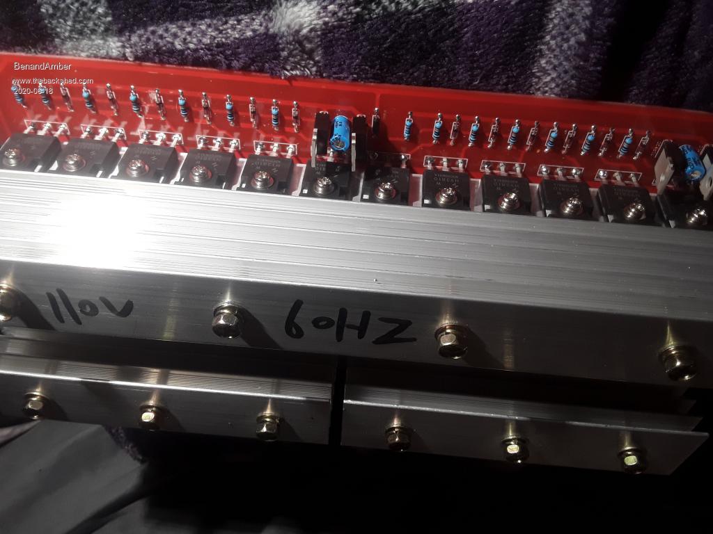

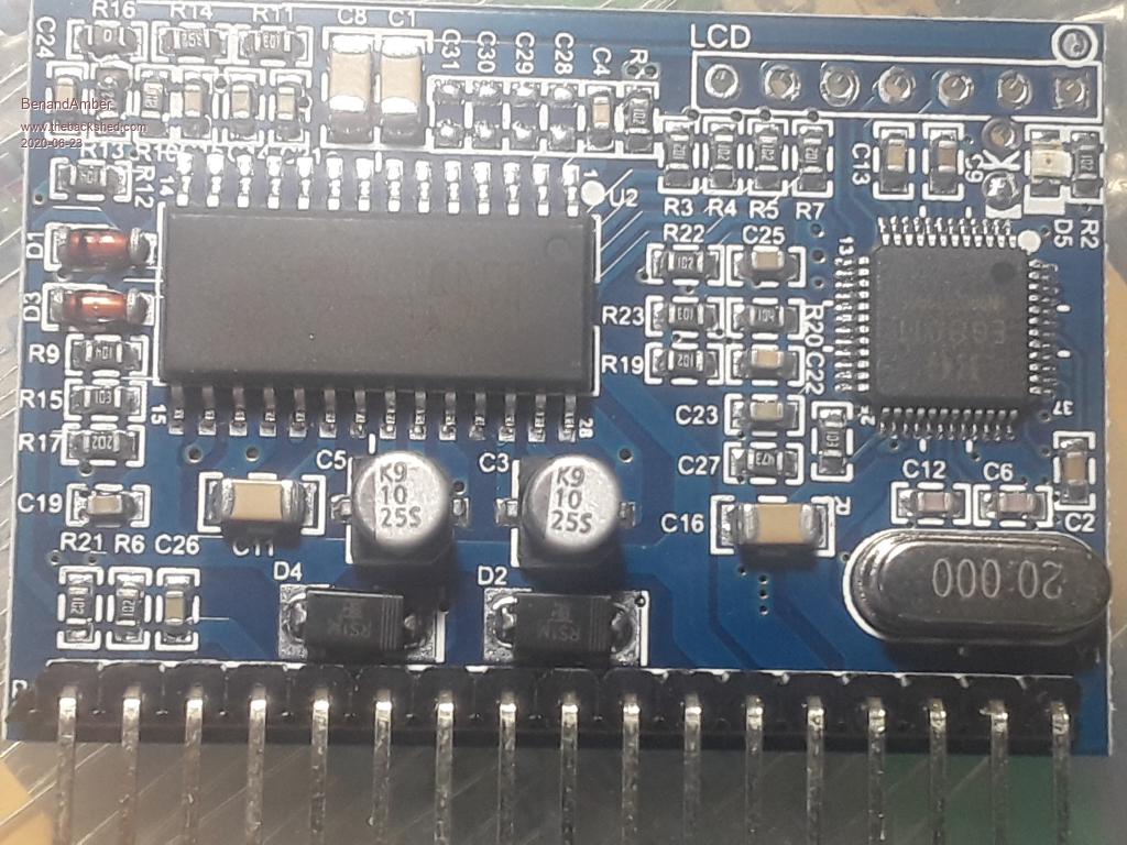

This is not the board Amber ordered
thay sent the wrong one
This is one of those automatically detecting input voltage boards
I thank this one maybe  12 to 96 volts
It has a wire soldered on to the
oo2 board
That wire has what I think is a resistor under heat shrink
It looks like it is for something to do with current
Is all them capacitors a good thing
thay are only 1000uf
She ordered a board with 8 large capacitors
Thay sent this one not willing to wait and deal with exchanging it for the right one
I think this one is more expensive than the one we ordered by maybe $100 still would have rather had the one we ordered
I have those capacitors that are bigger than Coke cans I would like to use in this build
I am not sure of the best way to use the 6 crazy big capacitors
They are in a pic at the beginning of this thread
I also plan on changing the heat sinks on this board
I have some that are alot bigger
We would like to take advantage         (again) of the incredible amount of knowledge of all the experts on this site
So any and all advice is highly appreciate!!!

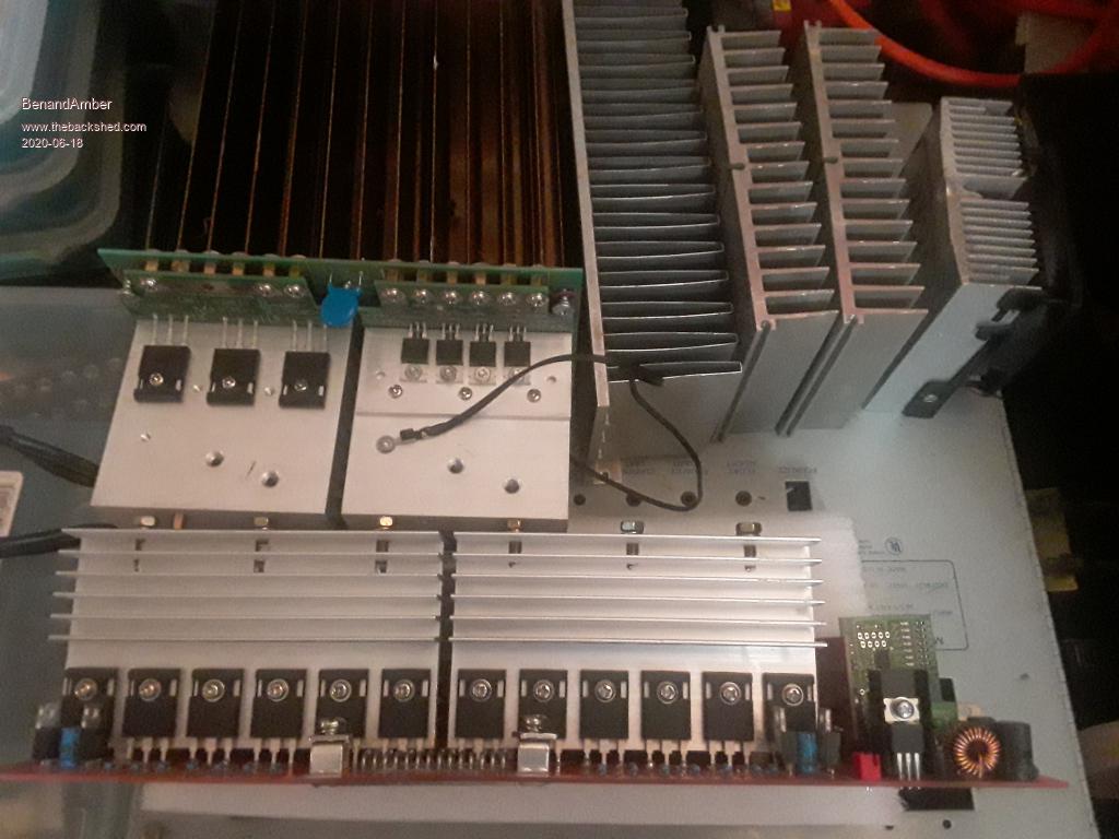

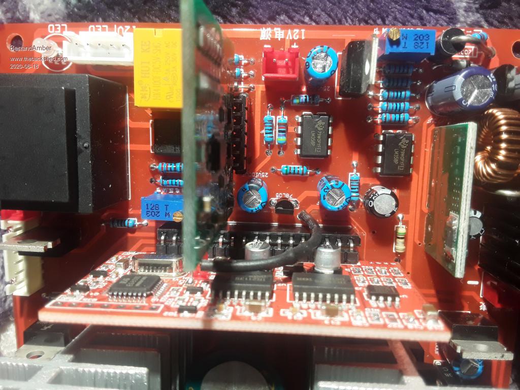

Just for comparison power Jack board and farm inverter board

Those 11 capacitors, they may be ok as is, I have no experience with that particular board.
To add the large capacitors to it they should be mounted as close as possible to the mosfets (same place as the small capacitors are located) or they would have little benefit.
Looks like the POS + and NEG - is on the upper side of the PCB at the base of the capacitors.
One method I can think of to add the large capacitors, would be to remove some of the small capacitors drill the holes a little bigger and attach or solder some studs or nuts on to where the capacitor were sitting.
Then attach 2 copper buss bars to the studs on the underside with some spaces to keep it clear from the bottom side of the PCB to prevent any short out.
Then attach the large capacitors to the buss bars, if its still possible to access the screws to put it all together.
I don't recommend the above solution as drilling the holes bigger would ruin the board and there is no going back.
If it where my own I might do this only if I had to.
The heat sinks look ok Be better with some cooling fan over them, it would be easy to just bolt more heat sink on to them, it would help just a bit more.
The other alternative is to put new large heat sinks on.... that would mean drilling and tapping 24 TIMES, ask anyone here, that's NOT much fun.
The cabinet looks good and should end up tidy, laying it out in the position that works the best can be a challenge.
Hope this makes sense, perhaps someone else has a better idea about the capacitor mounts.

What's the uf value on the caps on the board?
There is more than likely enough there.
Don't replace the heatsinks, just bolt something on top like Rev suggested. You'll still need cooling though.

I will definitely use your idea on the bus bars
I will make it where the capacitors bolt to the bus bars then they bolt to the board

Those little capacitors are only 1000uf each
It may just be in my head but capacitors make all the difference
The space in between heatsinks is so small no go caps will fit
We ordered a board with lots of space in between heatsinks so we could use large caps
The bus inverters board 35mm caps is to close to heat sinks
That limits the caps that can be used
That is why we made sure we ordered a board with lots of space this time
It just wasn't ment to be so bus bars sounds great
The other big question is how to get rid of that little wire coming from the oo2 board

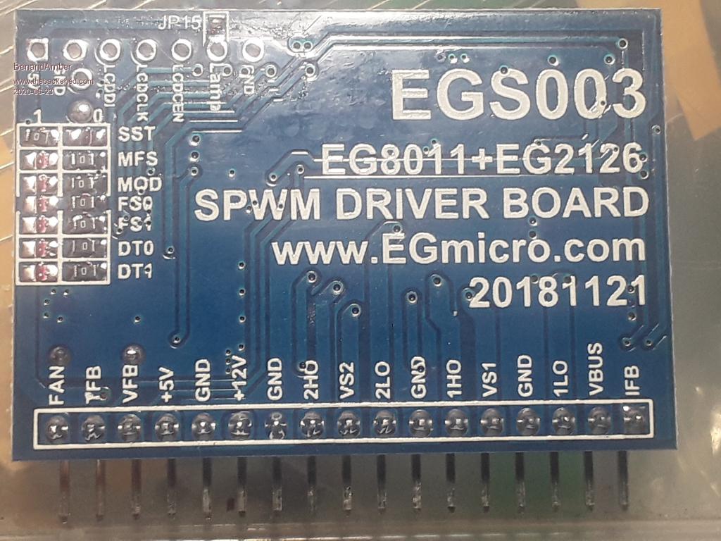

poida
Joined: 02/02/2017
Posts: 1510
Posted: 07:25am 21 Jun 2020
Hi B & A
The little wire going to the 002 board is for over current protection.
There are 2 protection schemes built into the board.
The first scheme uses the current sense pin on the 002 board,
and is driven by the output of the current limit comparator and trim
pot. The user can set a maximum current limit using the trim pot and when that
is exceeded, Ifb which is pin 1 on the 002 board is pulled high, causing
the LM393 to then drive the gate drive ICs into shutdown. This happens
really fast and can shutdown/enable/shutdown/enable within a uSec or so.
I don't like it at all. I prefer to disable this entirely.
The sudden zero to full power then zero, then full power in nearly uncontrolled
manner is a bad thing.
I prefer to have much slower acting current limits in place, such as DC contact breakers.
The second scheme involves the small wire plus resistor that leads up to the 002 board.
Again it is a signal of over current.
This time, instead of driving the gate drive IC shutdown pins, it instead
drives the EG8010 IFB input. This is much nicer in that once overcurrent is detected, which is > 0.5V on the pin for 600 mS then the EG8010 stops. IT stops completely and checks if this voltage is less than 0.5V 16 seconds later. IF not, it does not start up again. If it is less, then it soft starts if enabled
So there are two over current protections.
One can make the toroid jump up and down on the bench when testing. That is scheme #1.
The other just works fine, but it does not handle fast over current transients.
These boards are tough and can handle the short period over current events, within reason. I prefer to disable both and limit DC input current with contact breakers.

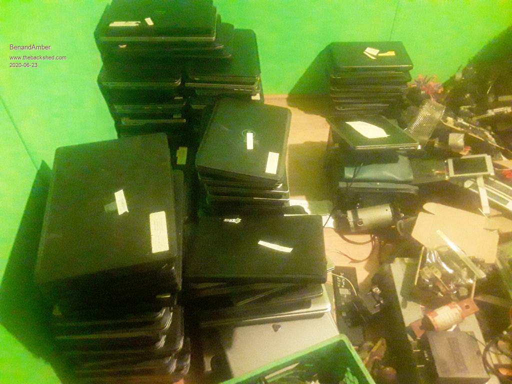

Poida or anyone else I don't know how much shipping would be on a Dell laptop
I have lots of extra batteries extra DVD burners extra solid state hard drives
It would just make my day if you could use one!!
You would have to load your own software on them because they have a password
They came from a big company and Amber bought a lot that had a sh*t ton of them in it
I loaded a old copy of Zorro that I had forgot I had on a couple of them they run great
I heard you could run Android on them
I also seen where you can bypass the password they have Windows 7 professional on them
Most have the I5 processor and 8 or 16 gigs of RAM 320 gig regular hard drive or 180 gig solid state hard drive
I brought this new style 002 board anybody know anything about it?
Some of the laptops amber bought
Try to figure out best layout
There is room under board for the large capacitors
I have one that is 9 inches long and 9 1/2 inches around
I am thinking about just adding it to the ones already on the board
It is a mepco/electra 2731-395 60000uf -10 +50% 85c 75volt 95surge

Ben,
the control board is not the 002, it is a later type that uses
EG's own gate drive IC.
So now I think it wise to leave it all alone.
I would find the trimpot that sets the current limit and wind it up to
permit a lot more current before it triggers.
I need a circuit diagram of this new control board before I can possible comment much more.

The off brand 60 amp mppt charge controllers I ordered are here

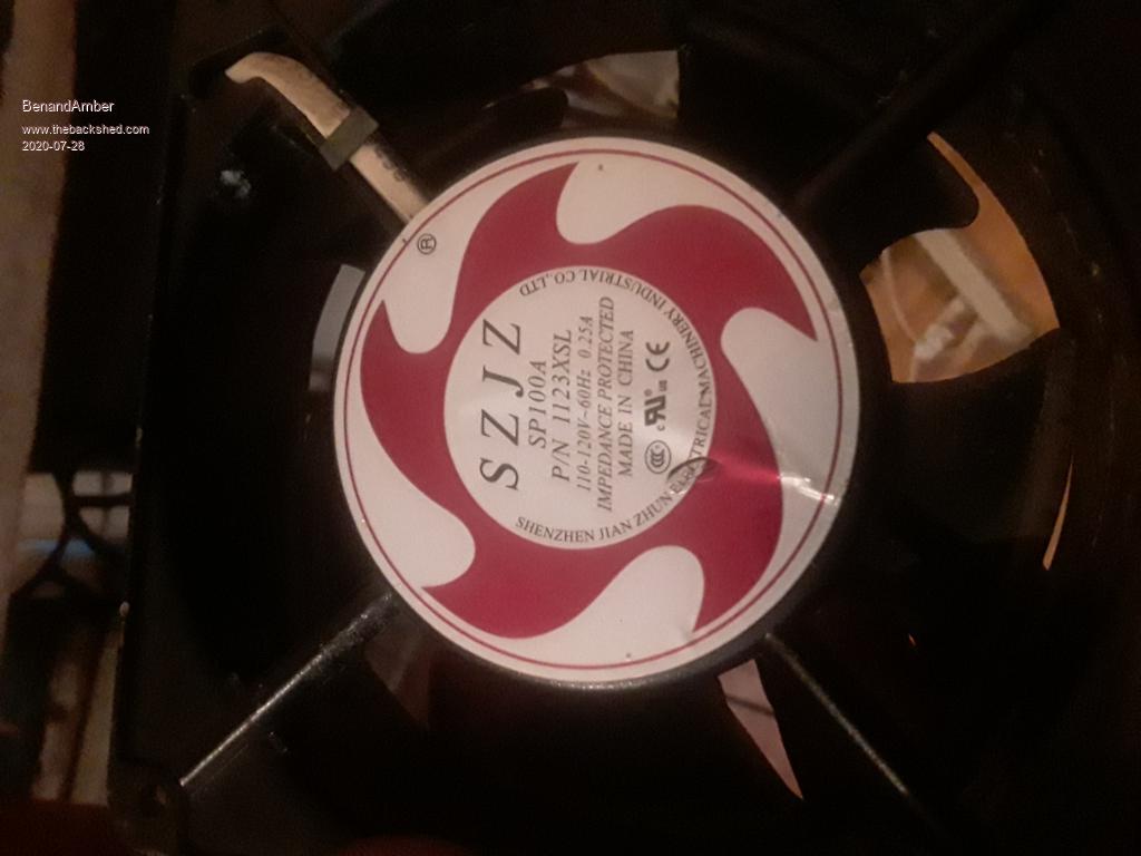

Warpspeed said a ac fan makes sense
I finally ran across a 120 volt one
This is a newer make sky blue mppt 60 amp
The board says up to 96 volts is this true
Edited 2020-07-28 11:14 by BenandAmber

I have made a little progress on the farm inverter
As you can see we rewound and potted the Transformer
We made the Transformer so it could be used for 120 or 240
This inverter will stay permanently mounted beside the braker box
It has 2 hot legs of 120 volts and center tap
(4 wires 2 connected together for center tap)
Center tap will be the neural
The metal inverter box will ground in braker box to the ground lug that goes to 2 8 foot earth ground rods
This way everything earth grounds at one place (no ground loops)
If I am thinking of this wrong please let me know
Amber said this is the last one she helps wind by hand and she really means it this time!! lol
It kicked us long and hard !!
I had it on my lap slid it off onto the couch
It sunk to the floor with lots of cracking noises
As you can see my choke is the bottle neck
It has 16 12 gage wires hope it doesn't get to hot
