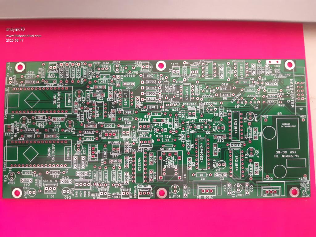

andymc70
Joined: 30/06/2019
Posts: 43
Posted: 02:03am 17 Aug 2020
Thanks to POIDA
I have received the controlled boards, can not believe how small they are, its unbelievable that they can run a home.
Thanks to renewablemark highlighting the minimum build for the board. I have order the parts, now the long wait until they get here.
