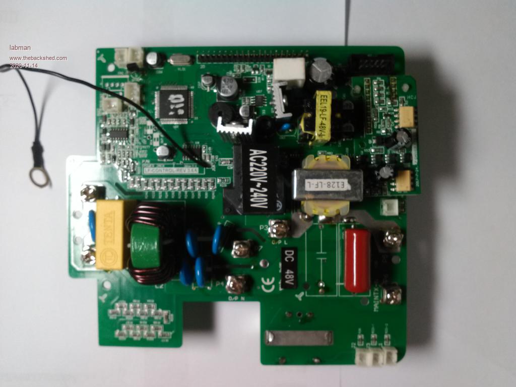

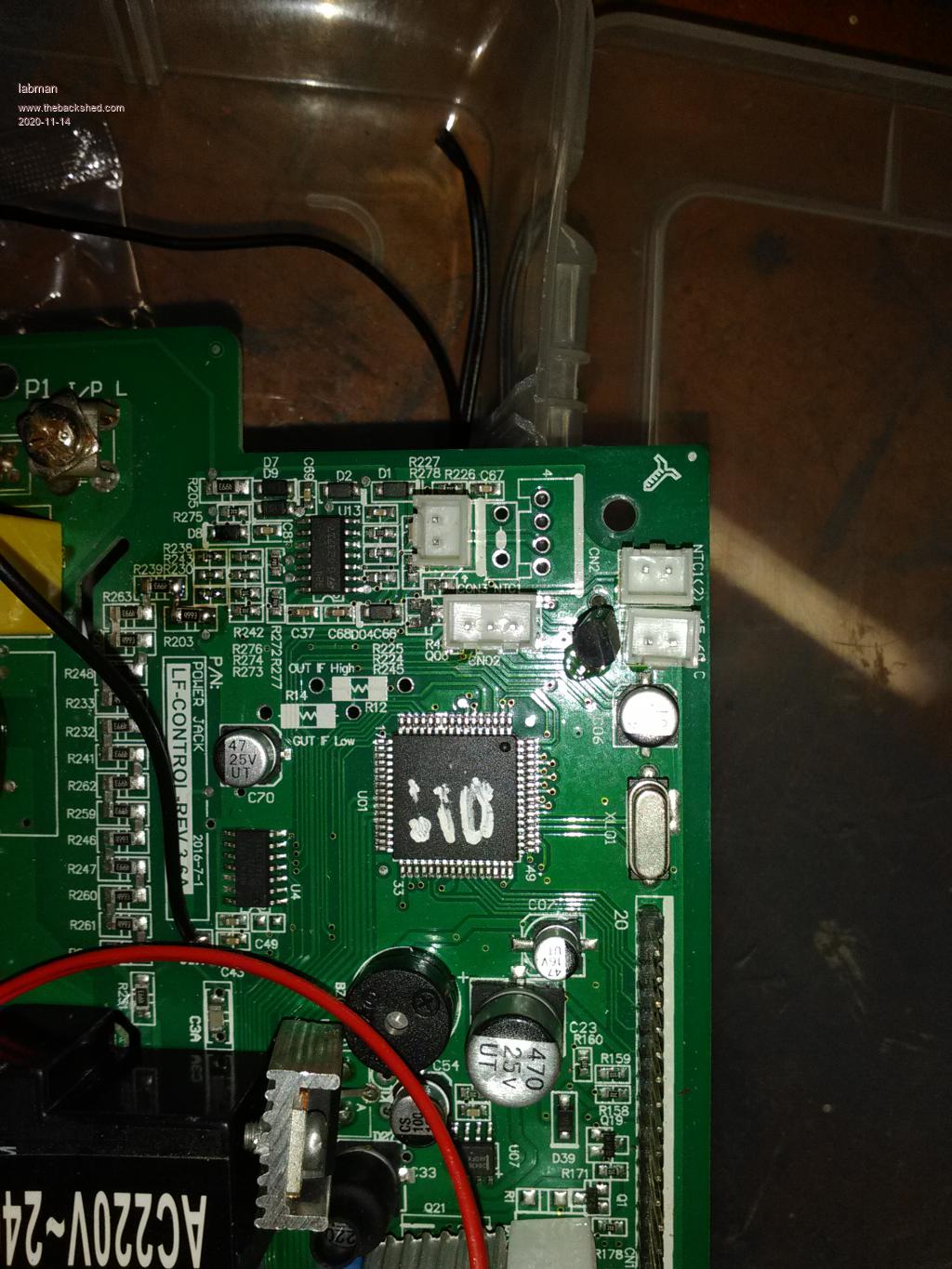

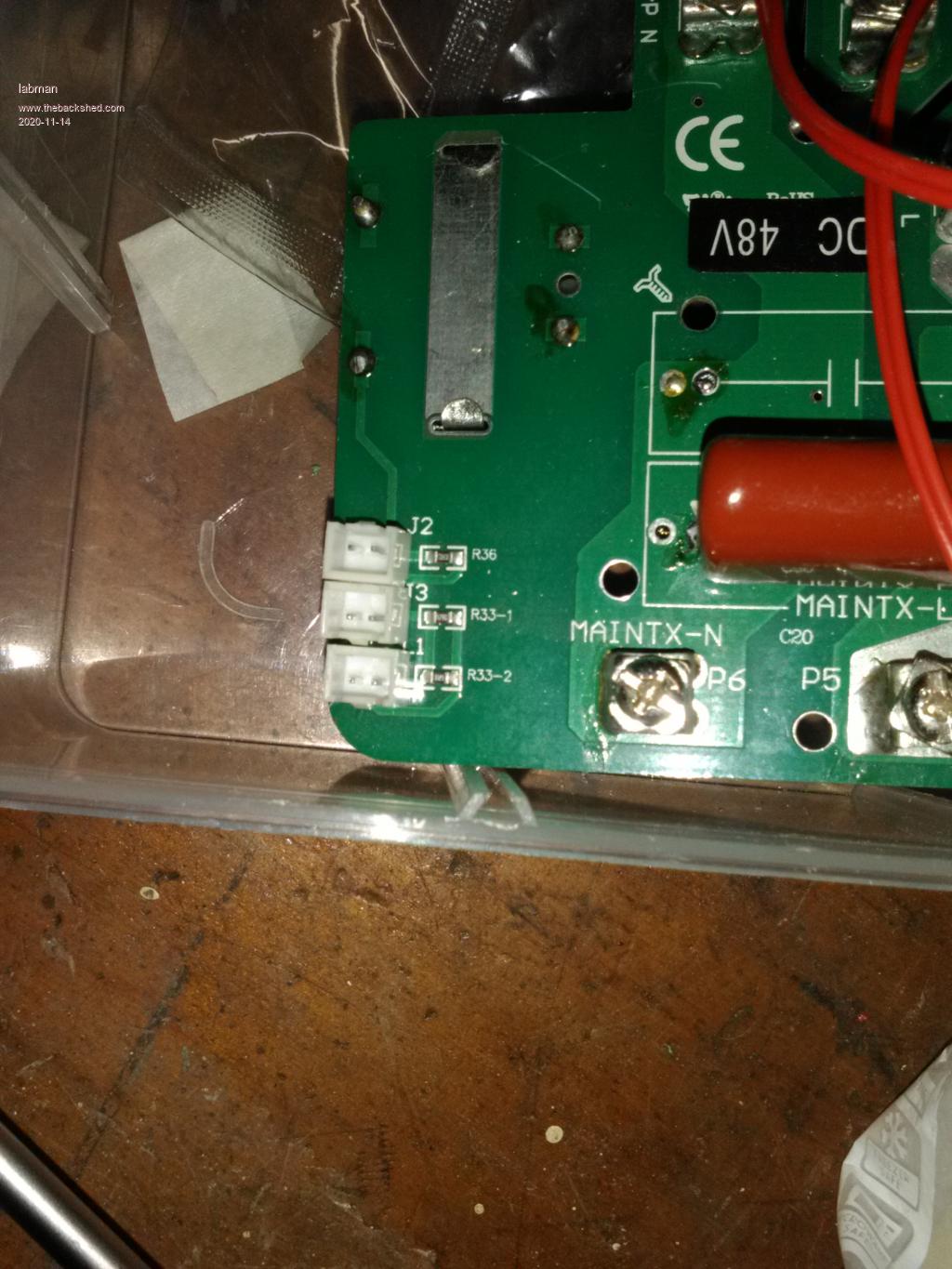

hello Everyone,
I have an old PowerJack Inverter and Support from the Chinese has much to be desired.
I purchased the LW-CONTROL-REV 3.6 A circuit board from PowerJack, with their guidance, to replace an old controller  LW-CONTROL-REV 1.2 which has failed.
The new REV 3.6A board has many extra sockets which I list below:
NTC1(2)
45/60 C
J2
J3
J1
CN4
Is it okay for these to NOT be connected or have I been supplied the wrong circuit board?
I would appreciate a reply from anyone with experience with these Inverters.
Thank you,
labman

Posted: 06:05am 14 Nov 2020
  noneyabussiness said  A picture is worth a thousand words...
Hopefully I have successfully attached some oictires.

Posted: 11:16am 14 Nov 2020
The small 2 pin socket near drive boards is for current sensor for screen on some models, should run without it. The 3 pin near cpu is for fan, some need feedback from fan, some don't.  Ntc (2) and con3 are both ntc sensors, again should run without them hooked, but you will lose temperature control. " 45-60 " no idea. . Have no idea about three 2 pin connectors bunched together.
Above is a educated guess, I had a board with similar features.. as long as you have voltage feedback and 10pin connector it should run( not counting fan feedback as some do, some don't). They are pretty tough boards, unless something wrong, you should be hard pressed to kill anything.
I think it works !!
