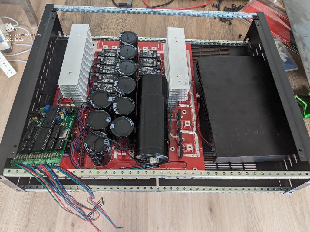

I'm just contemplating a 3 phase warpverter build based on Andrew's stm32 blue pill project here

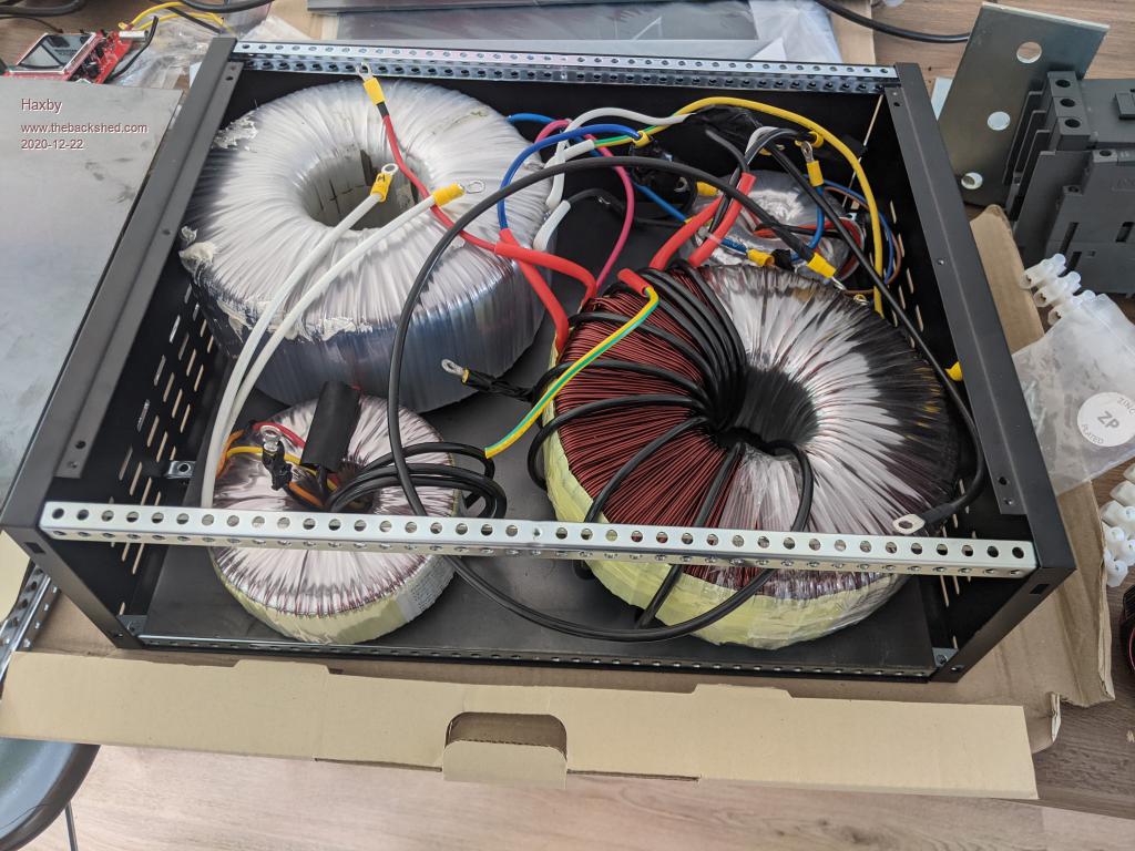

I'm finishing my single phase warpverter build for my 200v Prius, and I found it all fits nicely in a rack mount box. Actually the board fits in a 2U box and the 4 transformers fit snugly in a 3U size box.
Now.....I have another set of transformers so I can double the output just by paralleling the second set of transformers in another 3U box.
BUT, if I scrounge around and find another couple of aerosharp inverters, then it will be tempting to make a 3 phase warpverter.... Just for fun!
It's just thoughts at the moment because I don't need 3 phases for my application, but it will be hard to resist if I come across the extra parts.

Posted: 08:57pm 22 Dec 2020
Its should be pretty easy to suitably synchronise three Warpverters.
That is a very neat packaging solution by the way. You can remove the electronics for maintenance or repair, and leave the heavy transformers behind.
