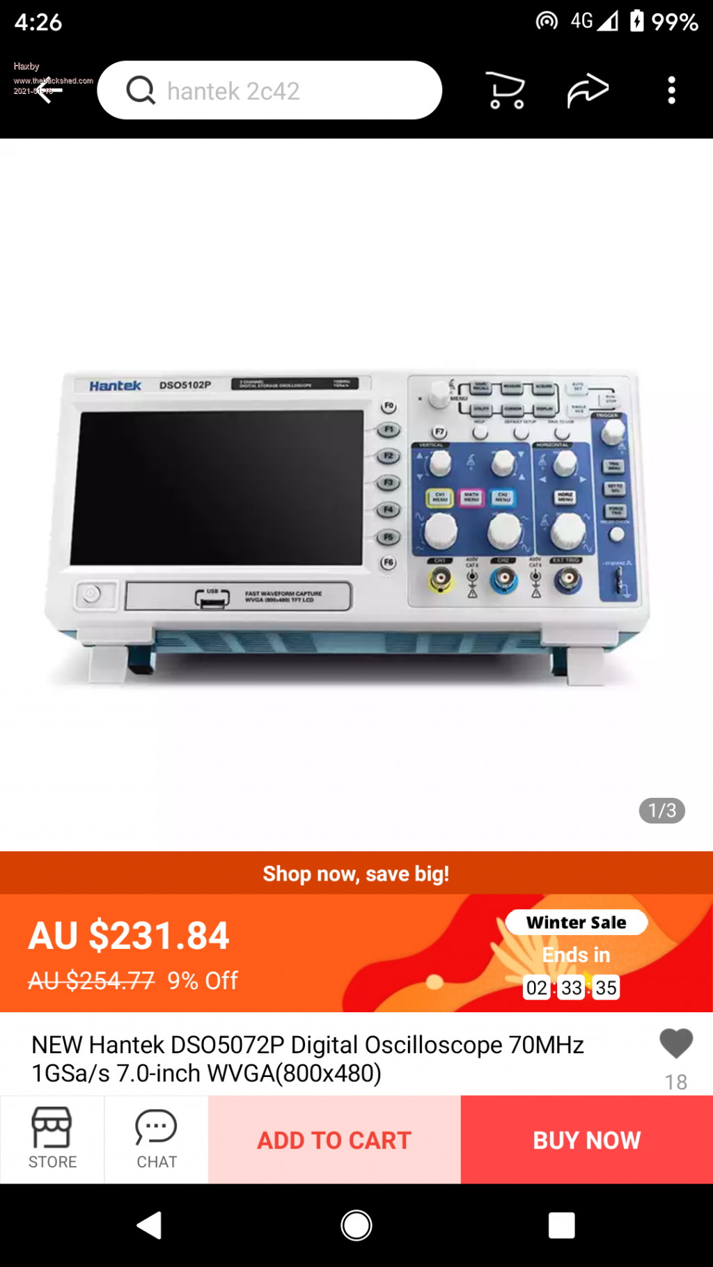

Hi all,
Looking for a well priced oscilloscope.
This one has been mentioned on this forum. Any other ideas?
I'd prefer getting one locally as I don't want to put my project on hold for 3 months waiting for it to arrive. The one above is available in Brisbane for $400, which is ok I guess.
Any other suggestions?
renewableMark
Joined: 09/12/2017
Posts: 1679
Posted: 07:36am 16 Jan 2021
This is the one I got, haven't used it hardly, but it has plenty of features and not pricey.
Cheers Caveman Mark
Off grid eastern Melb
Posted: 07:41am 16 Jan 2021
That looks like an excellent buy Mark.

I think I paid less than that for it almost a year ago, been so busy with other things I haven't used it properly yet.
NO, I just checked, I paid $319 for it. those sons of bitch f'ers dropped the price.

Ok I bought it. Thanks all.
