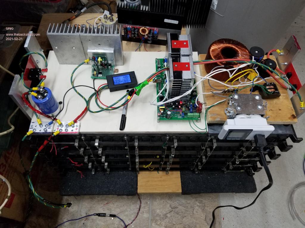

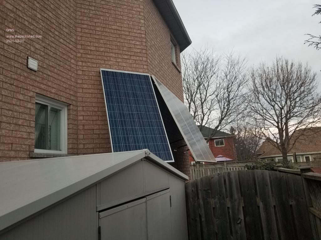

So, prior to seeing this forum, I decided I wanted to build a small off grid system, thinking it might lead to something larger in the future.  I thank the people who have posted the wealth of knowledge that is contained in this forum.  I am sure I have/will blow up less stuff, with the work people have done and documented here.
Solar Panels
So I am using just 4 right now, fastened to the side of the house.  The corners at the top of each cell, are reinforced with a 3x3" L shaped aluminum bracket, glued in with JB weld.  Then 2.5" door hinges were used to fasten the tops to the wall.  I then made struts of various lengths, so I can set the angle of the cells.  In my area the sun angle varies from 22-70D.  The below pic was taken prior to running the wire/conduit.
It's winter here, and on a good day I can only collect about 4.5kw.  Most days are much lower.  Right now I have these cells in serial/parallel, going through a linear regulator into the battery.  The battery voltage ranges from 72-81v, while the max power voltage of the cells is quoted as 76v.  I have tested the cells at different light intensities, and always find I get the maximum power at this voltage.  Under what conditions would I find that this maximum power point voltage would change? Right now I calculate I am only losing about 5% of input power because of not being at the ideal voltage, so am not sure there is much point in doing a MPPT charger for this system.

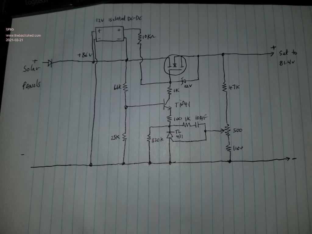

Right now, I have everything mounted on a couple of mover dollies.
I am ready to move the inverter into it's own case now.
Since I don't have a MPPT charger, I am just using a linear charger, set to 81.4v or just under 3.4v per cell.
The batteries are rated at a float charge voltage of 3.45v, but I am finding the battery capacity to be pretty good at 3.4v.

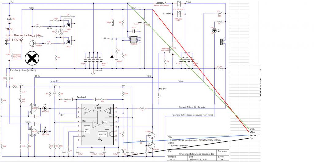

Here is a link to where I found the basic circuit.
High voltage linear regulator

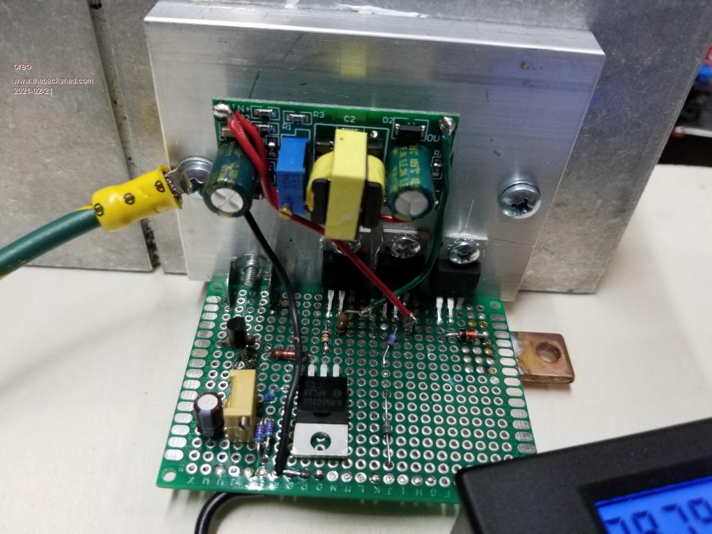

I added an isolated 12v dc-dc converter to this design,
so I could get low Fet on resistance, when the output voltage
was close to the input voltage.

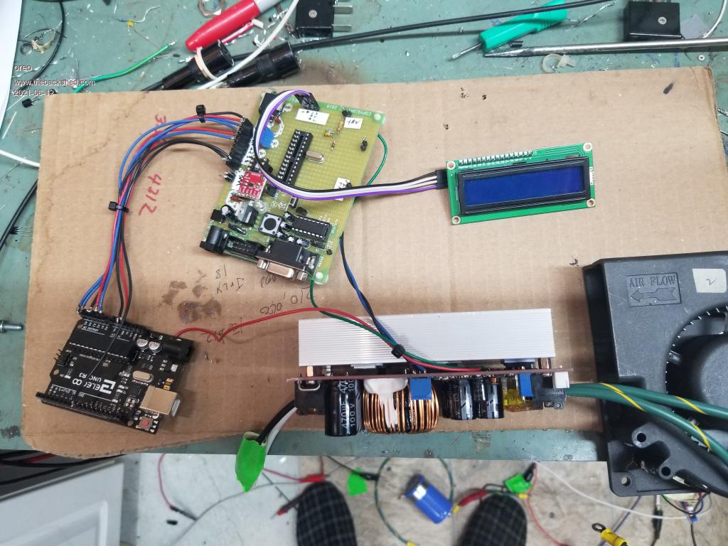

I am happy with how this works, however I still need to add battery cell balancing and
an undervoltage/overvoltage disconnect for the battery.
Currently the battery is pretty well balanced (within 2mV at both low and full charge), however I need protection if something goes wrong.
Greg
Posted: 04:49am 21 Feb 2021
Excellent !!
  Quote   Under what conditions would I find that this maximum power point voltage would change?
 It does vary very slightly with solar intensity and temperature, but not by enough to even think about.
Matching the panels to the battery is a really smart move, you will get excellent all around efficiency with a very simple low cost system that has very little that can go wrong.

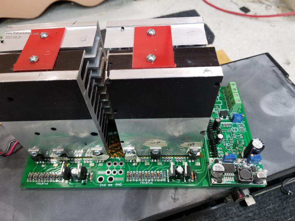

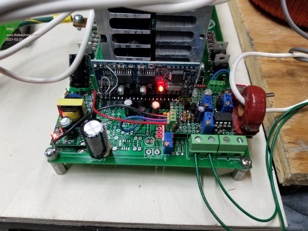

Prior to finding this forum, I saw the below video which has a zip file in the text, with gerbers for the PCB.
48v Inverter
So I ordered 5 of these boards, and so far have built up 1.
The board design is pretty good, and most of the components fit into their holes.
It uses totem pole drivers, and a SMT uP, which monitors input voltages (I didn't  use the uP)
I made some changes, mostly based on Tinkers thread on how to modify the EGS002 board, and an attempt to use components on hand.
I added an undervoltage cut out, and a provision for going slightly lower on the undervoltage, if the circuit was drawing a lot of current from the battery.
I am just using 3 IRFB4227PBF per leg, since I don't plan on supporting more than 1kw with this board. (2 transformers)
In this picture, I have a DC-DC converter, for a 48v system.
Here I have a DC-DC converter which supports in excess of 200v.
It was a little painful building up the small point to point wiring board.
I may end up doing a pcb if I like the way it works long term.

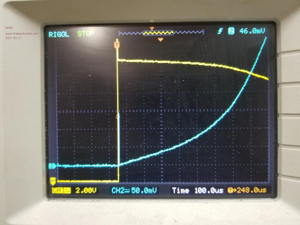

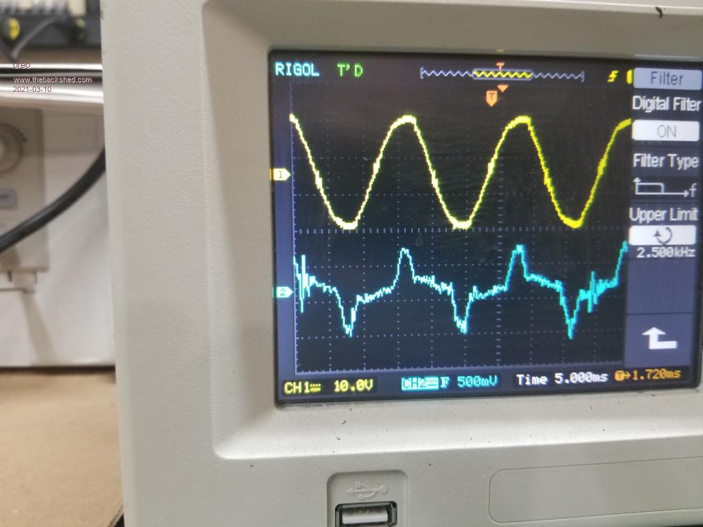

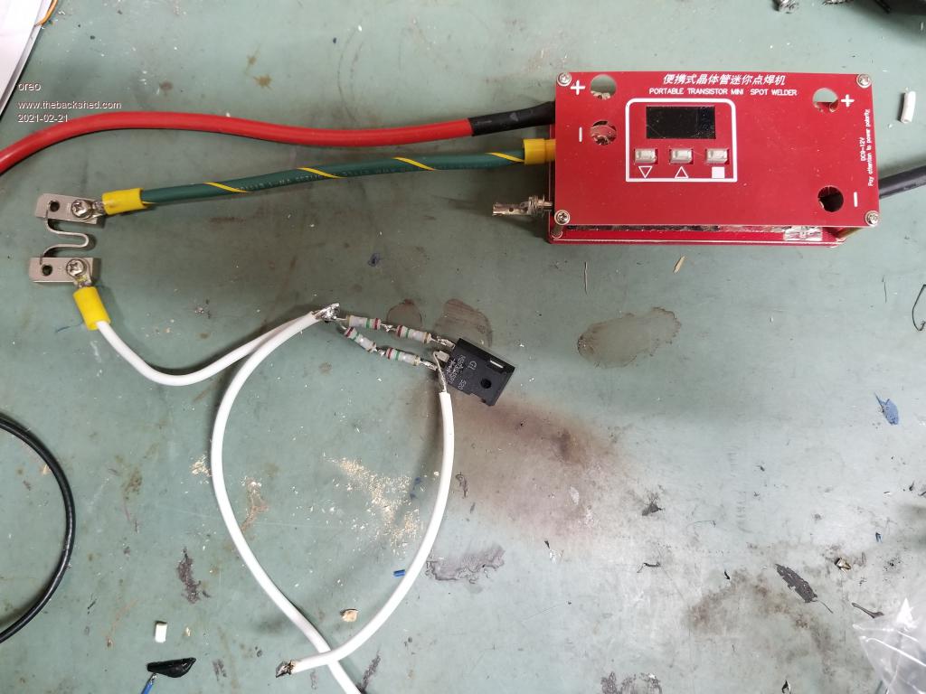

I have access to lots of inductors on boards which end up in recycling.
Problem is, that all of them are not huge current.  If I ever do a high power inverter, I am going to need to purchase some cores.

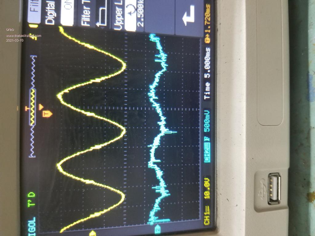

To measure saturation, I used a little spot welder that I had purchased back
when I thought I might be building a battery pack.
Using this, a storage scope and a 12v battery with lots of output current, showed that a 3 stacked choke had the best performance, without rewinding.
The choke is ~300uH (yes, higher than it needs to be) and on the blue curve below, each 50mV represents 15 amps.
So it starts to saturate at 15A, but doesn't get into real trouble until about 30A. At 30A, it is still acting like a 85uH inductor.
So I am using 2 of these in parallel. At 30A, they would probably melt.
Using Tony's method of using a 10k series resistor to determine capacitance value yielded some strange results.
The test suggested that I use an very low value of capacitance (.40uF) to obtain the peak at 90Hz.
I ran the procedure twice with a week in between just to confirm the results.  When I tried using this value, it did not filter out all the hash.
So I ended up using 1.2uF, which was the lowest value I could use, which gave me a clean sine wave.
The sine wave on the output of the transformer looks perfect on all the loads I have thrown at it so far, but I have not put a motor on it yet.

Posted: 06:55am 21 Feb 2021
It sounds like you are getting down near 60Hz resonance with 1.2uF, which will give you the cleanest sine wave, but you may have trouble regulating the output voltage with zero load.
See how that goes...

  Warpspeed said  It sounds like you are getting down near 60Hz resonance with 1.2uF, which will give you the cleanest sine wave, but you may have trouble regulating the output voltage with zero load.
Yes.  The required value will change when I add the additional transformer.  Hopefully things will be in check at that point.

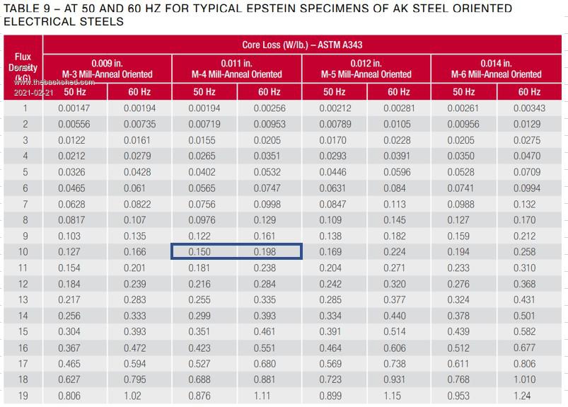

I initially I thought us guys with 60hz, had a huge advantage when it comes to the transformer.
To achieve the same flux density with 60hz vs 50hz, you can use less turns.
Using the calculator, if I need 140 turns at 50hz to achieve 10KG, then I only need 120 turns at 60Hz.
Bonus....  Well actually it turns out, not so much.
Here is a loss chart, I pulled from the internet.  This shows the core loss in Watts per pound.
The transformer losses are greater at 60Hz than 50Hz for any given flux density.
Working the numbers, if your loss goal has you using 140 turns at 50hz, then you need to use 136 turns at 60Hz, to achieve the same losses.
So 60Hz is not as much as an advantage, as I was thinking.

Posted: 09:00pm 21 Feb 2021
The suggested design flux density for an inverter is 1 Tesla (metric) or 10,000 Gauss (Imperial).
The losses will be vastly less than at the 13,000 to 14,000 Gauss for a grid operated transformer.
Zero load idling current will drop to a fraction at the lower flux density.

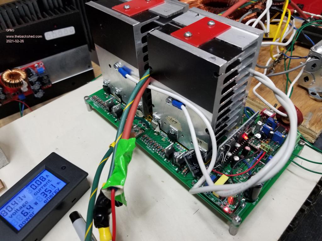

Yes, I agree and if I were building a 6kva transformer, it would be 10KGauss or lower, however for a 500-1000va transformer, which has a core of 6-12lb, then it's not quite so important.
Here is the power draw I currently have, with my tiny toroid with a sub 7lb core. I tried removing the EI transformer, and the standby went down to 3.4w (non isolated though)
BTW, I am pretty impressed with the accuracy of this wattmeter.
The voltage and current measure bang on with my Fluke, even though the wattmeter shows less digits.

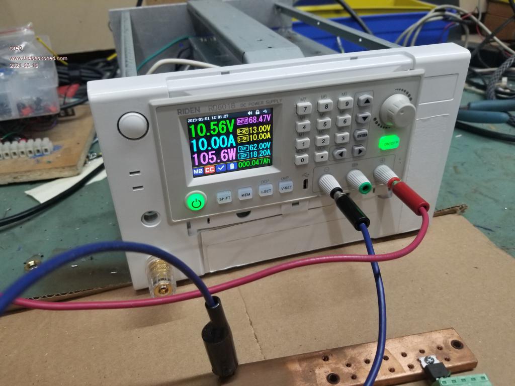

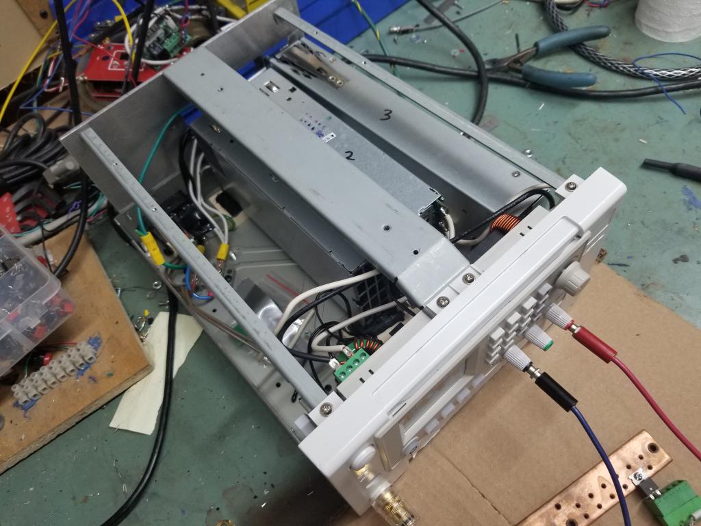

So I managed to blow up my regulated linear power supply.
Don't think I have tried to run it at full output power and voltage for more than a few minutes until this project.

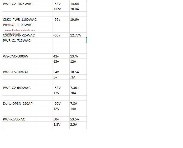

It's old and I decided to replace it with a RD6018.
An RD6018 is really a programmable buck converter, so I need something to supply it power.
There are several versions with different current ratings, RD6006,RD6012 and 6018.
Here is a short video, -there are lots on youtube. RD6018
Anyway, now I am looking for a power supply for this, as well as a power supply to charge my batteries off peak, when I have no sun.  I have found that used server/phone power supplies are cheap and some have decently high voltages.
Here is a listing of some of the models with output voltage and current.
I can purchase the units up to 1kw for less that $50cad and the 2700w one for $70.
If you're looking for 12v supplies, they are even cheaper with units for 10-15$ with 400-700w output.
If you're looking for these, check ebay or your local buy/sell.
I think I may need to trick these into outputting a voltage.
Plan to pick up a couple on the weekend, so will know soon.

do you like that other board layout that is free on youtube from i think the same guy 102 or 103 guy
Yes, this is the board I am using.  I like the fact that it uses TO-220 devices, and is fairly compact.
For the foreseeable  future it should work well for me.  Currently I am building a second unit for a buddy with a 24v system (I have 5 boards).

So I finally got the power supply together.
Thank goodness for the internet, because these supplies needed specific pins shorted, before they would output any voltage.
Fortunately, the fans are pretty quiet (that may change when I run the supplies hard).
I am using 1 12v and 1 56v power supply for the step down power supply and have another 12v supply also wired in series so I have 80v on a separate set of binding posts to charge my battery (only 1 post installed right now).
Much more convenient for testing mosfet on resistance, since the power supply maintains the correct current.
The only inverter anomalies I have noticed so far, is that on occasion the voltage hunts around +- 2 volts under some loads.  I am driving mostly motors, which may not be helping.
Here is what the voltage and current look like when predominantly the furnace is running. (blue = current)
And when the fridge or freezer is running.
As a result, my AC wattmeter reports totally wrong numbers.
Is anyone else having trouble attaching pictures?  I had to keep hitting upload and eventually it would.  Not sure why the last picture is rotated.  I tried rotating my computer copy, and then uploading.  Same result.
When I was bench testing my inverters on the bench and powering them from a mains input power supply, I had a similar varying of the inverter output voltage.
It turned out that it was due to the fact the inverter operating frequency was slowly drifting compared to the mains frequency and my power supply had a very small amount of ripple under load. As the two frequencies drifted relative to each other there was a few volts variance at the inverter output, between when the peaks lined up and when they drifted away. It lead to a very slowly changing output voltage that for a while I was convinced it was an inverter problem - which in my case it wasn't.
If you are using a cheap and nasty watt meter (the $15 - 30) blister pack cheapies some have terrible wattage behaviour and are actually showing VA not true watts.
Cheers Mike
If you are using a cheap and nasty watt meter (the $15 - 30) blister pack cheapies some have terrible wattage behavior and are actually showing VA not true watts.
Interesting inverter ripple problem.  You must have a pretty strong power supply, to power your inverter.  And yes I am using a cheap and nasty AC watt meter, so I am having problems with reported power not being correct.

So, I cobbled together an circuit to MPPT the upconverter.
First off, I measured efficiency, which was not too bad.
36 to 78V
3.6w out  42%
18w out  88.6%
36w out 90.8%
67w out 93.6%
90-500w out ~94%
600w out 93.6%
My panels will output about 1100w max, and I am guessing the efficiency is about 89% at that output.
I used 1800w rated upconverters and removed the 200K resistor to +5v, and tied 4 wires back to the Arduino.
I used a MPC4725 Arduino DAC, with a voltage divider at its output to vary the voltage tied back to the current sense on the TL494 to vary the  maximum current output.  Basically the code tried to maintain the ideal input voltage for max power by adjusting the output current. I also had current sense on there if things looked to be working out, but I never got there.  (I had to use an additional 15000uf at the upconverter input to keep the input voltage stable and probably could have used more).
Below 50w, I had to use a 1v higher target voltage then ideal but I was pretty happy with how it worked.  I was collecting power over a much wider period of the day and peak power was also good.  Unfortunately the Upconverters kept failing.  I popped one, so ordered 2 more.  On the 2nd go, I made sure the unit was not running close to hot, yet it still popped the main mosfet.  I have not fired up the last one yet, and may try replacing the mosfet with a NA brand part on one of the blown units.
So for now, I have just inserted a 12v switching power supply in series with the solar array.  This actually works pretty well, except at low power levels where the idling/low power consumption of the power supply chews up all the power.  I have ordered a couple of $20usd HP 80 Titanium power supplies to experiment further with this method.
