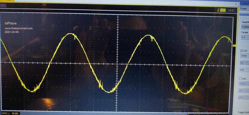

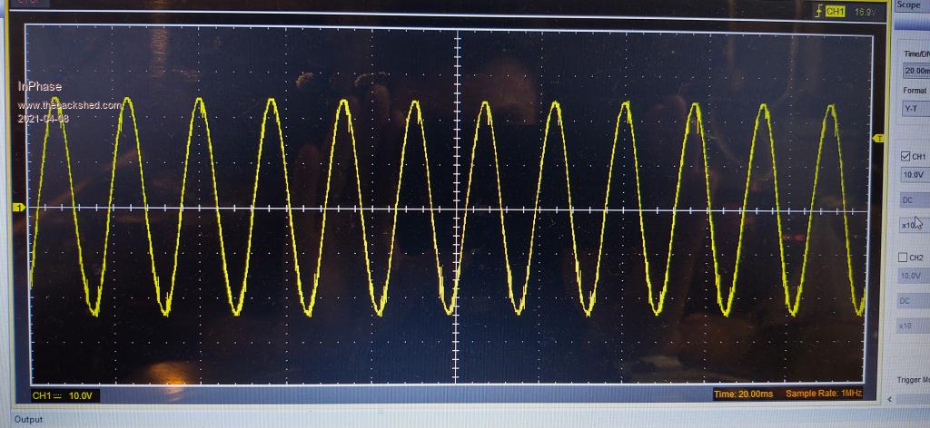

So I've managed to cobble together a working inverter based around Poida's Nanoverter. Instead of using the IRF21844 chips to directly drive the FET bridge I used TLP350 opto drivers and isolated gate drive supplies. I have tested it up to 1000 watts so far. It works well and starts a 1/2 HP pump with no problem. However, I notice some irregularities in the sine wave when zoomed in to less than 20 ms. RC snubbers don't alleviate it at all. I did notice a very slight change when I coupled the isolated supplies to power ground through some 100 nF capacitors, but not of any significance. I am powering it for testing on a big 24 V power supply, but the output of that is really clean, so I'm not sure if that could be a source of trouble. Also, the choke on the transformer primary is just 4 turns on an old transformer core with no air gap. Could that be somewhere to look?
I've attached pics of the wave at 5 and 20 ms. Do the expert eyes here see this as a real problem?

Posted: 09:39am 08 Apr 2021
not really.
there is a lot of noise in these things.
Usually I use the DSO function called "high resolution" (for the Rigol DS1054Z)
This averages a number of samples to give the value to be plotted at a particular point
on the display.
I think this function is probably available in your and other DSOs
This is noise. There are large and strong sources of noise with an inverter.
Why do I regard the averaging of samples over a short period of time
(vis a vis "high Res" mode) to be useful or meaningful?
The DSO input stage is very good and can record fast changes in input signal.
When you add the noisy environment to the signal, we will have to see a noisy signal.
I always show "high res" versions of the signal here on the forum.
The noise sources include the primary winding, the cables leading to the primary and the inductor. At 1kW and 50V that is 40A or more switching at 20 kHz with 500nS rise times or faster. This means large amounts of high frequency EMI.

Thanks Peter! My concern comes from the fact that this noise seems to always occur in the same place on the waveform. There's a little wiggle on the down slope of the positive half and a little wiggle on the up slope of the negative half. It's very regular. I'm going to stop chasing this ghost and steam ahead.

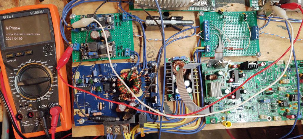

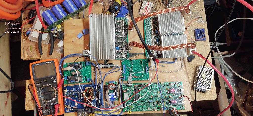

Here's some pics of the bodgery. I guess it isn't hard to see how some noise might creep into the works.
In the first pic you can see the two FET boards with the heat sinks. Both high sides on the left, and both low sides on the right. Going clockwise from there is Poida's Nanoverter board. I have two Nanos installed, but only the inverter function is being utilized. To the left of that is the low side gate power supply.
Then is my DIY isolated high side gate supply. It used to be the power supply on an  old car audio amp. It has a TL494 driven push pull transformer with two output windings. Each of those windings goes to the next board to be rectified and fed into the two buck converters which now are isolated high side power supplies.
Under the heat sinks are TLP350 opto gate drivers which in turn feed BJT totem poles for each quarter bridge.
I know it is a sloppy mess. But I've had one hell of a fun time doing it. When I complete high power testing, I will boil it all together into a couple of ordered PCBs in a box.

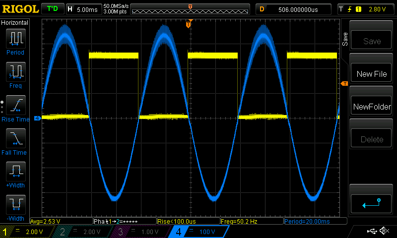

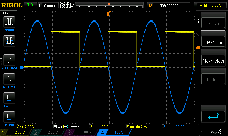

Posted: 06:58am 09 Apr 2021
probing the AC output for me requires some care since it is 240V AC RMS
Peak voltages can be 340V.
I do not just connect a probe's ground clip to one wire of the AC output
and the probe tip to the other.
I use an isolated differential probe for this.
It has a decent bandwidth, of the order of 25MHz
The two leads for the differential input are unshielded DMM clip leads
so they will pick up lots of other signals.
With the boilerplate out of the way, let's see what the test inverter is today:
Under 200W load. (57V input, 235V AC out)
Notice the noise on 1/2 the wave? I have no idea where it comes from.
Maybe a marginal totem pole drive. I have blown this board up more than 4 times now.
This is using the acquisition mode "normal"
Now when I use "high res" acquisition mode the noise is averaged out.
I know there is noise and I know there are problems with my test inverter.
But sometimes that is not important in the discussion I am having at a particular time. So I smooth the traces so they look nicer.

Hi, nice testing setup.
For a next time it is better to build 2 Half bridges, instead of what you have now. The reason for that is that now your capacitors are to far away. You won't have a stable DC bus at the mosfets, at the capacitors you might have a stable voltage but, that's not the case at your MOSFETs, the higher the current, the higher the spikes at your MOSFETs, and the closer to MOSFET failures.
Try to add some decent low esr/ESL +/-4,7uF capacitor between the low side MOSFET source and high side MOSFET drain, with the shortest possible path to surpress the transients.
This might help.
I see you already added snubbers.

Posted: 03:09pm 09 Apr 2021
I like that fuse in the centre of the top picture, should be good for at least 300A lol. I use an old brass pot shaft 1/4" (6.3mm) dia for the same thing at times. When everything becomes a smoking vaporised ruin the fuse will be the only thing left intact.
The isolated supply is impressive but a little overkill, I estimate you only need ~ 100mA max per high side drive. What was the pcb from - a car stereo or similar?
Congrats on making it all work, agree needs more choke work & capacitors as per Nicks comments. I am surprised the cro images are as good as they are given the layout.
