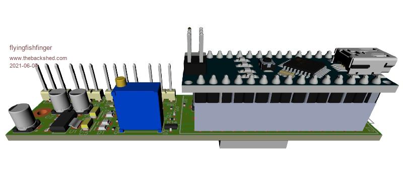

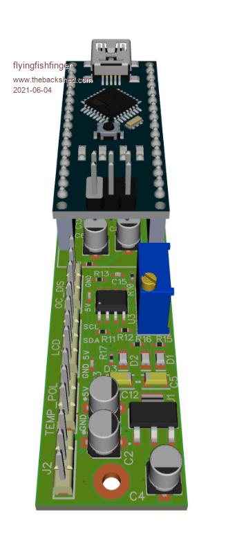

Hi,
I didn't want to derail Poida's thread about his MPPT so I'll put this here.
I've adapted his Brainboard for Wiseguy's Powerboard layout to fit right ONTO the 10-pin connector in a bid to reduce cables running around the place & keep things short. I've made a few changes:
- Added a hardware comparator & P-FET that could be used for a hard over-current shutoff. This is an adaptation of Poida's attempt at controlling this with a software interrupt, but I have no idea if it'll work yet.
- Added a few 0.1uF capacitors to decouple the 5V supply to the Nano and the LCD, I want to try to get the I2C display working properly. Should generally reduce noise.
- R, G & B LEDs - everyone needs Blinkenlights! For extra indicators.
- Optimized routing for the 10uF filters a bit, this should reduce the noise on the analog readings.
I don't have a 3D model of the Powerboard (wiseguy?) to check the fit with, but I'm 98% sure it'll fit.
I'm about to order some along with the Powerboard, and if it works I'll be happy to share the Gerbers for anyone who wants to try it.
In the meatime, here are schematic & screenshots if anyone's interested. I'll report back on how things go.
MPPT_NanoController.pdf
Cheers,
R

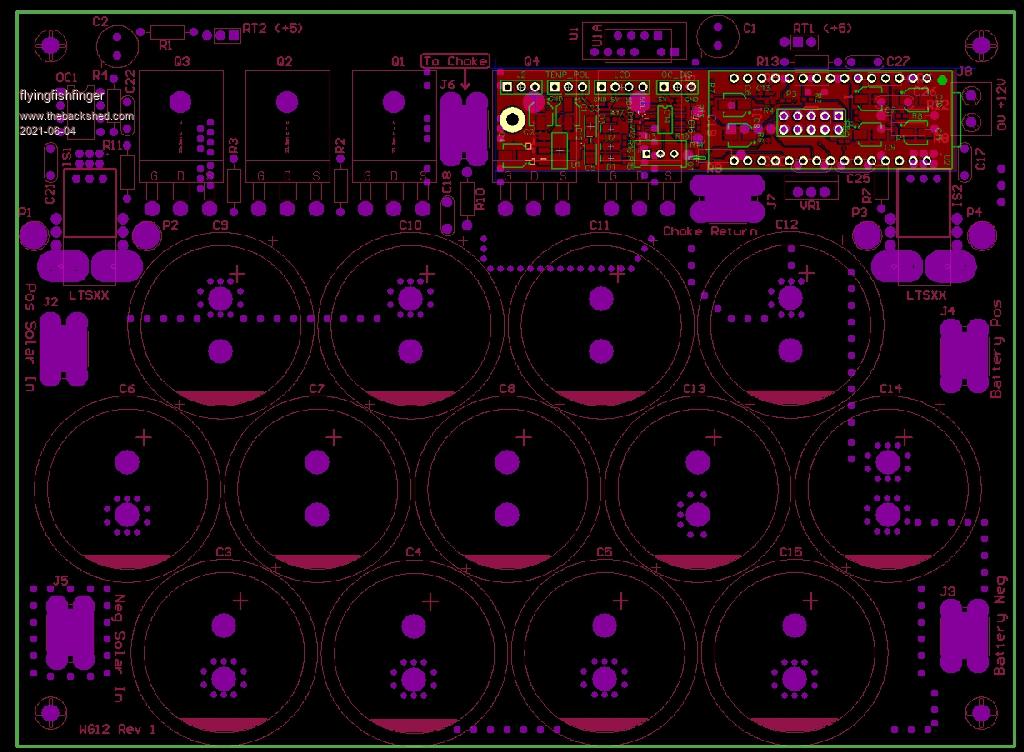

  flyingfishfinger said  Hi,
"I don't have a 3D model of the Powerboard"
Nor do I Rafael - sorry.  I need to create 3D models for all of my components - its on my to do list - I can just see it if I use binoculars......
I do need to get around to it though - takes out a bit of the guesswork and I will need my vernier & sample components a lot less when I design PCBs.  I have looked at how your pcb should fit and I dont think it will foul with anything. A component on my PCB could maybe be inserted on the underside if it helps.
Cheers Mike

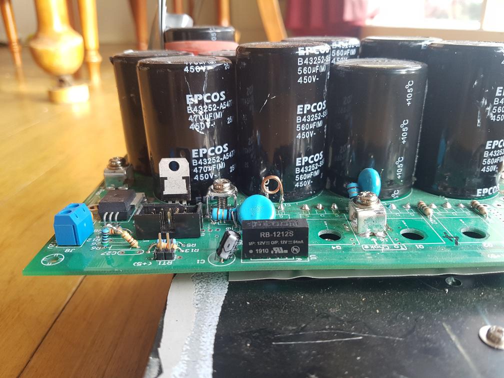

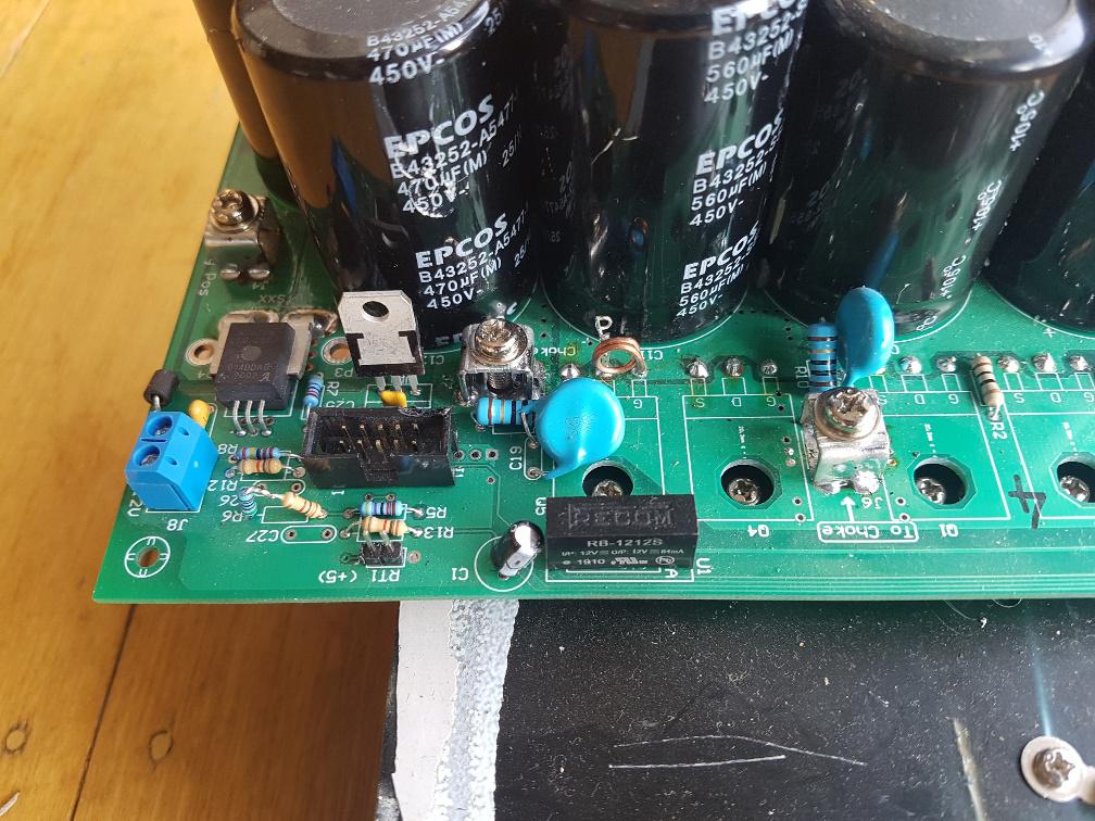

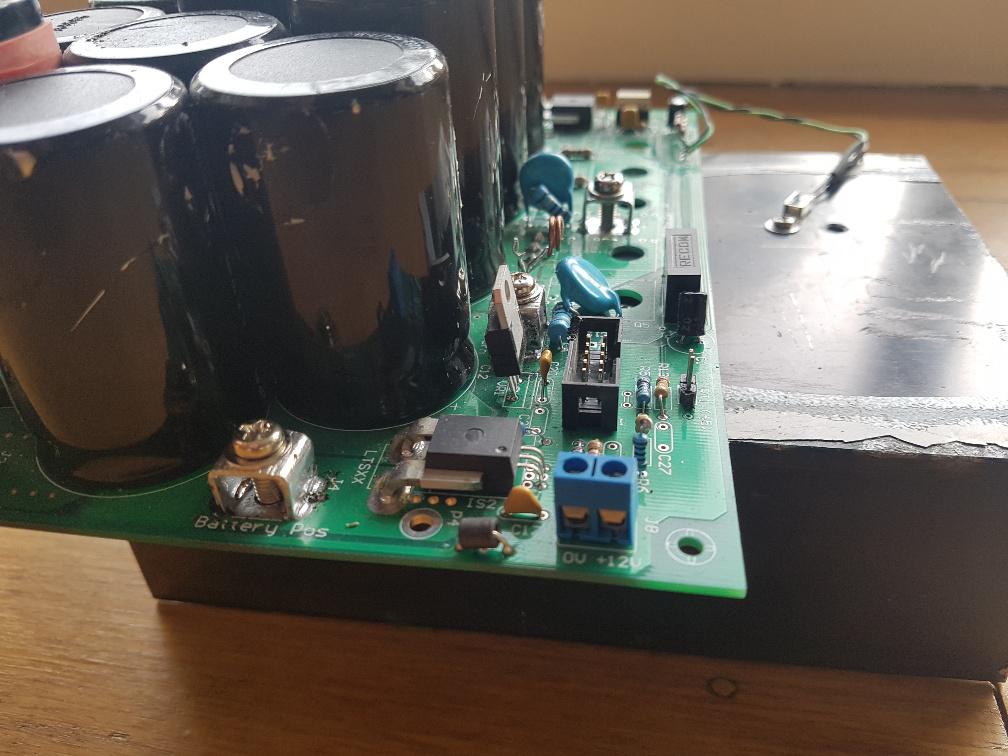

Posted: 10:49pm 04 Jun 2021

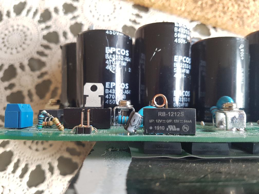

Rafael,
here are a couple of photos of the built board, to help you see what space there is
and is not.
wiseguy
Joined: 21/06/2018
Posts: 1316
Posted: 09:11am 05 Jun 2021

Also, in your above pictures I see you're using a 1W 12V-12V regulator... but if this is used for the FET gate driver wouldn't we actually need more power?
R
poida
Joined: 02/02/2017
Posts: 1485
Posted: 01:16am 24 Jun 2021
Driving the FET Gate is an operation that charges a capacitor.
So the only energy needed is to drive the 10K Gate to Source resistor
and to charge/discharge the FET's various capacitances, seen on the
Gate pin.
The time spent charging the Gate is about 600ns and average current is
about 0.5 Amp for that period of time.
See
https://www.thebackshed.com/forum/ViewTopic.php?PID=103706#103706#103706
for a typical Gate voltage during switching.
I show voltage across the Gate resistor
so we can determine the current.
(the Gate current really looks like it is charging a capacitor!
See the exponential decay?)
20KHz PWM means
20K switch events per second.
so that is a total of 20000 x 600 ns
or 0.012 seconds spent delivering this 0.5 Amp.
For the rest of the second, the Gate Drive bypass caps
will be charging from the supply.
It's about a 1% time driving the Gate and 99% of time
recharging the bypass cap.
Plus the 100% time spent powering the 10K Gate pulldowns.
There are two.
so that is 5K on 12V, 2.4mA
I reckon the gate drive current needed is
2.4mA for the two 5K and
1% of 0.5A x 2 for the two FETS = 10mA
so a total of 12.4mA @ 12V = 0.15W

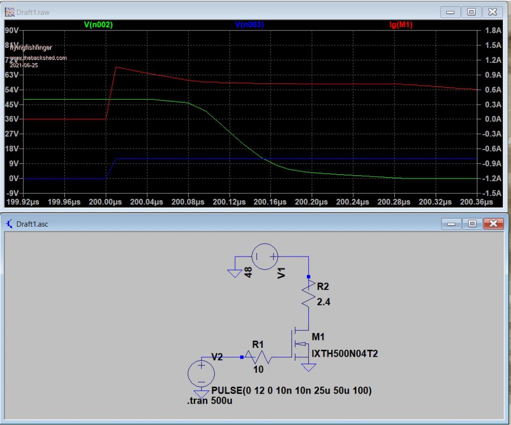

You're right, I didn't do the diligence for my part selection. Here it is:
The HY5110 has a total gate charge of 356 nC. We have a 10Ohm gate resistor in the design, so that means at 12V we can sink as much as 1.2A into EACH gate starting at t=0.
At 1.2A, we will charge 356 nC in 300 ns (ignoring the Miller plateau and the fact that charging current drops as we turn on for the moment, so this calculation will be an overestimate).
But if we have 2 (or even 3 FETs) and we want to switch them quickly, we will need 2.4 (or 3.6) amps if the driver can source this much.
The FOD3182 can source 3A of current, so let's assume we've built with 3 FETs and are maximizing this current.
That means we're delivering 36W for 0.006 seconds, for an average of 0.216W. If we populate 3 FETs and therefore also have 3.3k of pull-down, that's an additional 43mW for a grand total of 0.26W.
The 10uF output capacitor will discharge to 11.89V at every cycle.
For fun, I simulated a very similar MOSFET in LTSpice. The numbers roughly check out - the FET starts carrying the full drain current after about 300nsec, and the peak gate current is very nearly 1.2A:
Cool! Thanks for promting me to do the analysis as well.
On an unrelated note, what did you put between the FETs and the heatsink, some Sil-Pad esque material?
R

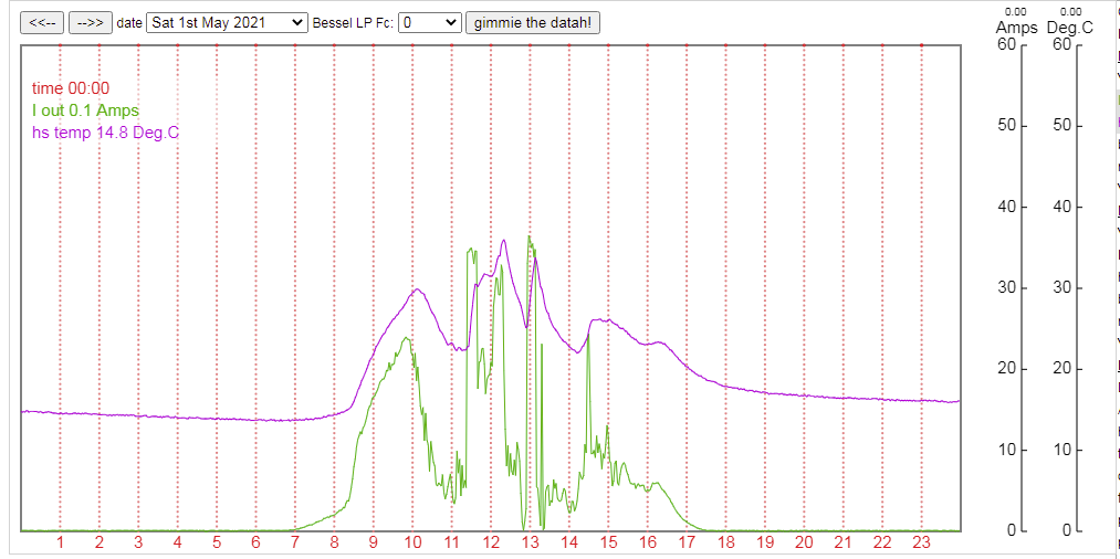

Posted: 10:33pm 24 Jun 2021
Sil-Pad. It's good enough.
The heat generation is mainly in the choke in my experience.
Typical high power testing has shown HS temps
of 40 C with a choke going to 50 C.
These temperatures are attained only after an hour or so at 2kW +
The mppt firmware will reduce output power linearly as the HS temp
exceeds a user defined temperature. I think I use 60C as the start point
and 70C as the end point. Power will be 100% converted at 60C and lower
and then it will be reduced to zero at 70C, following a linear rate of change.
This makes it nearly pointless to have a fan on the heatsink.
I found HS orientation to be "worth" a fan if you have the HS fins
vertically aligned to allow air movement up and out the top.
here is some data from my home system.
The output current and HS temperature for the mppt
connected to the 3kW North facing array.
I see no way the HS will exceed 60 C even if running at 40 Amps all day.
But this of course is highly dependent upon the HS size and
the HS used with this mppt is the same size as that shown in the
above photos.

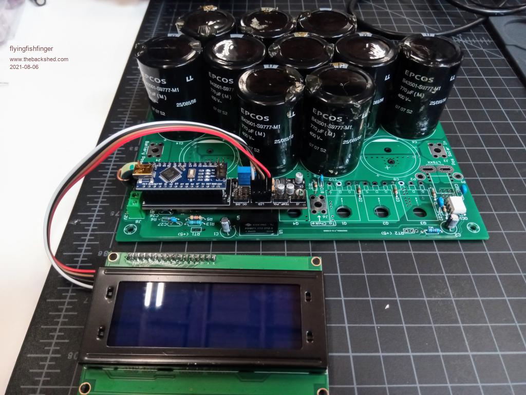

Sneak peek - still need to find wire to wind my choke and I don't really have a useable heatsink for the FETs :/
The LCD works from the controller board, but I haven't tested anything else yet...
R
EDIT: Shattered one of my new cores trying to gap it, guess testing is going to have to wait...
