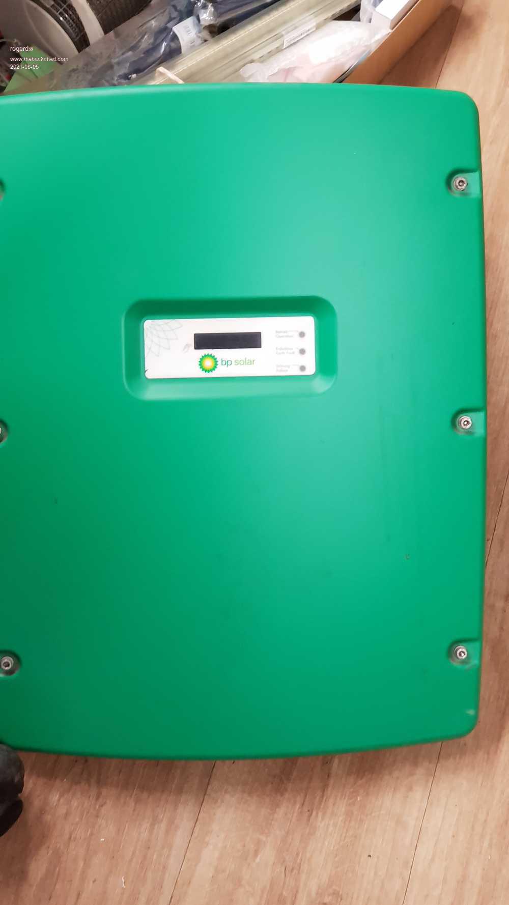

I went to order some sheet metal and have some bending done for my solar heater project and the guy was quite interested and asked lots of questions. Seems he lives off grid out in the scrub and has an interest in alternative technology.
Anyway, when I said what I did for a living (repair circuit boards), he pulled out his phone to show me a photo  ...  and said he'd been looking for someone to fix the board in his inverter, but because he couldn't find anyone, he had to buy a new inverter.
He just couldn't get his head around throwing the old one away  ...  and then asked if I wanted it. Anyway, of course I took it home  ...  and after having a look, discovered that it was a 12 y/o SMA built SMC6000A Sunny Mini Central  ...  even though it was dressed up in a nice green BP Solar case. Good for 6000 watts.

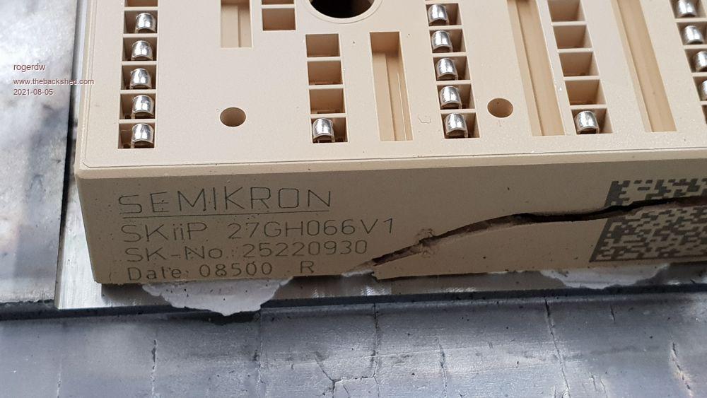

The photo he showed was of a couple smd components burnt on the main board  ...  but being alongside the main IGBT suggested that it was blown.

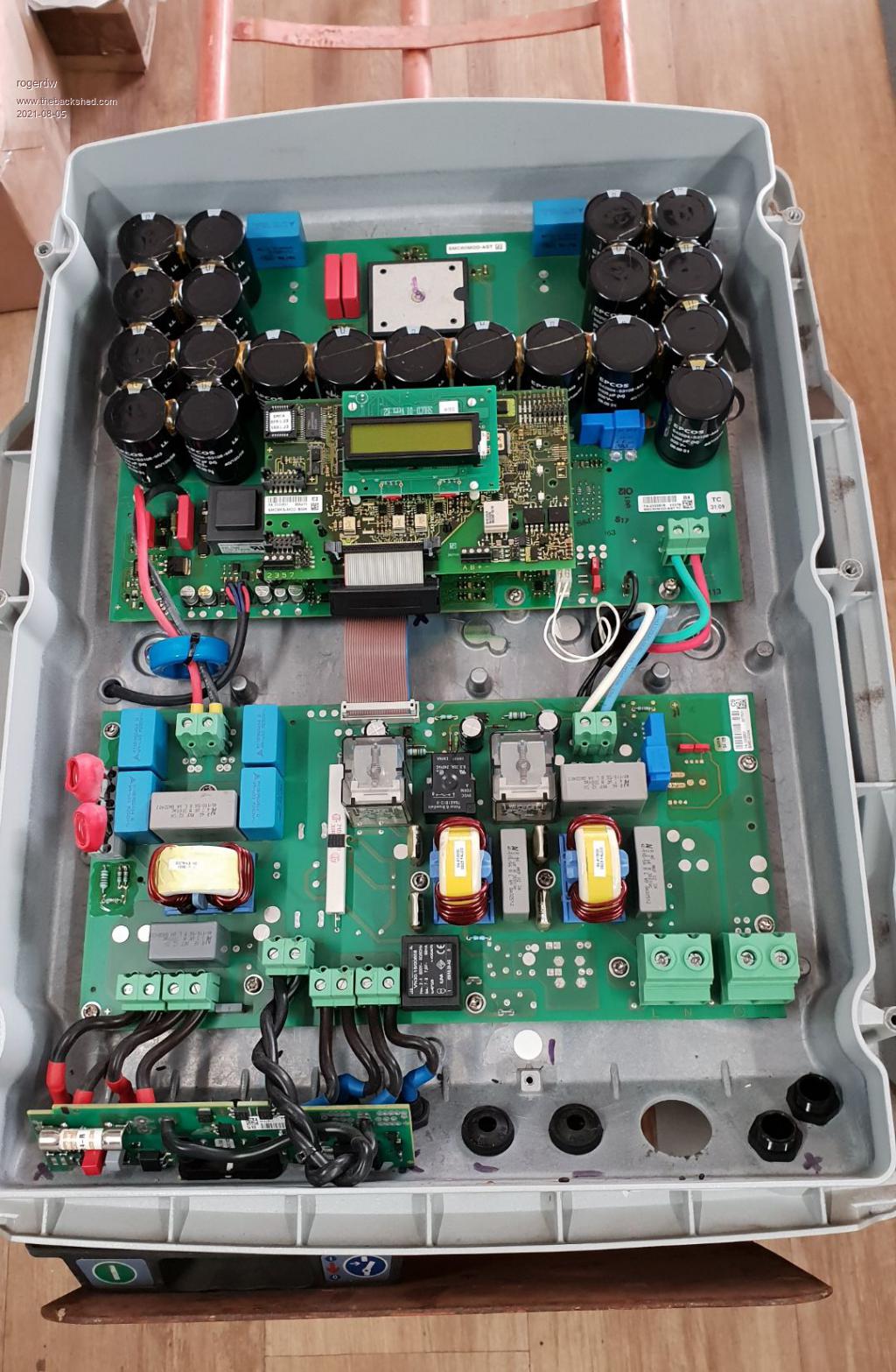

Half a dozen screws and the board was out and IGBT exposed and sure enough it had burst at the seams.

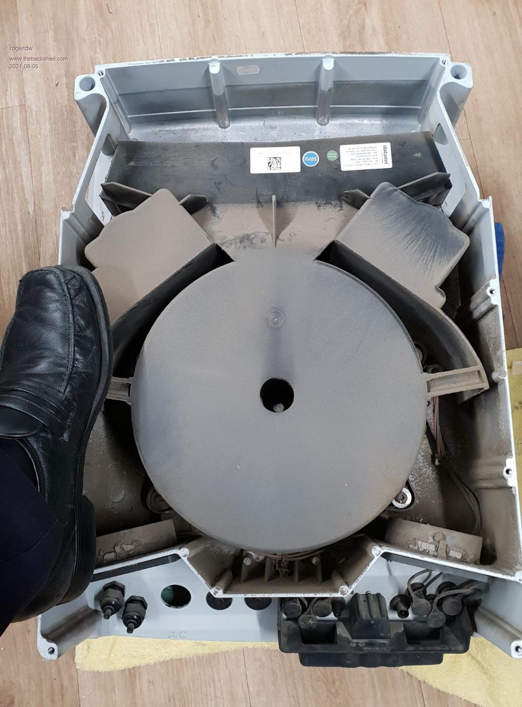

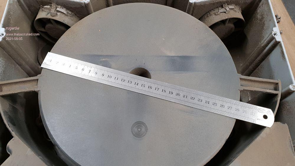

Then I realised that the front section of the unit was pretty shallow and started to wonder what was in the rear  ...  especially seeing it was so heavy  ...  63 kg.
Rolled it over and took off the nice flat aluminium cover  ...  and exposed what looked like a black plastic shroud covering the works.
Took out the half dozen screws and went to lift the cover off  ....  and realised the  cover had a toroid embedded in it from the other side  ...  and of course, unless I tipped it over again and disconnected the wires running to it, there was no way it was coming out.
There isn't really any finned heatsink at all  ...  just the huge mass of aluminium case  ...  and two fans that can blow air up either side of the toroid, past the IGBT mount position  ...  and out the sides near the top.

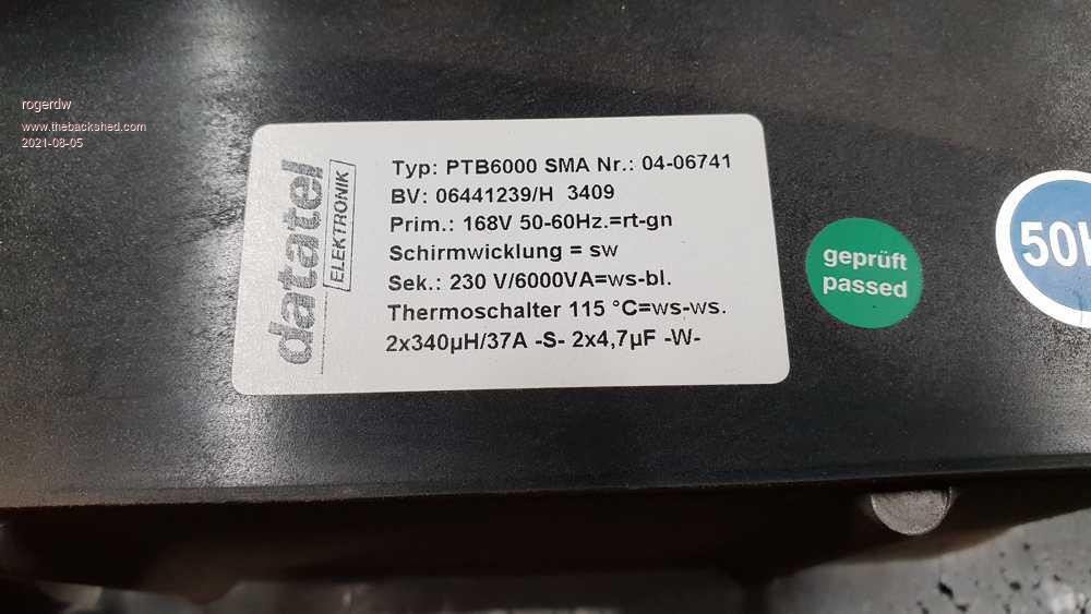

The cover also has a label showing that the tx has a 168v primary and 230v secondary at 6000va.
Of course, the other thing that struck me was the size. It must have a massive toroid glued in there.
Check out the pictures  ...  and imagine stripping a pair of these to sandwich together to rewind.
They're all 1000uF at 300v capacitors  ...  20,000uF 300v
That's my size 10.5 hoof showing here

Hi Roger, that was a good score !
What are your plans for the Toroid ?
If you intend to remove the outer winding I will be very interested to see what method you come up with, hopefully it might make the task a bit easier.
I am assuming it is one of the potted toroids inside the plastic housing ?
I just finished that exercise with a 3kW unit, the potting made it very difficult.
It took many days and made my hands bleed raw - use gloves if you go ahead with it.
Now I have a large heap of small lengths of copper wire all useless & adulterated with resin - did I mention how hard it is to separate the resin from the wire, sheesh?
I'm thinking make a fire (petrol?) to burn it all off - but its probably flame retardant too.....

  Quote  Like Nicks unit no mylar on the outer just resin straight over and throughout the winding
So there's no way to save the top winding which is the primary I assume  ...  so I wonder about feeding it through a bandsaw.
Take off slices down through the outer layers so you can get to the windings and chisel it from there  ...  like taking the peel off an orange.
Now I've had some experience winding toroids, maybe it's just as well to hack it all off down to the bare core and start afresh with new wire.
  Quote  I hated every minute of every hour I slaved to finally get to the inner layer which is intact (minus the wire I broke off so a small repair to do sometime when I can bear to look at it again).
So you're saying you need a bit of time to think about if you're prepared to strip mine for me  ...  or was that a definite no?
  Quote  I tried every solvent in my arsenal to no avail the heat gun just made it stink and hot to handle - maybe you can make it work. the only think that softened it up a bit was brake fluid but I only used a small amount. maybe a couple of litres and let it soak overnight (or a few more) might pay better dividends.
Thanks for that, it's always helpful to hear what's been tried and what definitely doesn't work  ...  and what might be worth a second look.
I wonder if there are any toroid anxiety therapists available for a session or five.

I've taken my tablet and now feel a bit better after my rant.
Quick story on why I tried brake fluid. Many years ago we owned a Mazda RX4 and it had an area of flaking paint on the bonnet. Being a bit lazy and knowing how well brake fluid strips paint I doused the bonnet in brake fluid (after taking it off the car) to save sanding it with wet and dry - seemed like a good idea at the time.... When I went to scrape off the paint I found that half of the curved profile lines of the bonnet vanished too as they had been full of epoxy filler which the brake fluid had turned to jelly. It took another 2 solid days and lots of filler, filling/sanding/profiling to get it back to the original shape.
I toyed with the idea of an angle grinder and If you were going to remove all windings I am sure it would be great. But I did not want to damage the under winding so tried to be more cautious, I've seen what impatience can do too many times. The band saw might work ok but I don't have access to one.
  rogerdw said  So you're saying you need a bit of time to think about if you're prepared to strip mine for me
 Im not actually sure there's enough time left in the universe to get to a yes answer for that one.....
  rogerdw said   Now I've had some experience winding toroids, maybe it's just as well to hack it all off down to the bare core and start afresh with new wire.
In hind sight, yes I think use an angle grinder to remove everything and start afresh - it would probably be faster and gives you an added option to stack 2 cores and have a very generous overload capability and reduced turns to wind albeit with a heavier core.
Edited 2021-08-10 01:46 by wiseguy
Cheers Mike

Before you do anything, try connecting up the 230v secondary to the grid, and measure the idling current. If its acceptably low, the original secondary winding might be well worth saving.

  wiseguy said  Im not actually sure there's enough time left in the universe to get to a yes answer for that one.....
Ahh  ...  so you're saying it's a maybe?
I use an angle grinder with a cutting disk all the time  ...  very useful for steel  ...  though don't know how good it would be for copper. I also have one of those cut-off saws that is effectively a bandsaw  ...  I reckon you could slice the sides off with it still.
It's a pity I hadn't known about these big beasts before I started planning my Warpverter  ...  but I will certainly keep an eye out for another until I'm ready to start again.
And wow, 2 x 6kW cores together is serious stuff  ...  and could afford to remove some inner turns to enlarge the hole a little.
What size inverter was your toroid from Mike?
  Warpspeed said  Before you do anything, try connecting up the 230v secondary to the grid, and measure the idling current. If its acceptably low, the original secondary winding might be well worth saving.
Yeah, I'd definitely do that before taking to it with my saw. It would be a real struggle to wreck it  ...  I hate chopping up perfectly good stuff.

Sorry for the late reply. My toroid was from a 2.5kW inverter so my suggestion of stacking 2 cores was really referring to my situation & others that haven't had luck finding  a decent core like your 6kw toroid.  It seems that 1.6 - 3kW are much easier to find.
I like your optimism and positive approach, when Tinker told me that winding your own toroid was like "a walk in the park" I asked him if he could take a walk in the park for me - he didn't take me up on that either.
