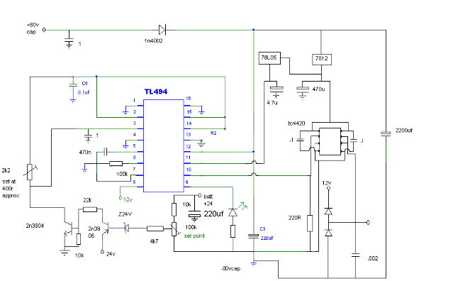

putting the plc dump experiment to bed was held up by one last shot at the pwm controller , being a sucker for punishment i couldnt let it get away with frying all those fets without one more attempt     ....so armed with some new fet driver chips and inspiration from the link below this is the new fat free version
http://www.fieldlines.com/story/2007/7/14/21428/3703
the circuit board added on the left uses comparators as a battery voltage monitor and a heatsink temp switch for the fan....so far its behaving ok dumping a nice linear 0 to 25 amps spread at 27v....if anyone could advise on drawbacks , mistakes (or anything else) in the schematic , that,d be great as i,d really like to make it as stable as possible
the 2n feedback transistors were tried on a bread board by a kind of ...put it in and feel the tempreture method ,it takes about an increase of about 1v on the battery to bring the 2n3904 on hard enough to drag the 5v chip reference v down to near zero so ramping up the pwm rate for the fets ,this is pretty quick but suits the sealed batts i use
in the schematic the frequency tuning of the chip is controlled by a 100k pot ...in this layout the fets like to pulsed at low frequency (almost audable) ...the fets could go from being very happy to really pissed off if the frequency was to highEdited by niall1 2009-03-26
niall

Hi Niall,
I am surprised that you need a fan on the mosfets. The 6 mosfets should have only a few watts dissipation each.   Most [>95%] of the power should be dissipated in the load resistor.
I had a similar single set point control on my battery. I now have a battery maintenance system, that gives Boost, float, absorbtion and equalize programmed voltages and boost and absorbtion times programmed.
Batteries will reduce capacity if they are treated badly in the charging area.
Gordon.

Hi Niall,
I don't drive a mosfet driver this way. The 2k2 pulldown resistor is very slow. The 4420 is a level shifter and works best with a digital 0-5V input level. The output changes to a high when the input transitions through 2-3V and low when input transitions through 3-2V. There is no point in using 12V input logic levels to the 4420. The heating in the mosfets is caused by the slowly changing input to the mosfet driver during the turn OFF phase. A mosfet works best with fast on/fast off switching of course. You would be better to use 5V for the open collector on the 494 and reverse the logic. The irf640 is a fairly old device and will perform better at 0-15V gate voltages. The 4420 is good for this.
The only redeeming point of slowly switching a mosfet is a reduction of RFI, at the expense of switching component, heating. In this case you are just heating a wire, so no big deal to heat the heatsink as well.
You will only see the switching waveform with a CRO, or DSO, or similar instrument.
Gordon.

hi Gordan
thanks for the explaination ! for me the data sheets often have too much info on how these things work
i,ve made the following changes
5v on the 494 collector..............
pull down resistor on the ic input is now 470R
hope this is right

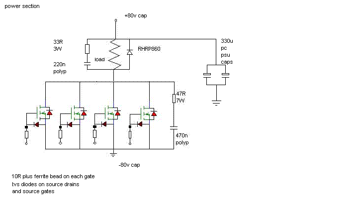

march latest circuit
edit april (irc and buildyourownturbine mods)
replaced battery with 80v 10,000uf cap ...the 47R resistor was added after the 470n cap started to swell
..this seems to help the new cap stay cool while the resistor heats up ..i seen similar things on scraped power supply fets ...have no idea how it works
also the freewheel diode on the load gets hot when the controllers dumping large currents or a steady mid range ,i think theres either voltage spikes being created by my type of load
(now fully covered with stainless wire)
or the poly cap across it is affecting the diode ...
Edited by niall1 2009-04-24

Hi Niall,
You seem to have shares in the 3terminal regulator market. There is a 5V reference supply built into the 494, and the 4420 only needs a bypassed zener supply. You don't need to operate over a wide voltage range, and you only need low currents, so a resistor/zener reg is fine for the 4420. In this appliucation, reversed logic may be compromised by the dead timing of the chip.
The success will be determined by reduced power dissipated in the mosfets. I only use heatsinks as a last resort in my designs. SMD components are difficult to heatsink as well.
Gordon.

just to finish off the thread heres the the latest (and final ...) attempt at the dump load circuit
no tweaks that i could do would bring the excess heat generated by the fets down ...so i attached the small heatsink to the chassis of a much bigger one ( old audio amp ) ...overkill , most definately ..... ...but it certainly keeps the fets cool
the controller is earning its keep ,directly connected between the mill and air heater dump ...(no buffer cap now) , if its dumping hard (500 - 1kw) the temp close to the fets hits about 40 c , if it manages to get above that the fan kicks in an out and holds the temp at 40
i figure keeping the fets as close as possible to their ideal temp will help them in this set up
thanks for all the tips ...
