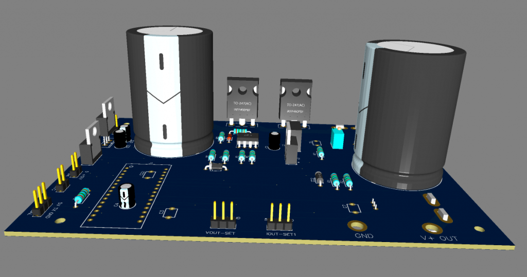

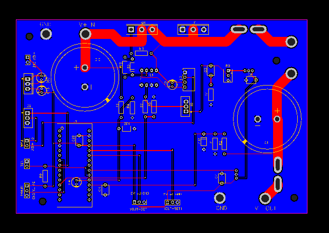

I have a need for a sort of dumb, slow is OK, close enough is good enough
power supply that can do 10 or 15 Amps at up to 100V
55V at 10-15 Amps for inverter testing
100V at 10 Amps for mppt testing
54.6V for ebike battery charging at 5A or 10A or even at 1C which
would be 20A
I based it on the mppt but only need 1 FET and one diode.
It incorporates the Hall type current sensor short circuit protection
I have just developed.
Runs on a Nano (of course) which lets me make it more than a charger or
simple PS. It can do constant power if I want (mppt testing...)
Only bits I needed to buy were the Allegro current sensors.

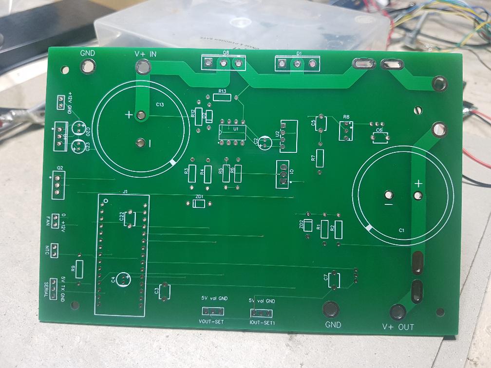

6 days from uploading to jclpcb to having the result in my hand.
It looks like this.
the actual pcb is:
the result will be:
the schemeo:
Schematic_dc-dc supply_2021-10-28.pdf
It's not really special or warranting a post here.
I just wanted to tell someone that I find it astonishing to have a
pcb for my power supply within 6 days.
No hassles. Just $38 for 5. This is cheap and good quality and fast.
This completely nukes any idea of home brew pcb production.
The PS will have a 20x4 LCD showing
Vin   cc/cv
Vout  Iout
Vset  Iset
Watts   Amp.hrs
The setting will be from 2 single turn pots.
Output voltage is not important and when charging the
LiPo ebike battery I willset it at 54.0V to allow for a little inaccuracy
in the design.
DC supply comes from the left over toroid out of the dead Victron inverter
plus a diode bridge. Put a few secondaries in series and I get 100V at 10A
Cooling will be a ex-PC cpu cooler with fan module.
This will be driven by the nano and a 10K NTC thermistor.
All the usual stuff.
But I have wanted a bigger PS for ages.
And thought why not just make it?

It works.
about 95% conversion efficiency (+/- a couple, likely minus)
30.3V 2.63A in
12.7V 6 A out
The heatsink still cold as after 20 minutes
All I need.
Of course the conversion efficiency will drop a lot when I feed it 100V
and draw 12V output.
I am thinking of switching the various secondary winding's into
the input as the set point voltage changes.
This to keep Vin a bit more than Vout and so conversion efficiency
very high.
