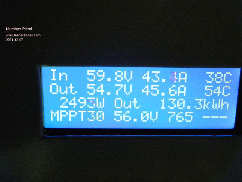

What would the display show if there was a program shut down due an over/current/ temperature/ voltage?
Reason for asking is that I was greeted twice by a plain blue screen with no info showing.
Both times happened after the unit was passing more than 40 amps, about 2.5Kw when I looked last.
Load was two aircon's and two fridges and some low power stuff. Fairly warm day here, about 32 degrees in my shed where the MPPT is located.
On both times I got it going again by resetting the brain Nano.
After the first event I lowered the fan trigger threshold to about 45 degrees, the fan was running before the second event with heatsink & choke temperature showing a little over 40 degrees (the choke is always a little hotter as its located directly at the top of the heatsink fins).
I'm leaving the cover off for the time being, to see if its a heat related problem.
Otherwise this MPPT is performing very well, has no problem powering my house while keeping the batteries full at the same time.

"the next blank screen" happened this morning. My MPPT was charging fine when I went out for my walk but I was greeted by the dreaded blank screen one hour later when I got back.
The battery voltage then was 56V, so my MPPT was at the absorbing state.
There were still ~10A flowing into the battery bank which is about normal when absorbing.
This means the brain nano was doing its job just fine, just I could not see on the display what it was doing .
I have now fitted the suggested ferrite beads and also a 10uF capacitor at the DC input to the display module.
Hopefully that fixed it

So the display has just gone blank again!! This time while I was watching the display.
And that despite fitting the suggested ferrite beads yesterday.
It  happens just as the nano changes the charging regime from MPPT to Absorb. That occurs when the battery voltage reaches 56.00V. Charging current before the event was 41A. Choke temperature cycled between 49 degrees (fan on) and 41 degrees (fan off).
Heatsink temperature was 32 degrees.
The unit was still charging at over 20 Amps on my clamp meter before I reset the nanos.
Its a real nuisance having to open the case to reset the brain nano and the display nano.
I'm thinking of fitting eternal reset buttons for these . Should I buy another display? If so, which one works most reliably as I have no idea how to choose from the many offered on ebay.

Posted: 10:28am 07 Dec 2021
I think  its fixed now.
Very peculiar fault, never came across anything like it before.
The MPPT unit would run fine without its cover. Putting the cover on caused the LCD display to go blank after heavy current charging.
Aaron suggested to insulate the metal cover so it does not touch the metal frame of the LCD. Did that, made no difference.
But I noticed when I carefully replaced the cover the LCD was OK until the very final position of the cover.
So it turned out not to be an electrical connection to nor a mechanical disturbance of the LCD frame but the *proximity* of the cover to the LCD.
Simple solution, machined off 2mm from the nylon spacers that hold the LCD display module.
There is now a 2mm gap between the LCD and the MPPT metal cover. This is not enough to make reading the display difficult through the cover cutout.
But it made my blank screen problem go away .
My guess is that some kind of capacitive coupling upset the LCD display.

  phil99 said  "Strangely, its the choke that gets hot"
Sounds like the core material does not like the high frequency, or it is going into saturation causing larger hysteresis power loss.
I'm not sure about the frequency but they are the same cores poida used.
I tested them for saturation and this occurs past 75Amps, well above the expected MPPT current, with the 20 turn coil I used.
An other observation, on saturation on my tester that choke squeals loudly. In the MPPt its completely silent.
