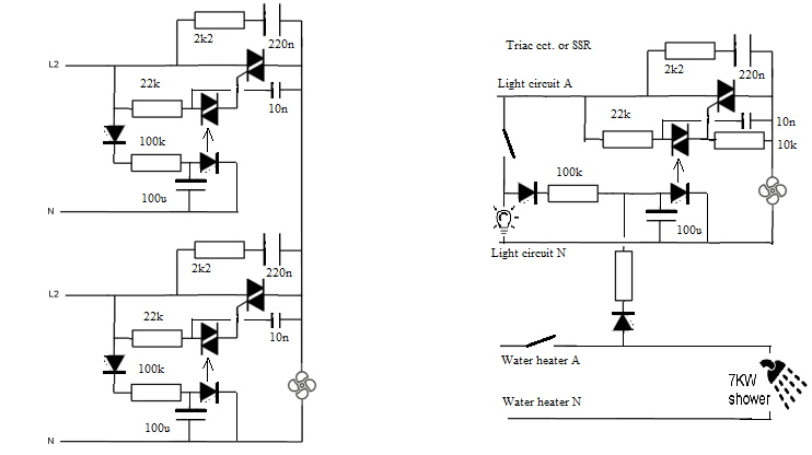

I have a refurb of a bathroom coming up. Currently there is an extractor fan (about 10W) that is slaved to the light circuit. What this means is that in order to have the fan on, you have to have the light on and during the day I really hate having to do that just to vent the steam from the shower.

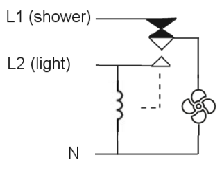

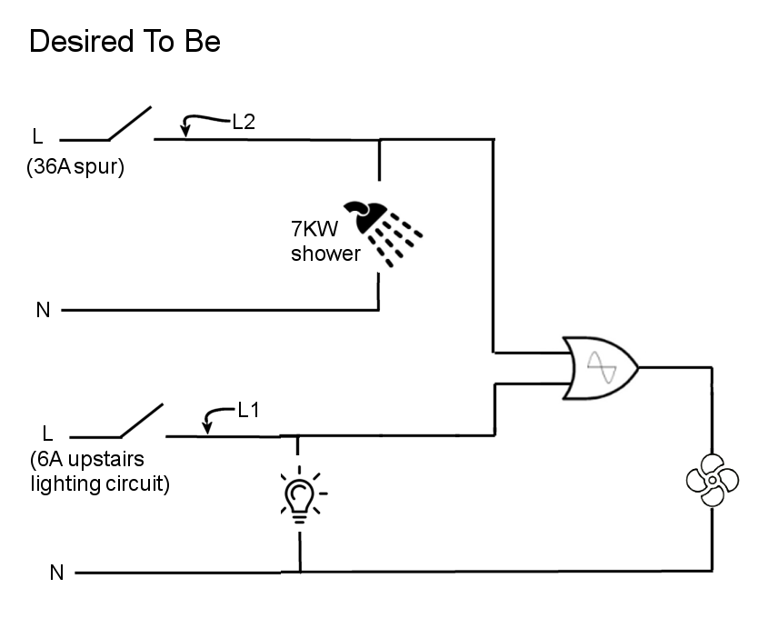

I have been tossing the idea around in my head for a "Mains OR gate" - a circuit that will take mains from either the lighting or the shower circuit to power the extractor fan.
Logically this is what I am thinking of:
L1 and L2 are the shower and lighting circuits, Lc is the common mains output to drive the extractor fan. Neither input mains must back-feed to the other circuit - I don't want the lights coming on with the shower or worse trying to power the shower from a 6A lighting circuit.
Using a mains relay/contactor it is very straightforward:
but... I want to avoid things that go clunk if possible. It has my brain tied in knots a bit and just when I think I have it I realise there is some problem which breaks the rules. I am convinced there is a triac matrix in there somewhere but I can't quite grab it. Anyone here got some ideas?
All input gratefully received, even straight abuse    but please don't go down the "regs" route, I know all about that stuff, this is a mental exercise.

I think "Clunk" is simplest, use 2 diodes connected to L1 and L2 to power your fan relay coil; the fan motor itself connected to another fused circuit L3 via the relay contacts.

A triac is quite common in ordinary fans for switching speed and rotation on/off.
Another thought, there was some sensor light's and some others that had, 2 working modes, turn on for first mode, turn off the immediately back on for the other mode, haven't opened up such a device to see how that works.....but that option would be useful for the fan light combination.

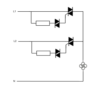

@Aaron your comment pushed me to think more about the triac thing. What is wrong with this picture? (could probably dispense with the two diacs but just in case there is some hum, don't want false triggering.)
L1 and L2 are in-phase so if both are live, it should be OK. My concern would be with local voltage drop - the shower circuit is 7KW.

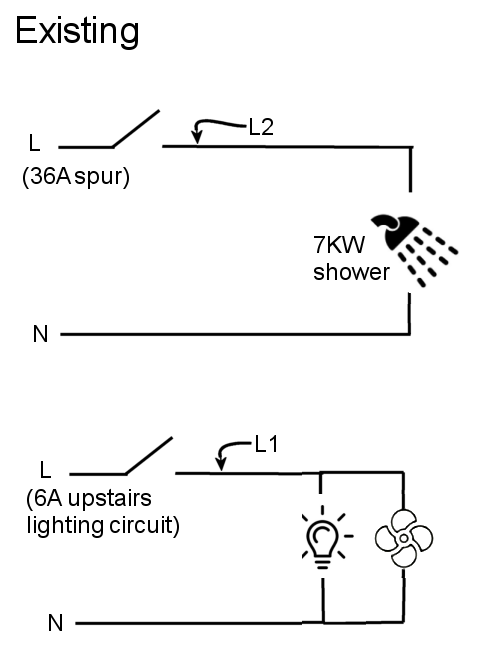

It's all getting a bit foggy with various suggestions but these two diagrams show precisely the as-is and to-be. Don't want any more switches, the solution I have in mind simply draws power to the fan from whichever circuit is live. That way if the light comes on so does the fan. Likewise if the shower is running the fan is venting the steam - that functionality is provided by my "logical mains OR" in the middle.
A SPDT relay would do it but i am trying to avoid mechanical components. I am fairly certain my triac solution above will do what I want which I intend to ascertain this weekend (now the weather is warming up a bit and the shed isn't polar), but there are better brains than mine that could red-flag it - I am not a "power" designer.

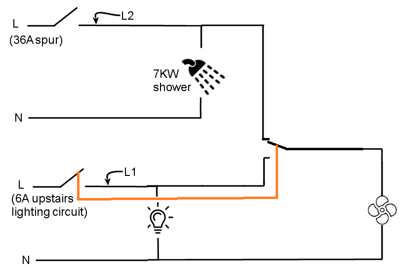

If you can replace the light switch with a double pole switch with no and nc contacts it is doable.
Not sure if they exist in domestic formats.

Ah! now that is smart thinking, it is going back to the idea of the relay but using the light switch to do the grunt work.
The light switch is a standard pull cord type and the actual mechanism in most switches is a SP changeover with a NC & NO output - fairly standard in light switches here. I will check to see if I can find a pull cord switch that supports two circuits - doesn't sound a big ask.

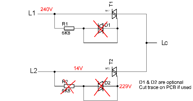

I knocked up the triac circuit today and it definitely acts as expected for functionality, i.e. Lc= (L1 OR L2). tested at full mains voltage with an 11W load.
So the actual circuit I used was this:
I don't have any diacs ATM so D1 & D2 were omitted.
When a main input (L1) was live, I found there was a mains voltage on the other, disconnected mains input (L2) - so it immediately breaks the rule that it must not back-feed. I lifted R2 to remove any triggering and found that there was 229V on the gate and 14V back-feeding out of T2 MT2. Somehow the triac is self-triggering but it seems partial - where is that 14V coming from?
I am at a loss as to why this is happening. Like I said, I am not a "power" designer and the only thing I can think of is that when T2 MT1 goes to mains, I am in one of the weird triggering modes of the triac and that results in current flow through the gate, back through R2 and then to trigger the triac at full potential.
When I get more time I will put the scope over it to get a better idea what those voltages look like.
Shame, but I am at the limit of my understanding of triacs.
oh well, not the first show-stopper I've encountered and an enjoyable afternoon just the same.
I have some BT3 diacs on the way - I will try again with them in circuit but I can't really see how they will help. Vbo of ~32V is easily whacked by the 229V.

1. The self triggering of the triac with an open circuit gate is likely due to capacitance between MT2 and gate providing gate current. This effect is reduced by adding a bleed resistor (10k) between MT1 and gate and by adding a "snubber" from MT2 to MT1. It shunt transients away from the internal capacitance, a 100nF and 100R in series  is usual for a resistive load. For an inductive load such as a fan I have found 220nF in series with 2k2 is more reliable.
2. As you have found the diac serves no purpose on its own. Its purpose is to discharge a capacitor into the gate to provide reliable triggering, especially for triacs with low gate sensitivity. In your circuit a 10nF should be connected from the junction of the resistor and diac to MT1. The diac has a "breakover" voltage of about 30V, switching from insulator to conductor and dumping the capacitor charge into the gate.
3. As you have found whenever one switch is on and the other off both triacs will switch on. The path through the "off" load (water heater or light) to neutral provides the voltage to switch the second one on.
You can't make a simple AC equivalent of a diode OR gate with triacs alone. A more complicated triggering arrangement will be needed.

Perhaps replace the diacs with pair of triac opto isolators or use a pair of SSRs. If you have easy access to the un-switched active on the light circuit only one may be needed. The cathodes of the IR LEDs go to neutral, 100uF caps from anodes to cathodes and series diodes and 100ks from anodes to the light and the heater.
If your switchboard has safety switches cross connecting circuits will cause tripping. The single SSR or triac circuit should be ok.
I have just noticed the triac gates are drawn on the wrong ends. Going senile, careless copy-and-paste.
