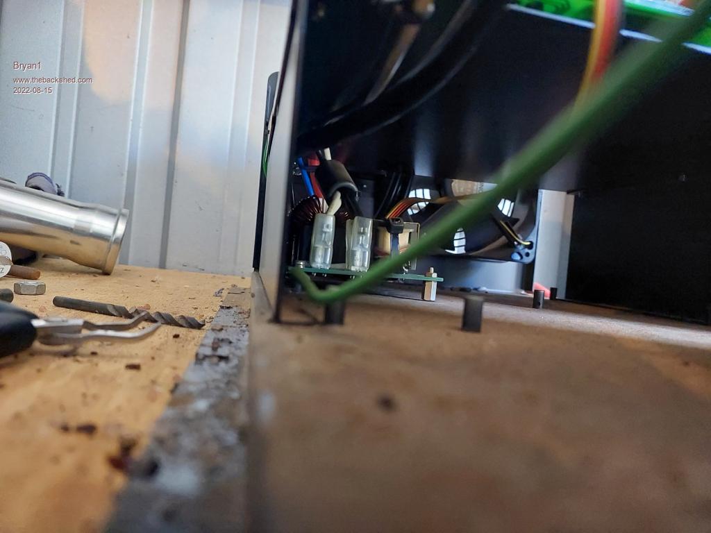

           Over the last few days when I turn on this inverter it has gone into fault mode saying over current and no green power then it comes good. It did it again this morning so I took the cover off to find that relay that was going ratta tat tat when the fault mode was going.
sure enough there is a relay behind the transformer on that board but in order to get that board out means a strip down.

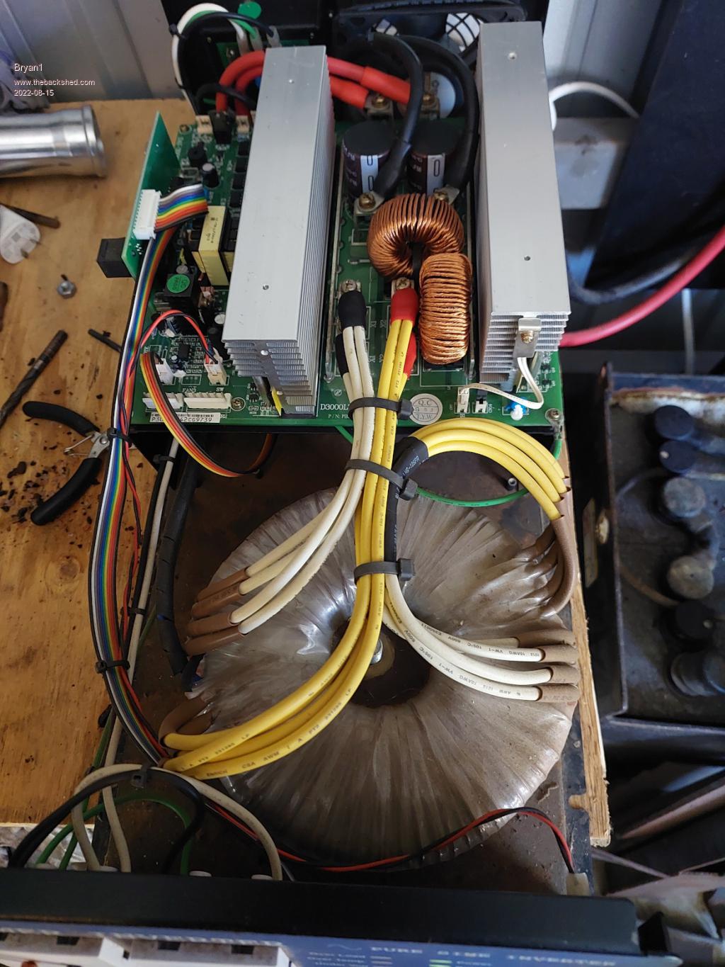

Here is a pic of the inverter
As we can see the windings are 4 inhand and 2 chokes are on the input where only 2 off 32 volt 15,000Uf caps are present.

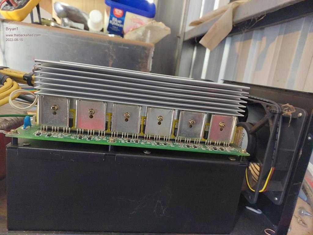

There are 2 bank of mosfets

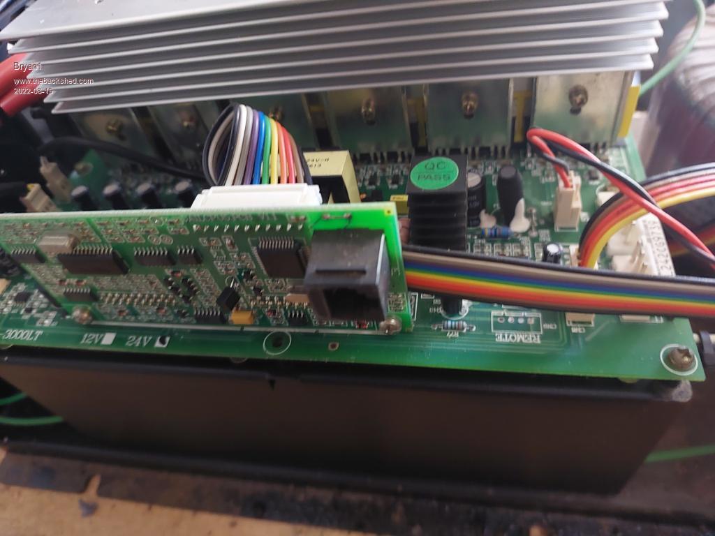

In this pic we can see the control card
I am hoping someone from the brains trust can explain the design of this inverter and maybe a close to 20 year old design could be a different way to make an inverter.

If you can find a CT (current transformer) check the Burden resistor, diodes and associated resistors, there might be a trim pot there, see if those parts are in good condition or not, check values etc.
Unfortunately I think that would be too easy to find, if that is the cause of the over current fault, its likely something more difficult to find and fix.
