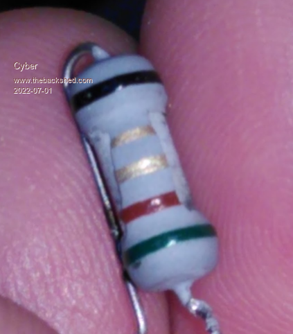

Hello. This will sound strange, but I can't identify resistor value.
Color stripes are: green, brown, golden, golden, black.
In all manuals I checked golden stripes can't be in the middle, so I'm confused.
Please help.

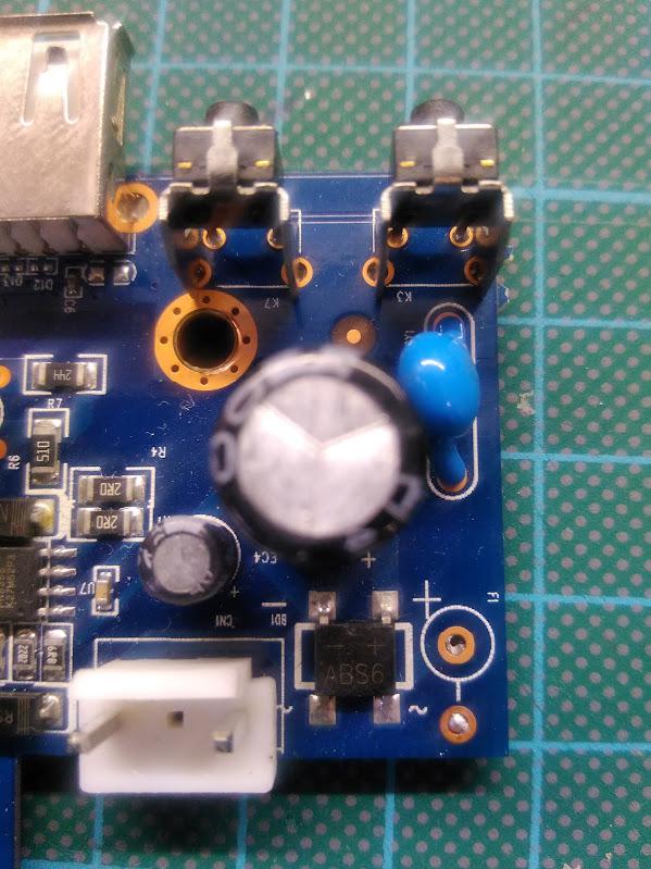

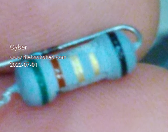

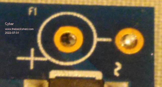

Here are this resistor photos.
Also I notice that it is marked as F1 (fuse?) on PCB which is also odd.

I was thinking- is it actually a resistor? Is it in a part of the circuit where a fuse woukd make sense?
The phrase fusible resistor also springs to mind, but I'm not very knowledgeable on what the colour code would mean.

Thank you for hint! Here is what I googled: "If an additional fifth band is black, the resistor is wirewound resistor. If an additional fifth band is white, the resistor is fusible resistor."
Looks like I have wirewound resistor.

So it looks like it is 5.1 Ohm wirewound resistor.

"If an additional fifth band is white, the resistor is a fusible resistor."
I just learned something new too !! Have used/replaced many but never noticed a white band..... I am guilty of usually just confirming their value with a meter and ignoring the bands.
These days some resistors with 5 or 6 bands can make a sensible sounding value reading from either end so checking with a meter is a good thing.

I think its a fuse.
1 its labeled F1 on the PCB
2 it appears to connect to the ac side of a bridge rectifier
As for the value you will need to look at the components its protecting and the devises rated load.

On of the legs of the failed "resistor" goes directly to AC power input. So it does look like it works as a fuse. This is the first time a see something that looks like a regular resistor to act like a fuse. )

Looks like it's wired like this:
      o-----------------------| ~    + |--------
 AC                           |        |
input                         |  ABS6  |
      o---------| F1 |--------| ~    - |--------

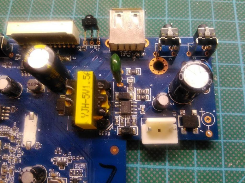

First component I would check is the diode to the left hand side of the transformer in the second picture, it may be shorted. The second item is to check the bridge diode next to the fusible resistor. The little 7 pin switchmode IC sees to have something on the top of the body just near pin 6 - is that a small crack (if it is that will be the answer too). Good luck with it!

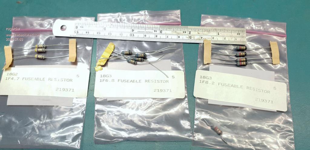

Well I'll stick my neck out and tell you it's a fusible resistor.
Apart from checking the bridge rectifier, P/S IC and closeby diodes for shorts, I'd replace it (shield my eyes) and see what happens.
And if I was in a hurry and didn't have any fusible resistors, I'd stick a sensibly sized fuse or even a standard resistor temporarily, to see if that's all that's wrong.
I have a drawer full of 1/2 watt, 1, 2 and 3 watt fusible resistors from an earlier work life.
The photo shows the colours and the related values and these too have two gold lines and then a final black. These are 1 watt resistors and the bodies are close to 10mm long

In switch-mode supplies it is often the HV switching transistor or IC that is short circuit. If the IC has failed check the main filter capacitor, if it's value has fallen too low or it's ESR has gone too high it may be the cause.
Take extreme care when testing live circuits!
"The little 7 pin switch-mode IC seems to have something on the top of the body just near pin 6 - is that a small crack "
Zoomed in on that but the resolution isn't good enough to tell if it is a crack, soot mark or just part of the logo. Need a macro pic to be certain.

Any thunder storms around at the time of failure , you may find sum burn tracks around the RF end of the devise.
it is probably 5.2 ohm the gold / gold being x10-1 and 5% tolerance
you would need to measure its diameter and length to confirm wattage but 1w seems about right
