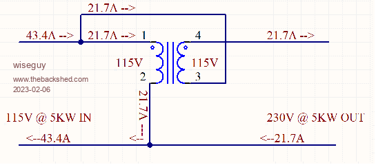

Posts: 3412
Posted: 05:33am 06 Feb 2023
  Quote  I think it is an autotransformer, so for an isolation transformer application like in an inverter it will probably have to be rated at 2500 watts.
Exactly. For a 2:1 autotransformer only half the output VA is provided by the core, the rest comes from the input.
wiseguy
Joined: 21/06/2018
Posts: 1326
Posted: 05:46am 06 Feb 2023
TinyT is right the auto-transformer only needs to be capable of 2.5kW.
For 5kW of 230 the current required is 21.7A but at 115V it is 43.4A.
The input current has two 21.7A components one for the transformer primary and the other is added to the 21.7A 115V secondary so it adds to the input voltage to equal 230V (@21.7A).
The input supplies the whole 5KW the transformer transforms 115V @ 2.5kW.
I decided to sketch it to aid with the understanding, sorry but the graphics let me down the currents do not show the dash of the A and look more like an upside down V. The transformer is drawn like a conventional tranny but the result is the same as a centre tapped auto style winding.
Edited 2023-02-06 15:47 by wiseguy
Cheers Mike
rustyrotors
Joined: 07/01/2023
Posts: 36
Posted: 12:41pm 06 Feb 2023
ok i will keep it under 2.5kw on 115v. that makes sense for reasonable heat dissipation too, probably get a bit toasty at 5kw
my local grid runs a little hot at 125V, no load pulls about 10W. I will probably run it as is, im using it to build a backup inverter
