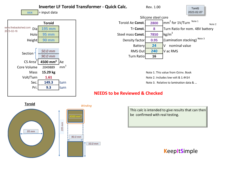

I made a quick transformer calc. in excel when I was evaluating different cores.
It doesn't include wire fill, just gives Ae, V/T & winding turns.
I would like if some experienced builders can check my calculation & constants as I don't have anything in the real world yet to verify against.

Hmmm, we moved on since that 1V/turn you mention.
To get a good low idle current it is important to calculate for a flux density of 10,000 Gauss or so.
Easy with this online: calculator
Note the units used!, especially the frequency.
Just guess a number of turns for your core area and see what the Gauss reading results.
Adjust the number of turns until the gauss reading is at or near 10,000.
Use whatever number of turns that gives for a low idling current.

I tried it a few times and could not get the numbers that I used when building my transformer, so it would be better if there was a place to enter the desired Tesla value. "Maximum Flux Density"

  Revlac said  I tried it a few times and could not get the numbers that I used when building my transformer, so it would be better if there was a place to enter the desired Tesla value. "Maximum Flux Density"
Or this one https://www.electricaltechnology.org/2014/02/maximum-flux-density-bmax-calculator.html
Not sure why that didn't work Murph Calculator
They both work the same for me Aaron. The trick is the 4 zeroes before the 5 in the frequency field.
It really is not that difficult (for me ) to guess a starting turns number. And one Tesla equals 10,000 Gauss.
What the original poster presumed is 1V per turn which might not apply to every toroidal cross section if one wants a low idle current. One tesla is a much better staring point.
It's no big deal if one turn equals 1.14V or any other not round number.
Just divide the required voltage by that V/turn number and round up to the next full turn (not possible to have fractional turns ).
1 Tesla is a good compromise figure, one could try for a lower flux density but with the extra turns required the resulting reduction in idle current gets less and less.

Thanks for having a look.
I made this calc. when I was looking at various existing cores to quickly compare & evaluate suitability to make a low power test inverter. (I like blowing up smaller stuff)
I have updated to include Bmax. (Cell D18) & sheet 2.
Yes, I have assumed some input to get results that seem reasonable(to me).
There are gaps in my knowledge waiting for the right input.
The online Bmax converters I looked at including daycounter specify Mhz , but seems the formula shown is actually hz input.?? ( I had to remove ^8) from the equation.
Sheet 1 "TXF calc"
The Volt/Turn of the calculation is based on the  Ae Constant(cell J4) that I have fudged to "adjust" the secondary turns.
I have done this just to get it working...
Sheet 2 "Bmax from Turn" the sec. turns can be explicity entered with core data from sheet 1.
I do expect the calc sheet to need some correction.
