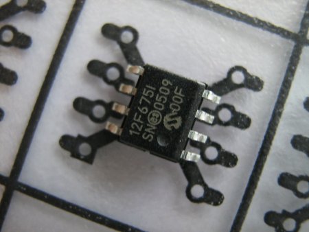

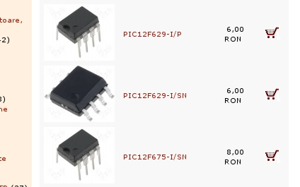

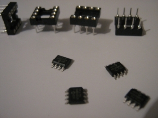

I ordered 4 x PIC12F675 with sockets. I was fooled by the image and not paid attention to notation.
So, I received this ( ) ...

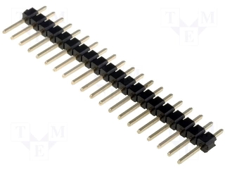

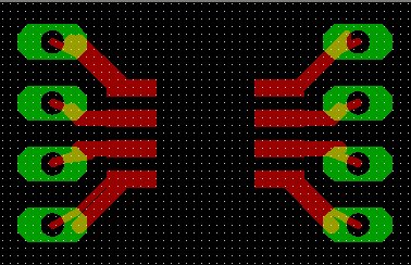

I have no choice and I must make an SMD to DIL adapter. I will use these for DIL pins
And I made my own design
But I found a better one here:
The problems are, I don't know if the second project (or any) can be made with toner transfer and if I can solder the SMD (never did it before) only with an iron solder (I can say I am a little scared - I don't want to loose the chips).Edited by vasi 2009-04-04

I checked the second design and is not good for what i have (the "A" variant). "B" variant is ok but the "portability" is broken. At least, this way can be usable. Lesson learned.

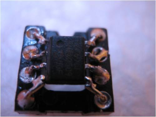

I don't see any problems with just bending pins 1,4,5,8 a little away from the adjacent pins. The SMD devices you will probably not use for production. You should be able to solder pins 2,3,6,7 directly to the socket. You then can just solder 1.4.5.8 with short links. This will give a close to std DIL pkg.

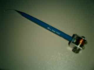

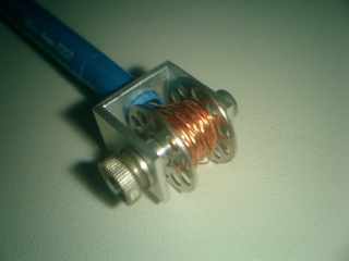

I know Gordon, it's nothing new. I've included a few pictures of my DIY wire dispenser below. At the time they asked 50 guilders for one. Seemed ridiculously expensive to me for something as simple as that, so I made my own out of a Pentel 0.7mm automatic pencil and some other odds and ends. The spool is the thingy that normally goes in a sewing machine (under the needle). My only problem with it is that it holds too little wire, I need to make a bigger spool for it someday.
What was new (to me at least) in that site is how he used such techniques for SMD too. I've routinely used SMD resistors and capacitors on perf board (e.g. SMD capacitors fit *perfectly* between the legs of a DIL IC; SMD pull-up/down resistors can be installed very conveniently too that way). But the guy in the link seems to take it all one step further and also wires up SMD ICs like that. Even the ones with smal lead-spacing...

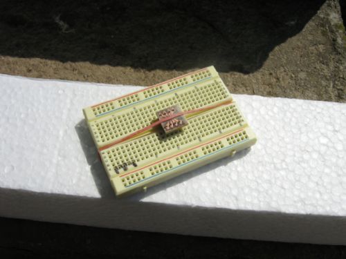

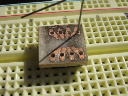

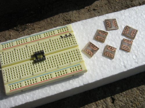

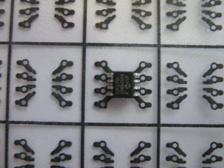

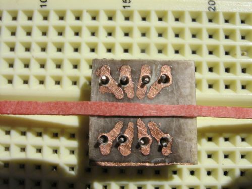

I had time to make prints on transparencies. Is more easy to design a pcb directly for smd but I want to reuse them (replace them in future with 12F629 for stepper drivers) because of their A/D converter. So it must be in a 8 pin socket.

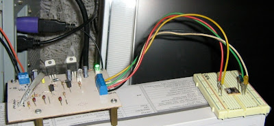

Posted: 03:41am 03 Apr 2009
Adapter is ready, not soldered the chip yet...
This is my intention:
Ready to convert my SMD pics ...

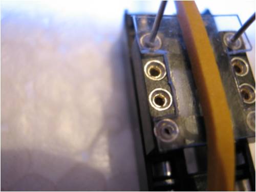

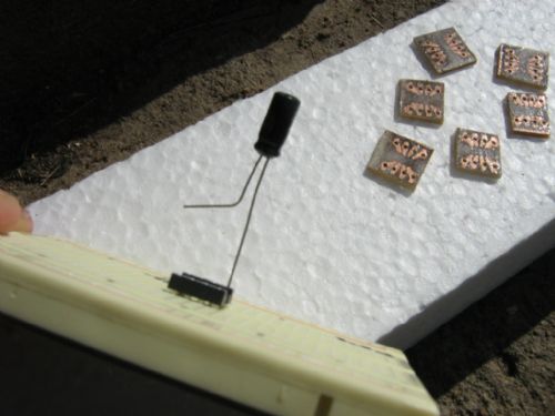

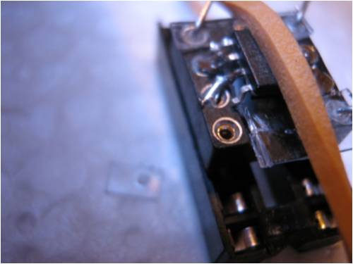

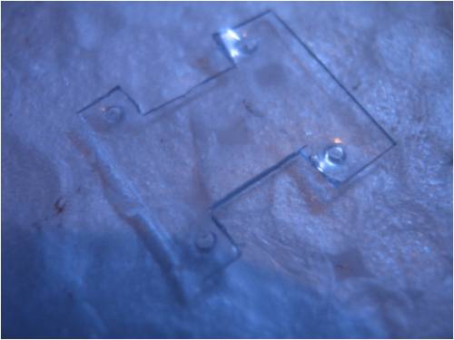

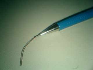

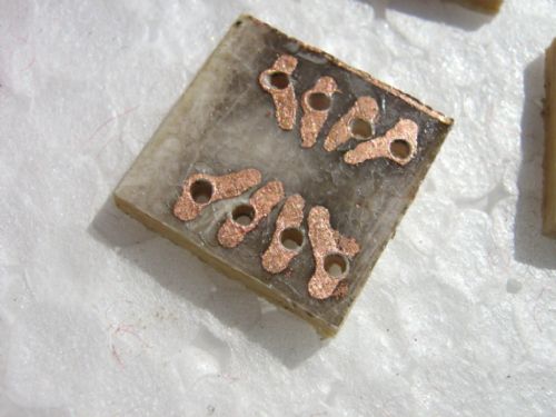

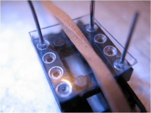

Ferric chloride was expired and lead to long time copper exposure. Also, the drill is 1 mm diameter . I applied a protective layer of rosin (which, I hope, will also help to solder - the risk is to float the trace if layer is too thick or, false soldering/connection ... ).
Tested few components to see what type is my pin donor. I selected the condenser but...
.. the macro photo revealed that the pin is too thin.

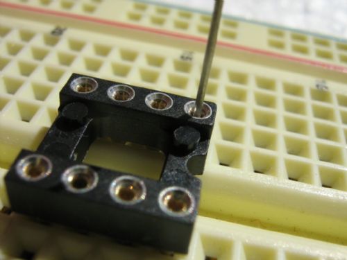

This is how pins will be inserted, then cut them to right dimension and soldering. Definitely, the pin is too thin... will try with a 0.5 watt resistor... Next time I will open my eyes before any order...

Vasi,
I'm not sure why you want to use both an 8-pin DIL socket together with your SMD-to-DIL adapter, but if you want to do it like that, try finding a different 8-pin DIL socket: not the one you have now, with the turned pins, but the cheaper variant with the pin-sockets with spring action (http://www.voti.nl/ir-3/pics/dil14-big.jpg); these will be much less critical w.r.t. wire size.
Peter.

Well, few reasons.
I really want to reuse them (many times) so, the adapter will not be soldered to pcb. I'm afraid using only the adapter, is not sufficiently resistant. The copper trace is very thin. The pin is soldered only on one side. If I press the adapter in a socket (remember, as many times as possible), the risk is flaking routes (I did not ordered that kind of pins, as in my first post - next time ...). So, I will waste a socket and the packet will be rock solid.
Of course that type of socket is better from pin size point of view but did not find it in that store where I ordered my components - or I wasn't able to find it. Plus, mine is a resistant socket and fit for "many times use - inserting/removing".
But the first reason is my lack of skills, for sure Edited by vasi 2009-04-04

  GWatPE said  I don't see any problems with just bending pins 1,4,5,8 a little away from the adjacent pins. ... You should be able to solder pins 2,3,6,7 directly to the socket. You then can just solder 1.4.5.8 with short links.
Hi Vasi,
you have made a PCB adapter. This is not really necessary. The SMD will fit across the DIL socket you have shown in the manner I have described above. You may require links to 2,3, or 6,7 depending on your soldering technique and initial placement on the socket.
Gordon.

vasi
Joined: 23/03/2007
Location: Romania
Posts: 1697
Posted: 03:17pm 03 Apr 2009
Hi Gordon,

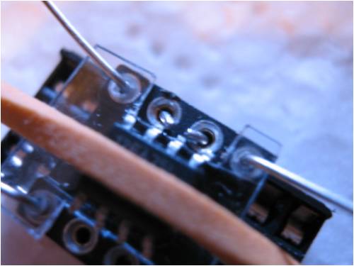

I don't have a very steady hand.. I found a way to keep the pcb steady - with elastic. I will try first this way.
On the next trial, I must find/make something to fill that central hole from socket, to use as a support for SMD. Then, I can keep it steady with elastic and use pins from condenser as links ... If is working for me, the last two pics will be soldered like this one (as you said). This variant will save pcb, acid, toner, electricity and time ...
If not, pcb adapter is the solution for me... hope will post tomorrow a photo ...
I said I'm burning to test the ICSP programmer and to program my first "raw" (not PICAXE prepared) PIC?Edited by vasi 2009-04-05
Elvish name: Mablung Miriel
Beyound Arduino Lang

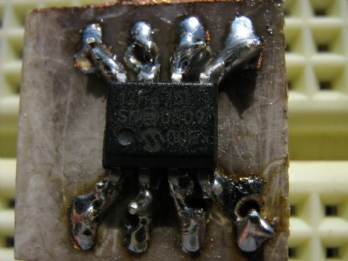

vasi
Joined: 23/03/2007
Location: Romania
Posts: 1697
Posted: 01:47am 04 Apr 2009

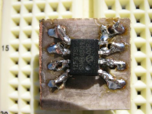

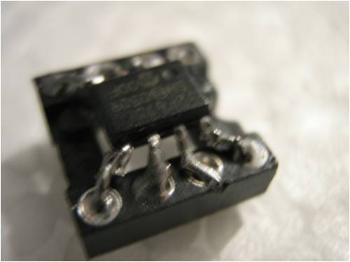

I did it!
After fixing the pcb, soldered the pins and traces, then placed the PIC, fixed with elastic and soldered...
Well, it was easy.. only the fear is big at the beginning . I used a 0.5mm rosin flux cored solder.
I will try to read the PIC with my programmer and then, will try to solder the other PIC's directly to socket.
I put too much solder on traces and positioning the PIC was a little hard on those solder bulbs... next time will be better...Edited by vasi 2009-04-05
