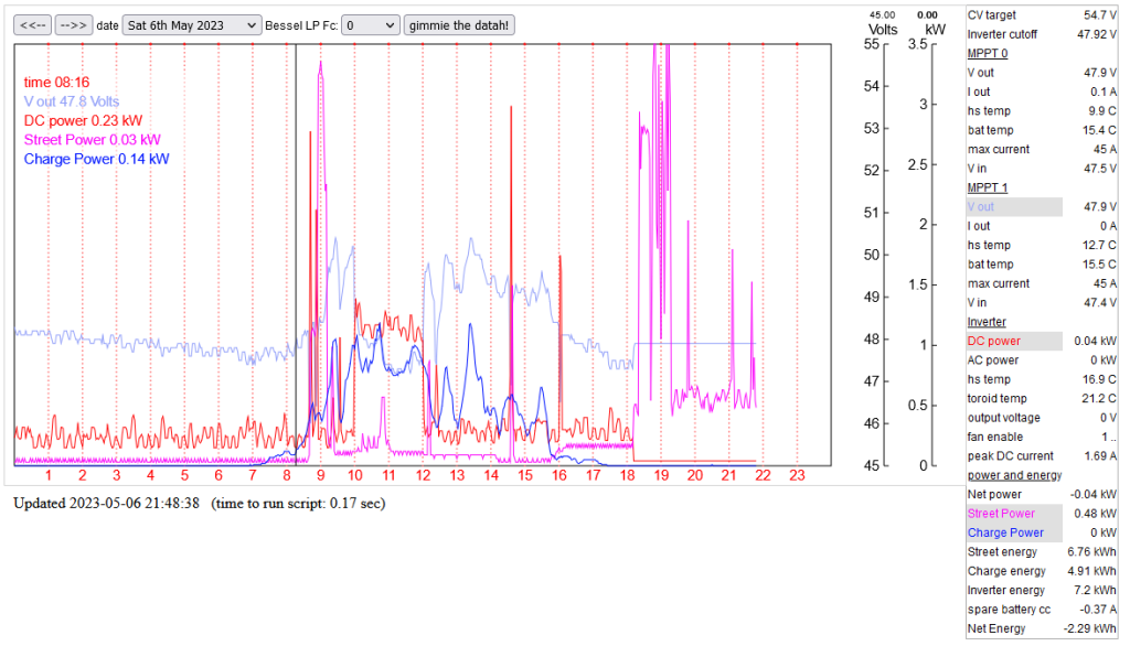

My home solar setup has data logged every 2 minutes.
I record battery voltage, charge currents, battery temp, inverter DC current,
toroid temp, etc.
I think this could be generalised for other people.

Have a look at
http://1eq2.cc/mppt/datah.php  to see what I use.
The logger will appear like this and be customisable for various people's needs.

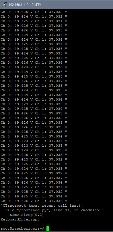

First code tests show I can get excellent repeatability with
ADC conversions using the MCP3202 ADC, a 2 channel version of the
8 channel parts I want to use.
This is the result of a simple python script to record the two channels
of the ADC and digitally remove lots of noise.
I scale the values to 0 - 60V, to simulate the voltages
from a 54V 13S Lithium battery, same as a 48V Lead Acid battery.
channel 0 seems to have a little less noise.
It appears we can expect repeatable measurements to within 0.01V
This will be perfect for monitoring the many voltages in the series connected battery.

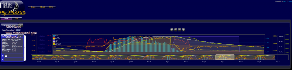

I would be very interested in this ATM I rely on the data logging of my Midnite Charge controller. However this only records it's charging and battery details. Data is uploaded once every 6 minutes to their server and can be accessed via the internet.
For me, the most important detail is the White State of Charge line. The Midnite CC counts Coulombs and has a efficiency setting for the battery to correct it for battery losses. When the battery charge changes to float the SOC is set to 100%, if the SOC was different at the time it goes to float then the efficiency setting can be changed to correct it.

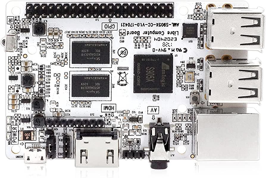

It needs to be something like
this board
which looks like this:

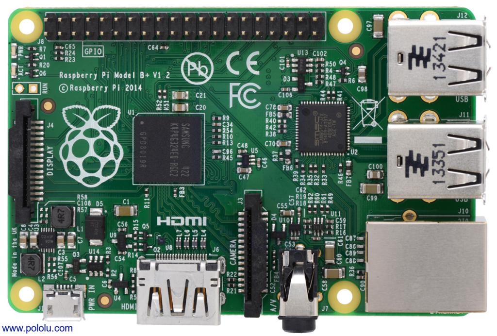

or a genuine R-PI. I have a few unused Model B+ versions and will develop the codes
using one of those
These boards have 4 USB sockets and an Ethernet connection.
I do not want to use WIFI, I find it intolerable if even a tiny amount of unreliable
connection to the network occurs. With a cable it is perfect.
