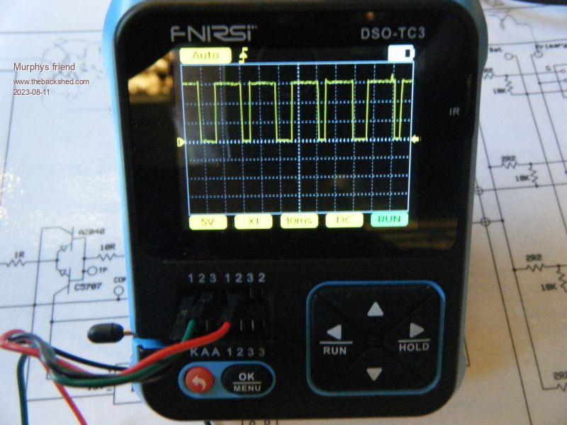

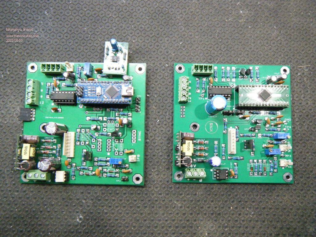

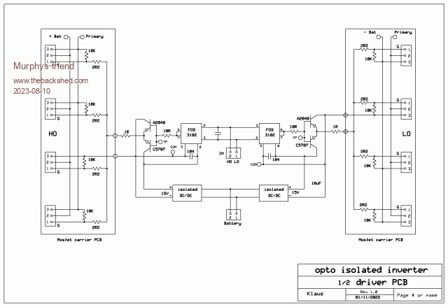

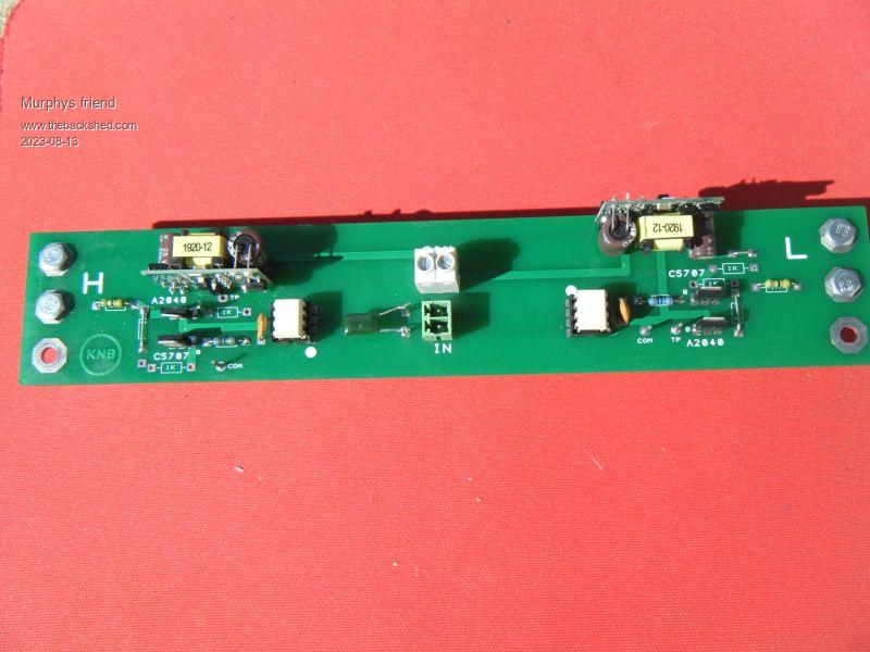

Here is a pic of the driver board, the dead time cap is next t5o the 'IN' connector.

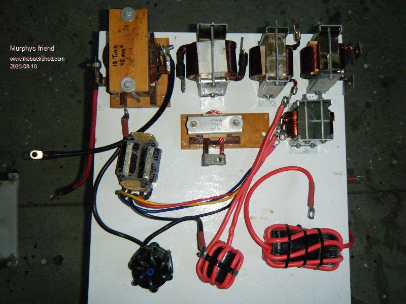

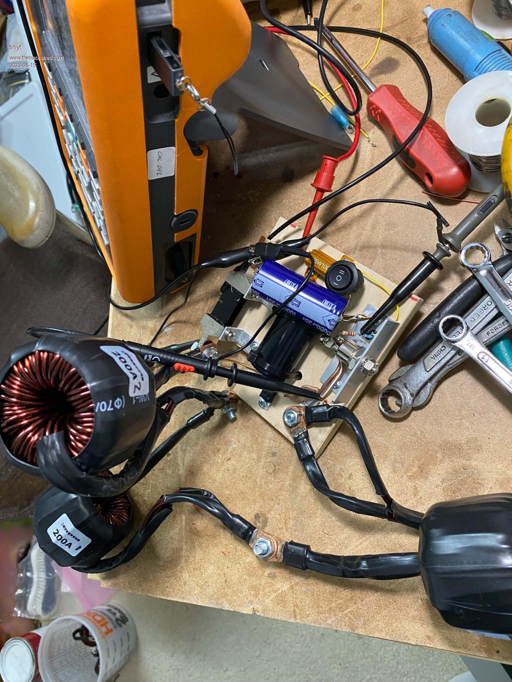

I did extensive tests of my chokes (more of that in another post) and decided to use the powdered iron ring cores for their gentle 'knee' curve. They have the added benefit of silence due no air gap buzz.

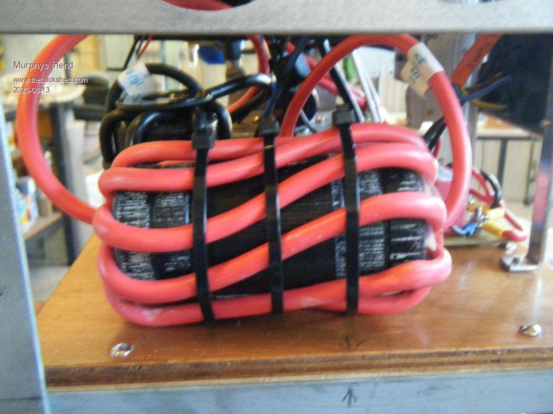

There is a choke in each of the primary legs. The red one has 8 'rings', 9 turns of 20mm sq cable and measures 100uH on my LC tester. The saturation 'knee' is around 150A.
The black choke has two CS610125 'rings', 7 turns of 20 mm sq cable and measures 62uH on my LC tester. This one also has the 'knee' at 150A.

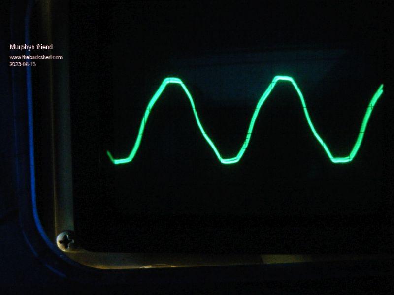

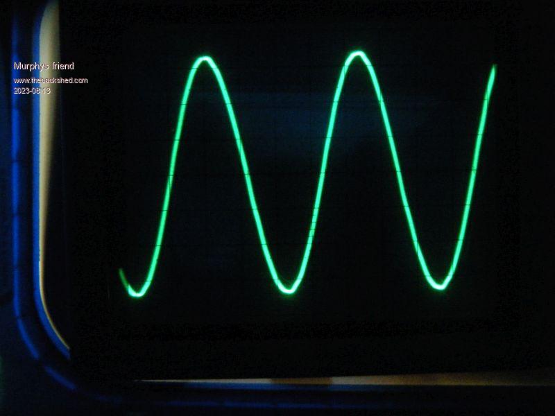

Here is a picture of the idle sine trace:
Once the inverter was powering my house with the reverse cycle A/C running, fridge loads, bar heaters & kettle, totaling close to 5KW there was no obvious change in the sine trace.
Running the induction cooktop (1800W) or the microwave (1000W) a small trace change:
So, what caused the idle power increase? Most likely myself . I cannot resist tinkering with this thing and every time I see a post with a 'good' idea I have to try that.

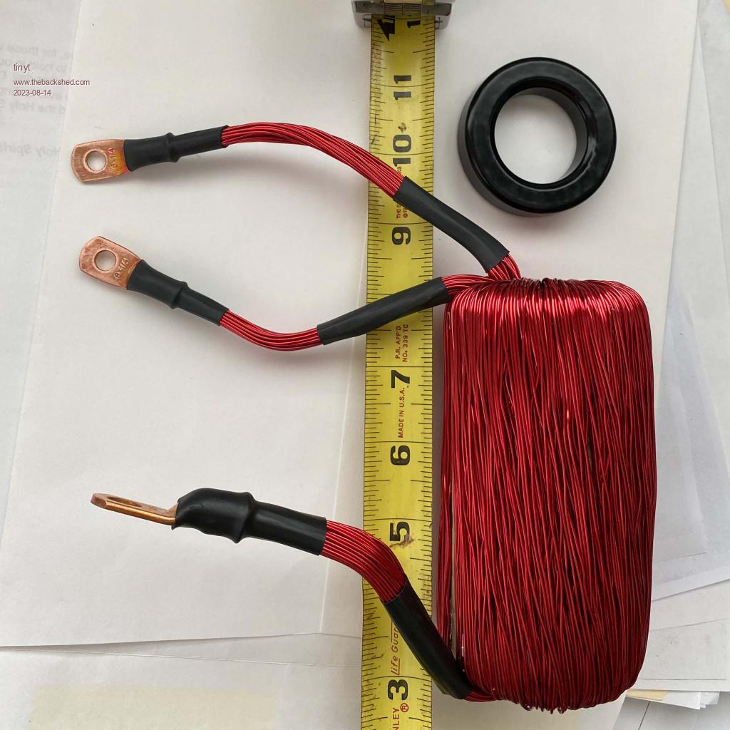

Thank you all for your input, a great team effort, solving the puzzle which put me back to a useful inverter.
I used chinese advertised 'ferro-silicon aluminum toroid' which is probably similar to what you used. Also 8 rings, 9 turns 70 strands AWG #19 (0.653 mm2 cross section x 70 = 45.7 mm2 equiv. cross section). According to a data sheet, AWG #19 max frequency for 100% skin depth is 21kHz.

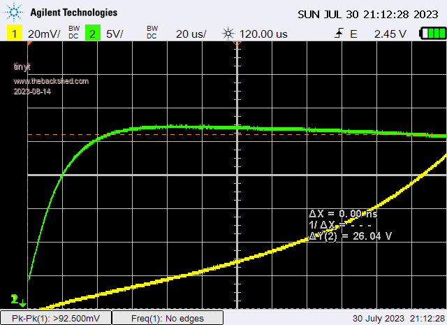

Here is saturation curve:
The 'scope I used for saturation testing can save the readings as spreadsheet data.
Using it, the following are calculated average inductances at various current ranges:
20A - 80A: 45 uH
80A - 120A: 40 uH
120A - 160A: 35 uH
160A - 200A: 30 uH
200A - 240A: 27 uH
I only used one choke at the 23KHz mosfet bridge leg, none at the 60Hz mosfet bridge leg.

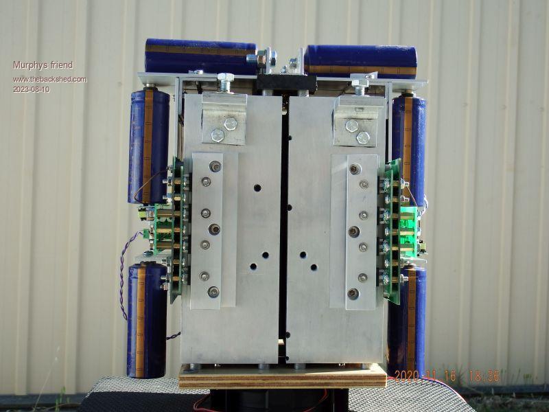

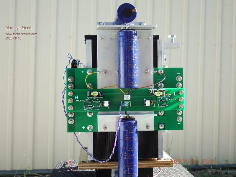

Mike, have another look at the way I have the mosfets mounted (picture on page 1). You'll see they are on little carrier boards, 4 mosfets per board.
If there 'is' a blowup I just replace the whole carrier board & new parts on it, no thru hole problems then.

tinyt, I applaud your patience with paralleling 70 strands of fine wire to make suitable cross section.
The re cycled toroid rings I used did have an original winding of that style but nowhere near 70 strands, just 4 thicker wires I remember.
I think your method would be the preferred one but mine is quicker .
Could you tell me the formulae you used to get the inductance from the data points you quoted? Its been too long since I had a need for that calculation and have forgotten how.

  Murphy's friend said  tinyt, I applaud your patience with paralleling 70 strands of fine wire to make suitable cross section.
I tried using ready made chinese toroid chokes but decided I can not avoid making my own to meet my desired inductance. The rings were harvested from these chokes which measured low inductance during saturation testing even with 3 in series.
Attached zip file has the spreadsheets in .ods and xlsx formats. First few readings are not useable because of 'noise'. Look at the column headings and formulas in cells column I, rows: 314,612,826,982,1098,1190 then work back. I hope they are correct. (ignore content of cells columns J-L, rows 7-28).

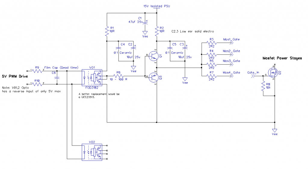

Looking at your driver module and you may have done this already, I would remove the two 1R resistors driving each set of mosfets, plus provide some current spike isolation for the two 15V psu's; see drawing below.
Note C2,3 should be very low esr type, I use solid electrolytic caps here as their esr is in the 10s of mR.

I think it has something to do when I rebuilt these inverters to run with the NANO program, using the opto isolated drivers.
I will also try solar mike's suggestion as those driver boards are presently on my bench waiting for a capacitor swap.
