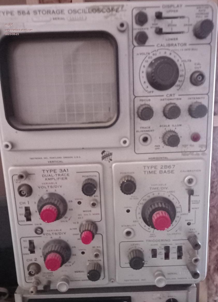

I have an old tektronix 564 storage oscilloscope, and the timebase plugin has stopped oscillating. This is the description of the fault -sorry if it's a bit long winded:-
last time it was working, it wasn't triggering on 'auto' and over the course of an hour the trigger level kept having to be turned up until it reached the end of its travel and wouldn't trigger at all, nor run on 'free run'. No amount of fiddling with the controls now will get it to sweep.
If set to ext X input the dot appears, the horizontal position knob works as expected and is not far off midposition to center the dot, and a signal on the x input deflects the dot as expected, but switch back to time/div and the dot dissapears (to the left i think).
The only other clue is that the timebase has a single sweep switch, which when set to single sweep and reset would normally light the 'ready' indicator ' this dors not light up.
Usually when this scope goes belly up it's either a resistor or a 'blown'(air got in) valve, but i think I've tested every resistor, the power supply rails to the plugin (-100, -12.2, 125 and 300v regulated - i don't think this plugin uses the unregulated supplies), and all the valves are glowing so the 6.3v is there.

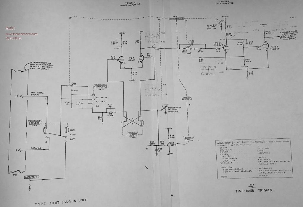

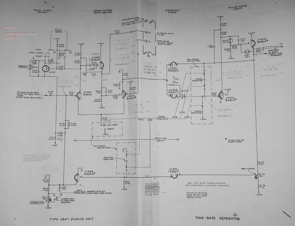

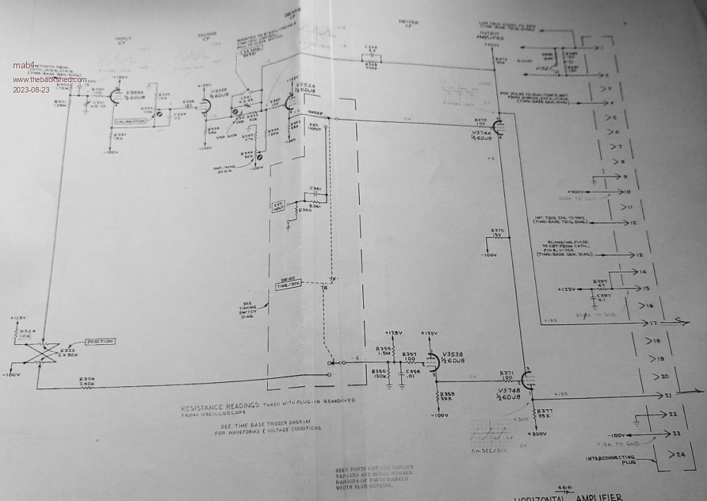

Sorry that wasn't a very good pic.
Here are 3 schematics
Output amp - I'm thinking this oart is working normally:
Trigger:
Timebase:
Hopefully i haven't made them unreadable  by downsizing.
I'm thinking that the trigger circuit should oscillate to drive the timebase?
But I'm not sure, hence i would appreciate any guidance on identifying the problem. Otherwise the only thing i can think of is to randomly swap valves around on the assumption one of them is faulty.

The schematic is almost difficult to read, but check first that voltage levels go to first two tubes, like -10 to +10V.
Measure the cathode of the second tube.
How it changes?
Then is the most interesting  two tubes.
They are used as an oscillator (which is not working).
Look that the DC level goes to first of the second tubes.
Then measure the anode voltage from the second tube.
How much is it?
And then use external capacitor, the same size than it should be and touch the old capacitor to the both ends.
It should start to oscillate.
If not, measure the backup capacitor and the parallel resistor.
This is my first advice .
Regards Pekka Ritamaki Finland.

Just to be clear:- by the first two valves do you mean V24 A and B (trigger amp)? And 2nd two V45 A and B (trigger multivibrator)?

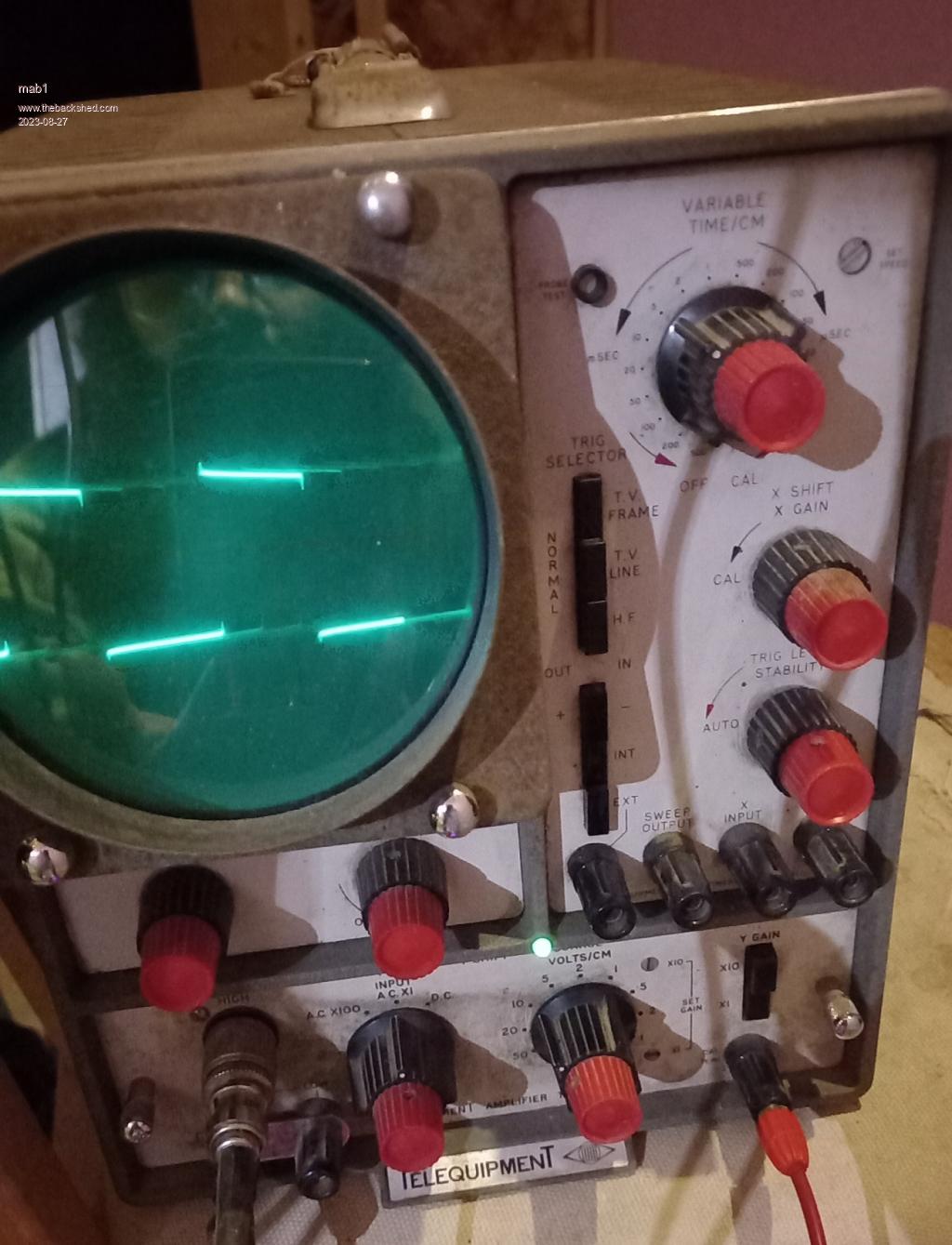

Not a silly question at all - but i have used contact cleaner on the switches, including the time/div switch.
I do have another (working) cro - telequipment s43, but the issue is getting access to the valve contacts of the timebase when the timebase plug-in is in the chassis - hence my wondering if i could plug it in on the other (y amp) side. Well, that and my limited understanding of how it works. :)

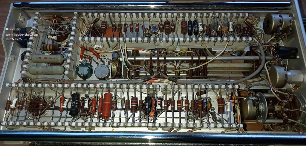

If it was a valve issue, I would expect the problem to ease as everything warmed up. However you say the longer the scope is on, the more you have to adjust the trigger control until you run out of adjustment. The symptom is typical of resistor drift due to heat. I would start with any of the older brown, rounded end resistors. These are a sponge with moisture. A picture of the component side of the module would be handy. Also, any of the old yellow wax capacitors (if fitted) would be the first things to replace. But a picture of the component side would help.
Pete'.
mab1
Joined: 10/02/2015
Posts: 286
Posted: 06:49pm 24 Aug 2023
Hi pete L,
Just to clarify: the time i had to keep adjusting the level only happened once. Before that it was working normally iirc, and since then it hasn't worked at all, warm or cold.

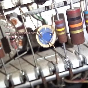

C37 22pF: my substitute is the small brown ceramic disk, approx centre on the lower tagstrip. The original is the cylindrical one alongside - it looks like it's still connected but thats just the pic.

Pete Locke
Joined: 26/06/2013
Posts: 186
Posted: 05:32am 25 Aug 2023
There's nothing in the picture that screams "Change Me". Someones been in there before looking at the newer style resistors. The tubular ceramic cap's are normally very reliable. At least now you have access for voltage checking. A quick run around the tube pins should lead you in the right direction. Good luck   .

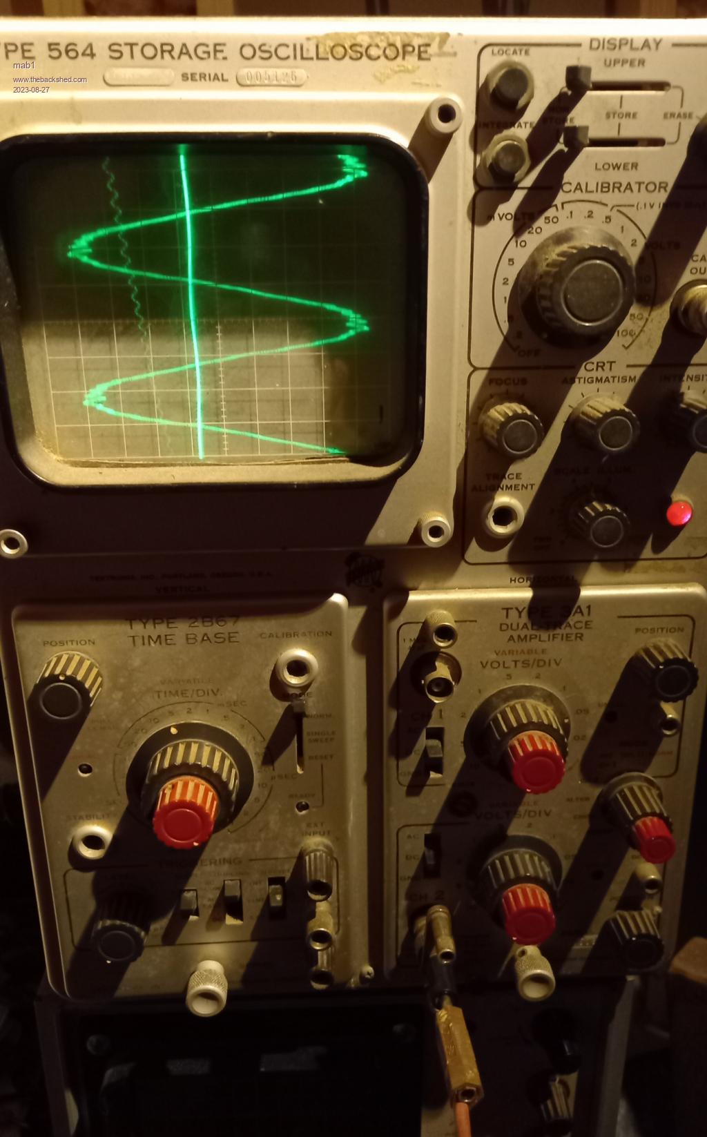

It's a GOAL!
Started testing static voltages, but the voltages i was seeing seemed reasonable and i didn't seem to be getting anywhere. So in the end i fired up the other valve scope and followed a trigger input signal until it stopped.
I do have a cheap Chinese pocket scope but it's only rated for 50vpp input.
The culprit: Q124 2N2043, the only transistor in the timebase, in the single sweep circuit. It seemed to check out with a diode test in circuit, but maybe i got b,c and e mixed up - i thought it was ok, but removing it from the circuit has got the timebase working.
Thanks for the contributions everyone,  got there in the end. Although i still don't understand valve circuits really
