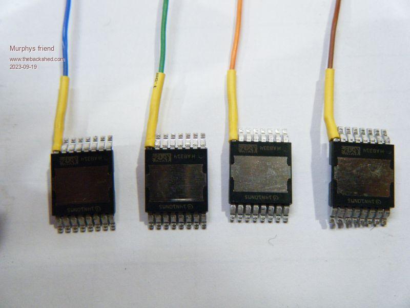

This idea came to me after using IPTC14N0NM5 mosfets for my one shot inductor saturation tester. These mosfets have an incredible low Rds on of 1.4mOhm max, beside 100V & 365A ratings.
The following is based on a heatsink measuring 100 x 100mm with 6mm fins (ex. Aerosharp).

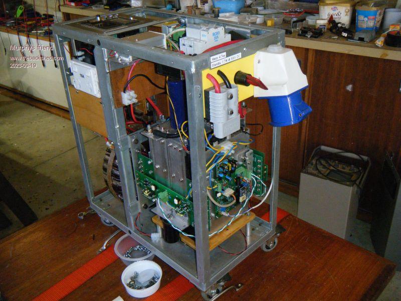

I used my 3KW inverter as a testbed, here is what it looked original:

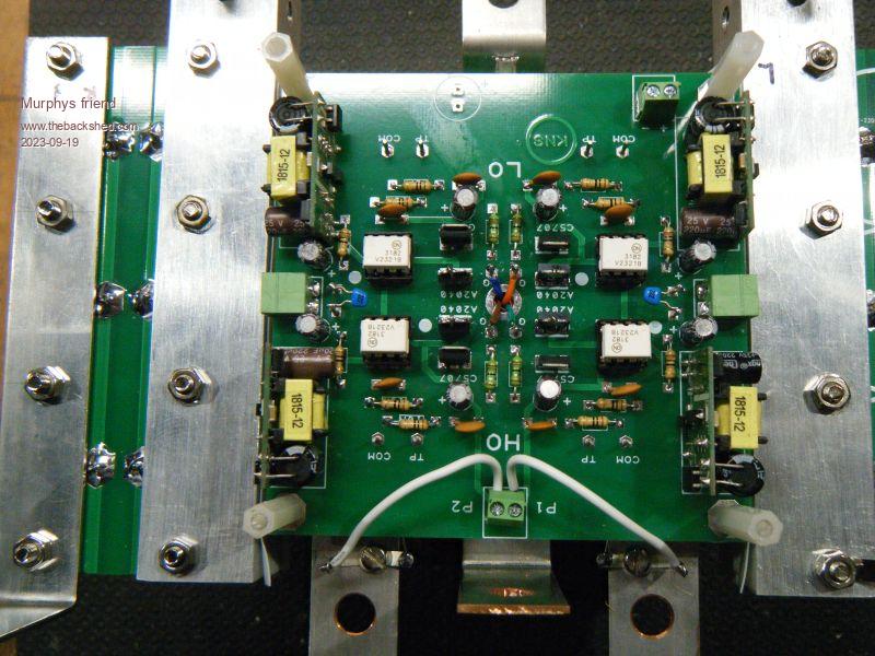

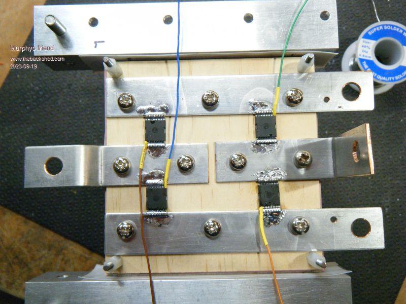

These mosfets have all drain pins on one side and the source plus gate on the other:
They were soldered upside down between 16 gauge copper strips:
On top of that fits the driver board:
Followed by the control board:

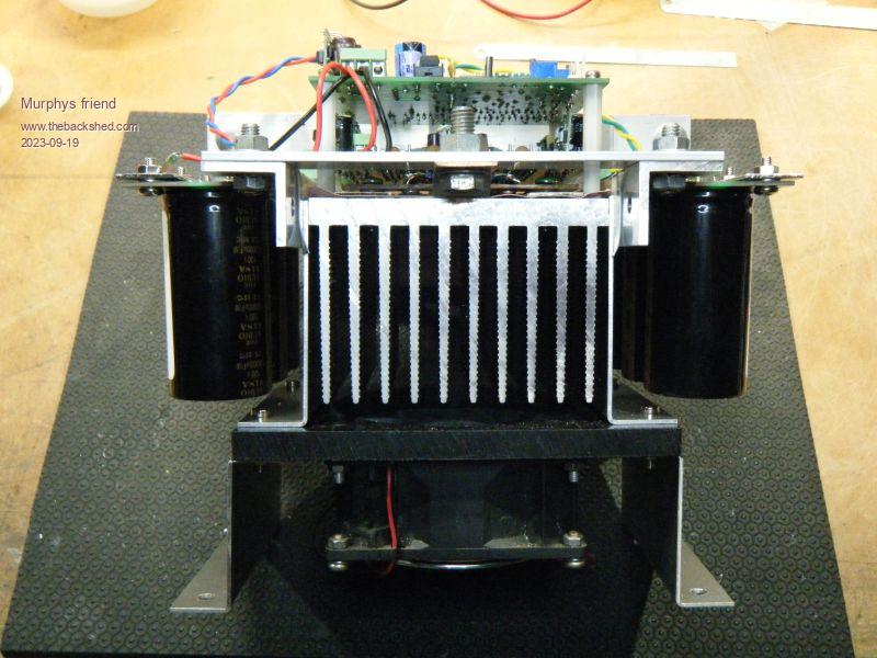

A side view of the power block:
All boards are 100 x 100mm BTW.
Ready for testing:

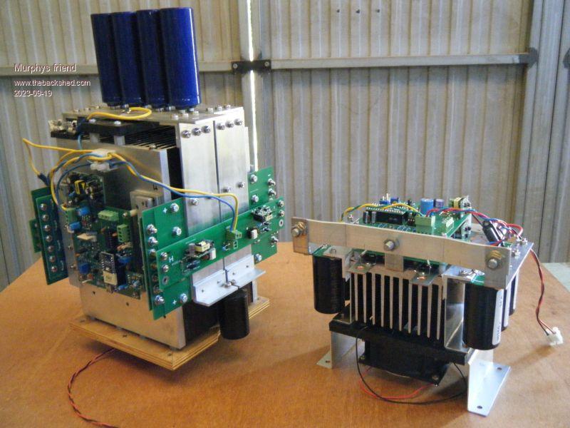

Comparing old and new size difference:
Lots of space in my inverter now:

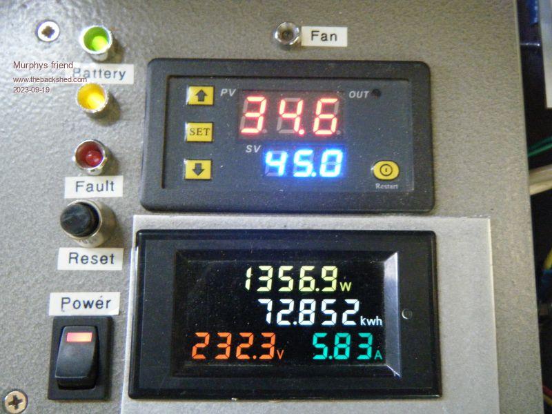

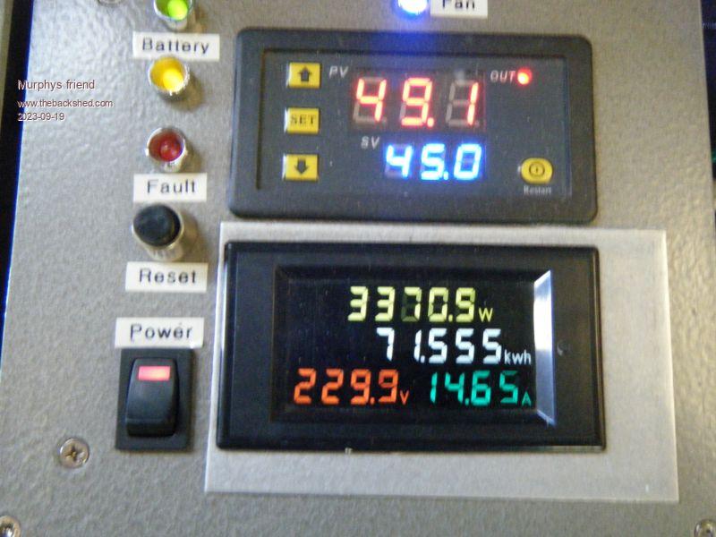

Now for some testing. I first tried powering it flat out, keeping in mind the inverter has a 3KW toroid transformer.
It handles that power easily:
Ambient temperature was 21 degrees C, the 90mm fan came on after about 10 min (at 50 deg. heat sink) and easily cooled the heatsink down to 45 degree from where it cycled then.
After 2 cycles I reduced power to:
A which the heatsink kept cooling, the temp. shown above is after one hour running. By this time the sun got too low to continue testing without draining my battery bank.
So, for my normal power use this small heat sink would be adequate, it appears. Summertime testing will confirm this.
Those 4 mosfets should easily handle a 6KW load with a heatsink perhaps twice as big. That's still a lot smaller than my 6KW inverter uses now.

Mike, you can buy 4 of these mosfets for just over $50.- which gets you in the free delivery range from Element 14. I bought mine there in a lot of 4.
I think it would be difficult to solder these tiny (10mm sq) devices to tubing without shorting the gate pin.
What I'm doing for the next one is to use a 2oz PCB with square cutouts for the 4 mosfets. 1.6mm PCB is just the right thickness for the top (heat conducting) face of the mosfet to touch the heat sink insulator below if its soldered facing through the cutout. I'll bolt 15 x 2mm copper strips on top to cater for the current, this also helps with heat transfer.
If you wanted water cooling you could run small tubes through the heat sink but I think fan cooling is quite sufficient for continuous high power. At 100A the mosfet has just 14 Watts heat loss (ideal conditions).

Those teeny weeny mosfets I could not destroy when two of these in parallel got over 700 peak Amps dumped through in my choke saturation tester. No heat sink on them either.
So I thought they could be used for the power stage of an inverter with a relatively small heatsink.

Small question, I can't find the source wires, how did you connect those? If you run twisted wires from the driverboard straight to the mosfets you might improve the robustness even more.
Murphy's friend
Joined: 04/10/2019
Posts: 678
Posted: 08:28am 28 Sep 2023
Thanks, the source wires are the two white ones going to terminals labeled P1 & P2.

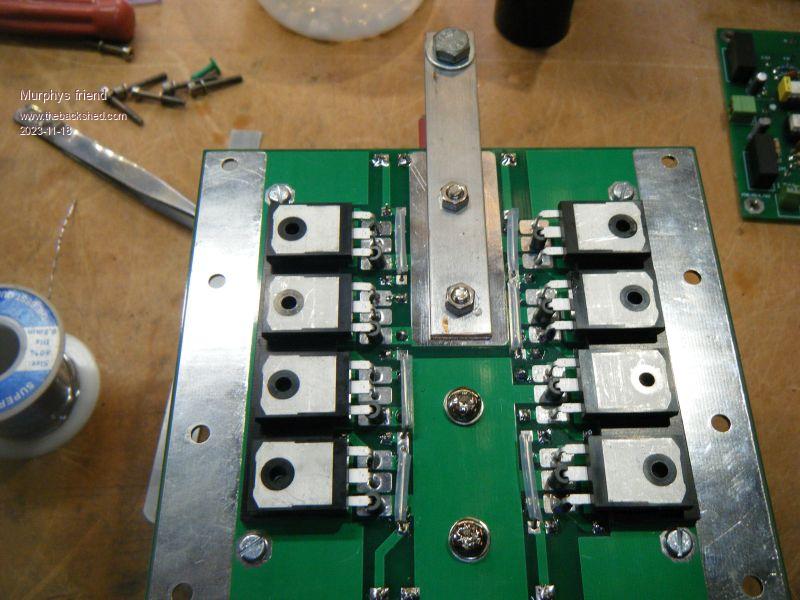

I borrowed a page out of Wiseguy's book and replaced those tiny SMD mosfets with (physically much more manageable) HY5608's.
8 of them were used for the full bridge. This is still for my new 24V caravan inverter.

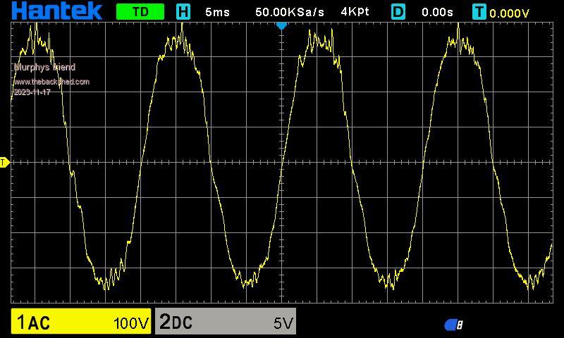

I have 9 odd flood lights I use for a load, they total 1100W.
If I set the no load AC voltage to 230V it will increase a bit each time more load is added, so by the 1100W load point the AC measures 246 V.
Why is this so, I have no idea.

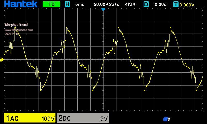

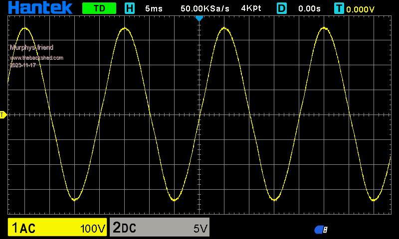

The inverter runs the EG8010 chip with its standard rectified AC (230 > 12V) reduced to 3 V for the VFB sampling input.

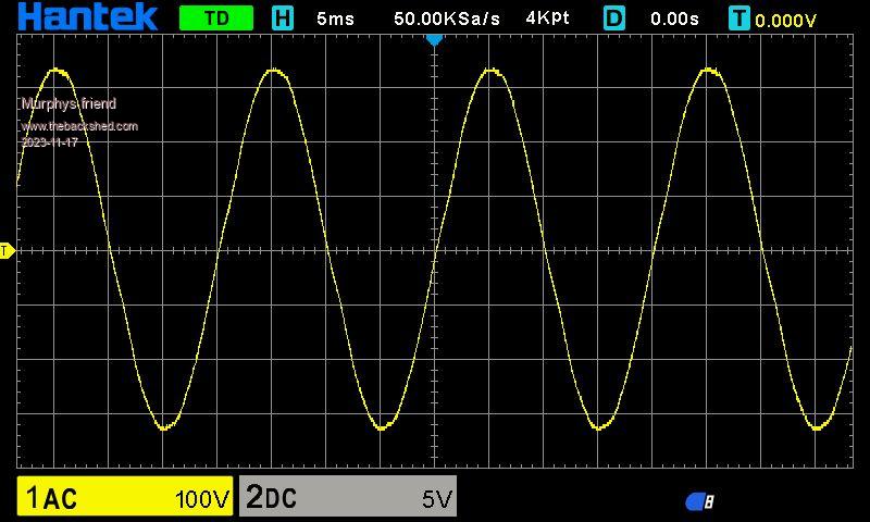

The AC waveforms are good, this is what 150W load looks like:

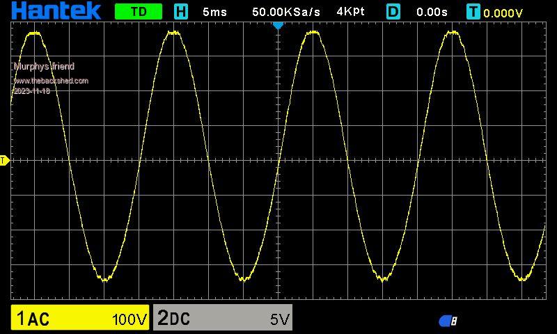

And this trace at 1100W load:

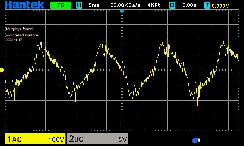

I then subjected this inverter to my chop saw test, this is rather severe for such a small transformer but everything survived the test multiple times.
The start up wave form looks horrible but it *did* start up every time :
Once it was up to speed (but not cutting anything) I got this wave form:
I'm looking forward to your comments and will continue later to post some pictures of my new (downsized) caravan inverter.

Can you check the 12V out of the little transformer, to see if there is any deviation in voltage? might be hard to see, or its something else.
Cheers Aaron
Off The Grid
Murphy's friend
Joined: 04/10/2019
Posts: 678
Posted: 10:10am 17 Nov 2023
Thanks Aaron. When the main AC voltage goes up then, naturally, the little sensing transformer primary voltage also goes up. This then proportionally will change the secondary (sensing) voltage.
What there appears to be is some positive feedback but I cannot imagine how.
The strange thing is when I ran the chop saw the AC voltage did not increase, at least I did not notice any.
I might try to cut some steel and see if the inverter voltage regulation works better with an inductive load.
Its not something I will panic about, just being curious. Big loads in the van will be short microwave loads and the occasional A/C startup & run.

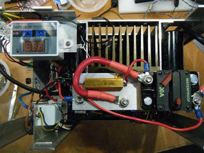

I placed this inverter in my caravan and had it power the Aircon. AC voltage increased from 230V to 240V with the compressor running but, as you say, it goes back to 230 with just the A/C fan running. That's good enough for me.
I just love this LF inverter, this little 1KW unit will start & run the caravan A/c while the 2KW HF inverter will not start it .

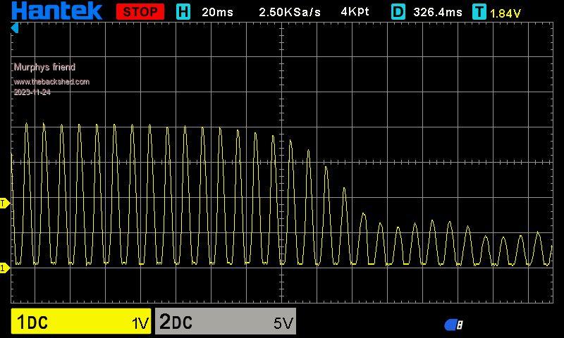

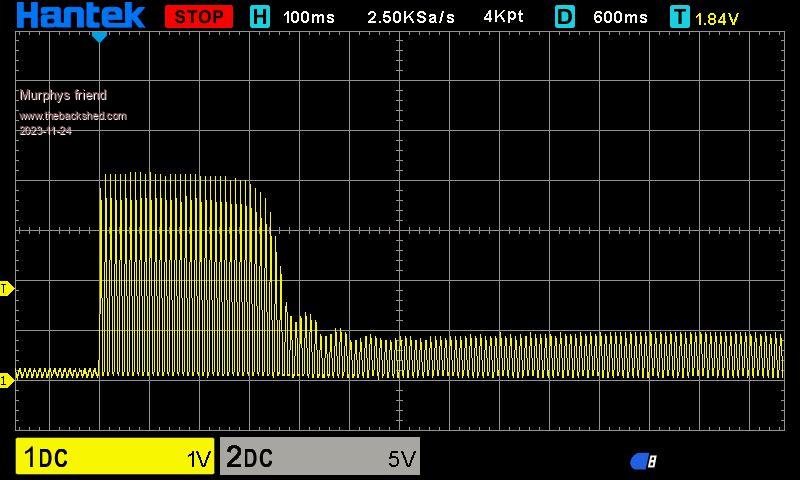

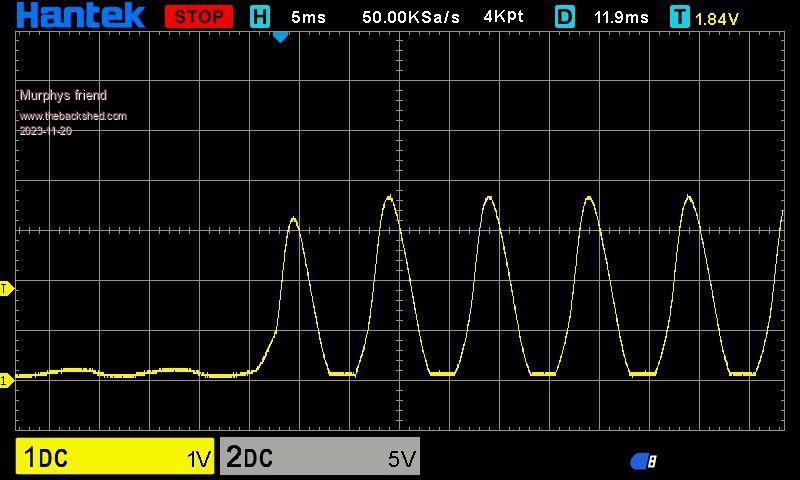

Here is what my caravan aircon does to the inverter output.
First the startup wave form:
And when its running:
Murphy's friend

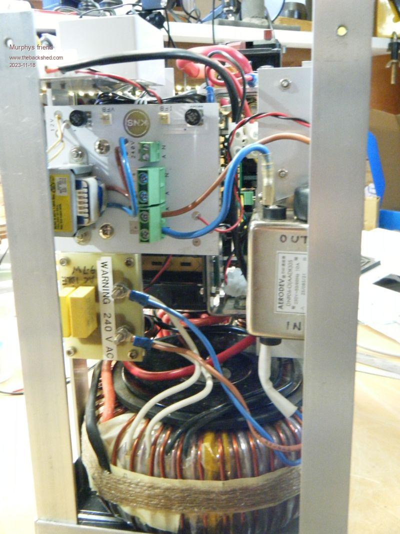

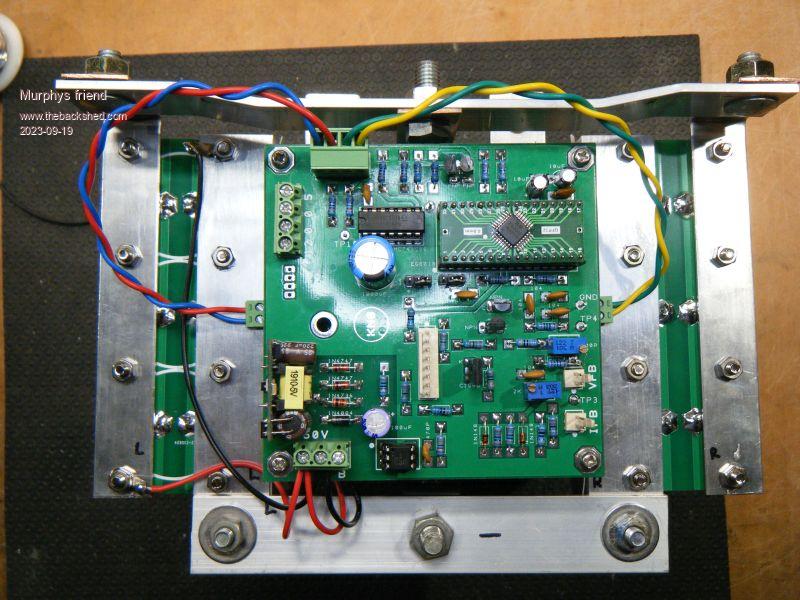

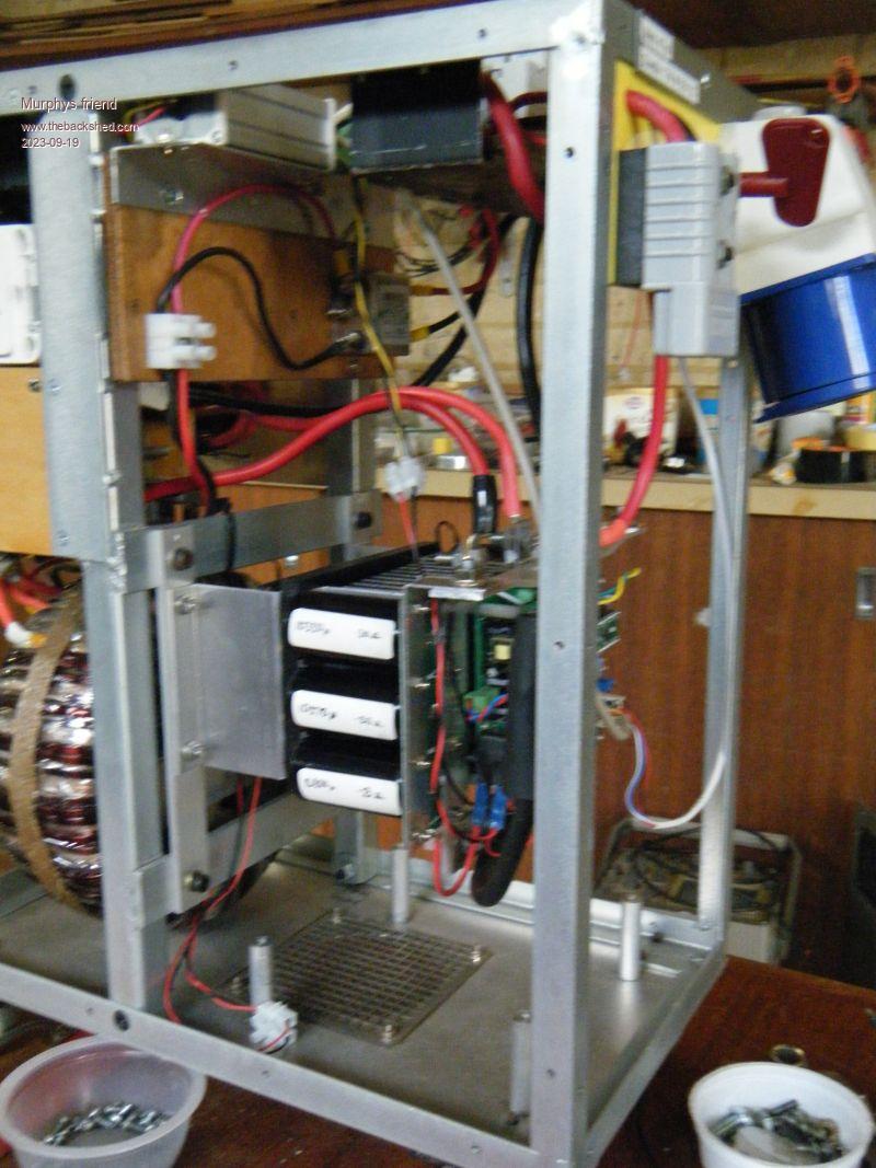

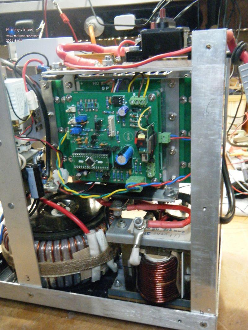

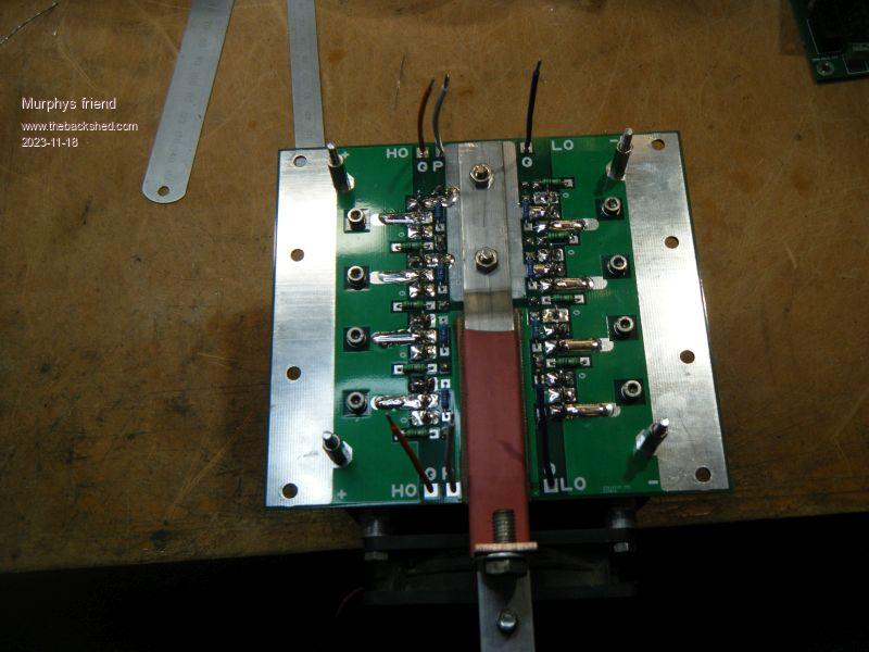

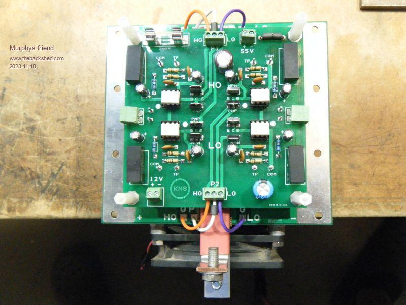

Now a few pictures, I have completely re built what is shown at the beginning of this thread. The idea was to have a smaller, lighter LF inverter for my van. The one I built some time ago works fine but due to its size and weight it was very difficult to insert/ extract from its tunnel boot home.
This is the power board underside, showing the 8 mosfets with ferrite beads on each leg that connects to the primary:
The top side of the power board:
And the driver board piggy back on top:
Then the control board piggy back on the lot:

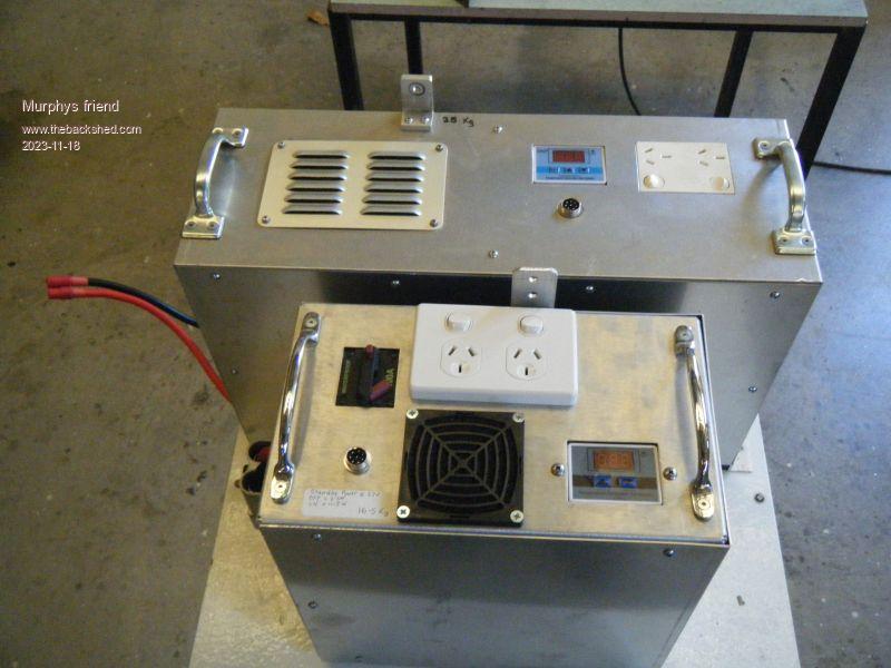

Now a few pics of the build:
And the size difference of the old inverter behind the new inverter. The weight difference is 25kg reduced to 16.5kg:

  Murphy's friend said  Here is what my caravan aircon does to the inverter output.
Not pretty but impressive for a 1kW inverter.  Any idea what the aircon startup surge is?
